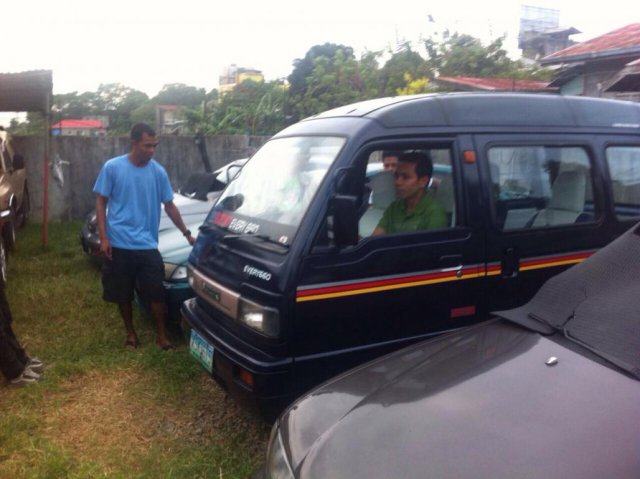

The Suzuki is in a Suzuki.
I have an LHD Converted 1990 Suzuki Every 660Turbo (nee Daewoo Damas now I suppose)
I have to up the boost a bit to break the tires free to do the brodies... though the Speed Sensor MAY be on a pulser wheel inside the front differential (it's Pushbutton 4WD)
I will NOT be boiling all four tires...not with this engine! No matter what boost I'm running.
Now, taking a Sunny Pulsar GTi-R driveline and bolting it underneath... Heeeeeey.... We're on to something there!
