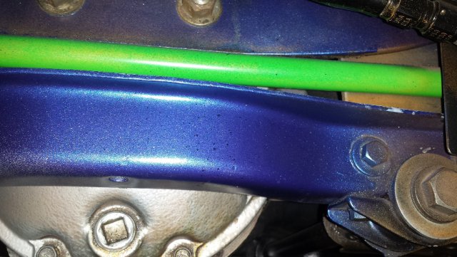

Do you have a picture of it mounted in your car?  Are you running an R200 or R180 diff?  Looks like it wouldn't work in my car with the R200 in my car, at least with the R200 LSD with finned aluminum cover, as you need to run the mustache bar behind the drop-downs, making it not possible to mount that way.  Would be nice to find a solution to run the rear mounted ST 240Z rear sway bar with this setup, but it doesn't look like it will be easy.
280Z with R200, no issues. The kit comes with new drop links that have the ears for the sway bar brackets. Not sure the finned cover could pose an issue, I think the bar sits high enough it should be alright, but I can't say for sure. I don't have pics of mine, but here's one JohnC posted in this thread that you should find helpful.

I have the same setup (240z ST kit, R200 3.70 LSD differential) and did not have any issues.  I do not have a finned cover so I could use the stock brace.  There are no issues with clearance.  The sway bar should clear the finned cover as it tucks up right under the mustache bar but you'll need a new brace.
Damn 13 mp camera on my phone shows shit I can't see looking at it!

I have no problem with CV axle clearance on my setup.  When I jack the car up I have around 1 mm of clearance.  I did shorten the end link slightly for clearance at full droop (when jacked up).

I don't see any fitment problems overall, just having to modify/fab a cross brace for the finned cover since the one I have won't work.  I appreciate the pics.

Beautiful car ktm-Id rather seen 100 under car shots than a single shiny paint job.  1mm was too close for me to risk.  I could get it to fit, but not within my comfort level.  The Wolf Creek cvs are a little smaller than the Z31 CVs in the area where I was close.
