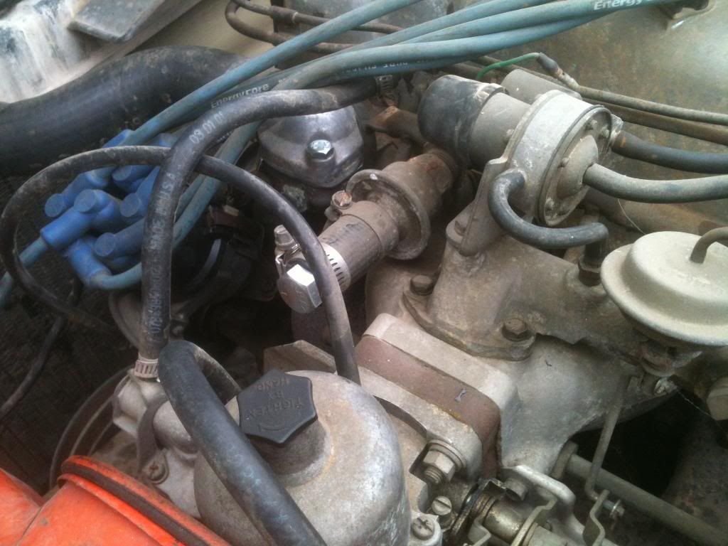

Low oil in the carbs can cause a lean condition when opening the throttle that goes away once at a steady speed/ To check the oil in the carb remove the black know at the top of each carb and pull out the damper rod. There are two (somewhat faint) lines. Add oil to get the oil level between the lines. There is a never-ending debate about what type of oil to use. For now use whatever motor oil you have handy. I get good results with 10W30. The damper only holds a tiny amount of oil so add carefully. Use a syringe or eye-dropper if you have one.
3 in 1 is straight 20wt oil and is what a lot of people use.
The line with the bolt in it is the overflow line. It shouldn't be blocked, it should be routed back to the air cleaner if memory serves. You probably don't want it to route to the air cleaner right now with your fire out of the carbs problem, but it shouldn't be blocked like that.
Have you checked the timing? What is it at?
Thanks alot for the tips, guys. I took some oil out of another two sets of SU carbs that came with the car and filled up the carbs that are in the car now. Oh, and timing was at 0 BTDC, now its at 3 BTDC. Problem is completely gone. I can punch it from a crawl no problem now. Thanks again.
The line with the bolt in it ISN"T the overflow line...it's ported vacuum. Usually used for distributor vacuum advance, but only if the distributor is set up for it! some distributors use it, others do  not.
Are you sure that's a vac advance line? Because my vac advance is already hooked up to the intake manifold...
The vacuum advance hose is the one that is plugged. Someone has incorrectly connected the dizzy advance to the intake manifold vacuum. This vacuum source does not give you the correct vacuum signal your dizzy needs, it must be attached to the line at the carb (ported vacuum) for it work as intended.
Set your timing with the dizzy hose removed (and plugged, engine side), you have quite high manifold vacuum at idle with your hose connected like it is, and it is advancing your timing too much.
Your float vent lines are connected correctly to the air cleaner.
