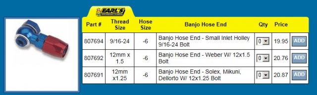

There are banjo fittings for Mikuni and Weber that are 12x1.25 and 12x1.5 respectively that may work for you. They use a pair of crush washers to seal. Look for Earls or equivalent at your local speed shop.
You can also get -6 and -8 male banjo's and then a matching bolt.
look here for a guide http://www.anplumbing.com/Adapters/Banjos+%26+Bolts-26.html
The Z SU's also use a 12x1.25 banjo like fittings but they end in a tube for a hose.

Thank s Calgary -    This pump outlet fitting is configured  M12-P1 male stud  - like a  "bolt"  with the discharge in the center. I would like to use banjo style connection - I need to adapt from male to female threads...  I can't find any fittings with M12 fine P1 pitch threads.    It is so strange that they would provide pump w/ Ba$%#d connection size   : ]     I've tried hydraulic - diesel - auto  supply houses,     Might be time for gear clamps....
