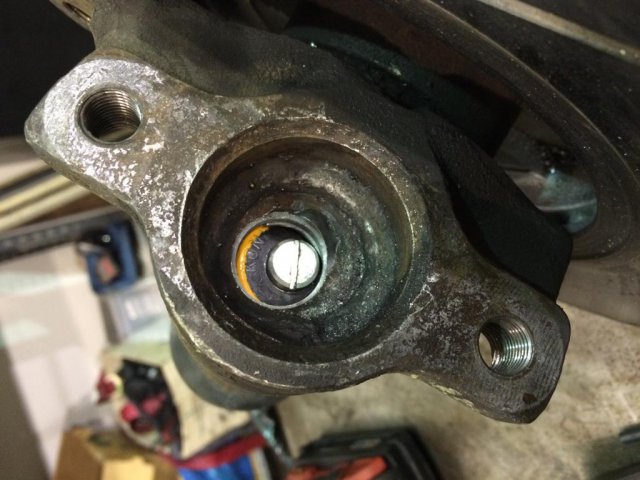

Old Illuminas were tight in the housing. Had to run a flap wheel inside the tube for a while to make room for new shocks.
Hole a bit off center..
Edited by duragg

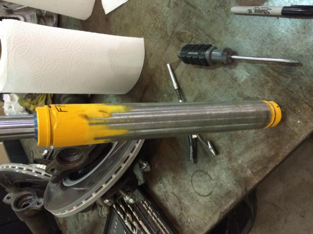

I went back and made it bigger but that strut had a huge weld blob on the bottom.  The adjuster fits clear and spins freely now.
Having the Gland nut ID turned down to just accept the top of the KONIs so they will be self centered.
Cutting a spacer for the back shocks once that is done to fix height.
Then button 'er back up.
