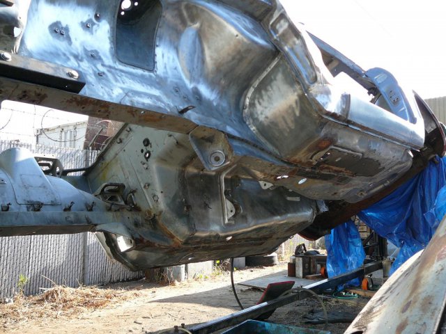

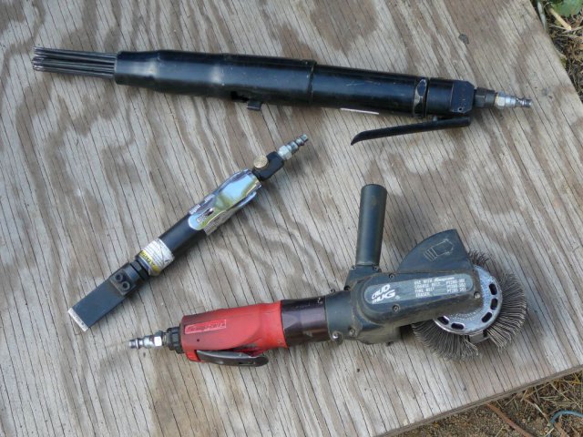

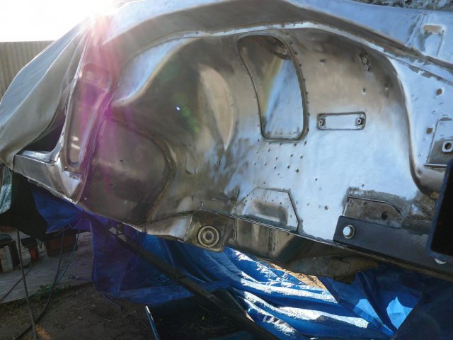

After first trying the oven cleaner method only end up with gooey, caustic sludge, I changed gears and picked up a barely used Snap on "crud thug" from ebay, as well as a cheap needle scaler and pneumatic chisel set from Harbor freight, and last but not least finished off with my Makita electric drill with 3m round scotchbrite wheel . The first needle gun only lasted a few hours and was replaced with another that is still going strong. The chisel set, with multiple shaped and sized ends ended up stripping out from it's oh so nice quality, and now only has one head option. The China freight tools were purchased with the complete understanding that they would most likely be disposable tools. The Crud Thug is a workhorse of a wire wheel tool, unlike the cheap wire wheels you can buy from Home Depot that end up breaking and sending little wire shards back at you at high velocity.
