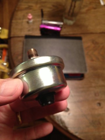

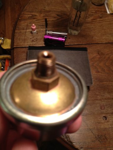

My sender is leaking at the crimp between the outer sheet metal housing and the inner sheet metal housing.  My question is this: should I try to clean it and apply epoxy to it, or try to get a radiator shop to fill the gap between the two pieces of sheetmetal with solder?
My original sender leaked at the same place, and so I bought a new sender-and it leaks too!  Its not a big leak, but its the only leak I have, so I want it gone.  I'd love to get your suggestions.

I'd take the new one back and have them exchange it. I've never had the Datsun ones leak. That's interesting that the new one dose too. I believe I have a few stock ones layen around. I'd give you one after I verify it works. If it gets to that.

djwarner was right-the soldering killed the sender.  After soldering,  I could hear a rattle inside the sender, but I installed it anyway:  it did read oil pressure...sometimes.  So, with Tony D's help, I went looking for Datsun Roadster Senders.  Very hard to find.  Found a used one that looked pretty good for $38 plus shipping.  Found 2 units for $120 and $140, but the ebay stores for those guys were inop.  So, I bought the used sender and mixed up some JB weld and applied it to the crimp fitting, the base of the hex portion of the stem and I even JB welded it externally (so maybe I can get it apart later) where the adapter screws on.  The problem with the BSP to NPT thread adapter is that it isn't labeled in order to know if the adapter is BSP to NPT, or if it adapts BSP to NPT, in other words I don't know if the male end is BSP or NPT, nor do I know which the female end is-the facts are somewhat hidden by the English language.  So, I'm using JB weld to make up the difference between 27 threads per inch and 28 threads per inch (which I sure as hell can't count accurately on a stem that is of unknown length less than 1".  If no posts are added, you can assume that it worked and I'm not dripping on the track anymore.
