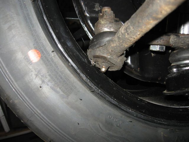

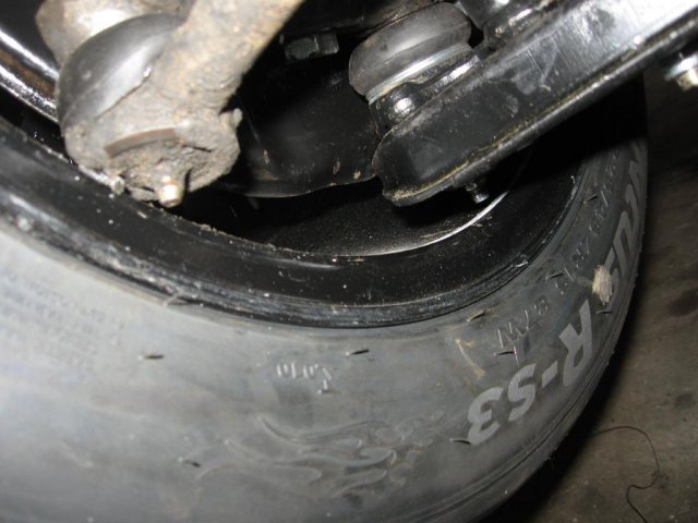

What would you suggest the best solution to be if the tie rod end is rubbing on the inner part of the front wheels? I am assuming this is because I installed roll center spacers...? I have 15x8 ...0 offset.
Thanks for the pic. So, you have both a lateral and a diameter problem. I THINK you'd be golden with the shortened knuckles....I guess you've tried grabbing the tie rod end and twisting it a few degrees to make the zerk point straight down? When I ran 15s, I ground a little off my tie rod ends to get that last few mm of clearance. I will probably be doing shortened knuckles and electric steering assist in 2015 if I can get all the parts I have horded up installed over the winter.
I wonder what would happen if you took
off the knuckles, put them in a vice, heated them red hot with a torch and bent them in a bit....I know we all fear heat stresses, but that's how a hot rodder in the 50s would likely handle this. You would need to have the requisite remaining adjustment threads available on your inner tie rods to absorb the shortening of the system.. .
I havent tried a spacer. I hadnt really considered heating and bending the knuckle either. I may try grinding the edge of the TR end since these are going to be thrown away anyway. If grinding works then I can grind down my new TR ends. If not I am thinking QS knuckles or possibly these:
https://technotoytuning.com/nissan/240z/outer-tie-rods-datsun-240z-260z-and-280z

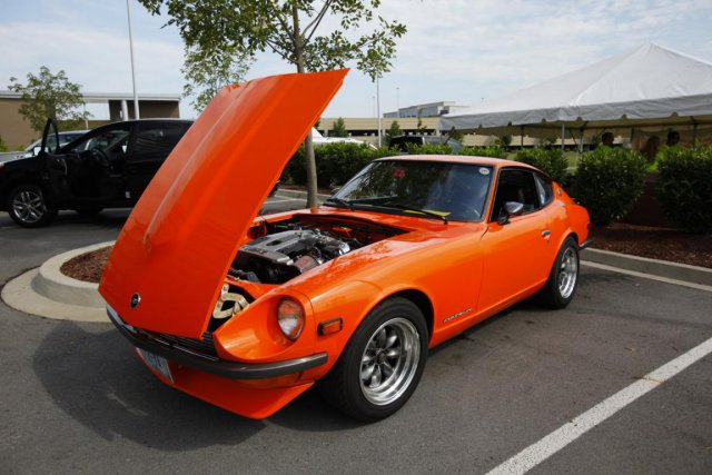

Here is what my orange car looked like with 225-50ZR15 tires on 15x8 zero offset wheels. The problem is that there are not a lot of tire choices anymore in this size. You can get DOT competition tires, and then Falken. That's about it.

When you were running this size wheel you didnt run into this issue with your TT 240 car?
No issues on the ITS 240Z with 14" wheels, but we couldn't run the steering arm spacers.  On my track 240Z with 15" wheels I did have a slight problem but I cut the spacers down about .083" and fixed it.  Not an issue when I ran 16" wheels.
Thanks John ...I'll give that a whirl.
