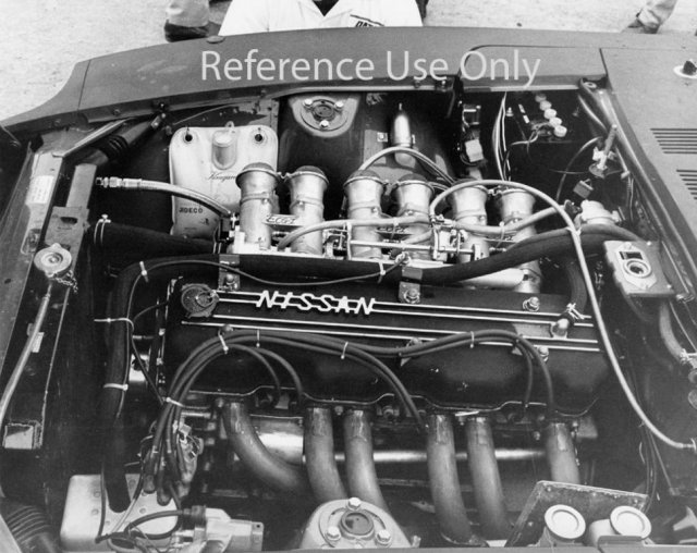

Or as Alan T has reminded us: JECS ECGI (Japan Engine Control Systems Electronic Controlled Gasoline Injection) was available in late 1971...
Attached File  LY-24-on-ECGI-pre-73-RAC-12.jpg   119.85KB   25 downloads
Nissan's ECGI was made by (HItachi-affiliated) Nissan subsidiary Diesel KiKi, and used Bosch-licensed electronics as their starting point. The throttle bodies themselves were manufactured by Denso.
JECS was formed in 1973, uniting Diesel KiKi, Unisia, Nissan and Robert Bosch Japan with Hitachi as nominated parent company.
Now back to our usual programming...

The work of the indomitable MITI... The later cars had "JECS" decals on the side, I don't know what that particular one had on it...since it said 73 I was assuming the later, even though the identification was "ECGI"...
The MAP sensor on the firewall is a dead giveaway, identical to First Generation BOSCH in the TypIII VW, and the Isuzu Bellet.
I've got half a dozen of them at home from my VW Days... Would make a nice looking period-correct 'cheater' system for those at the car shows to argue about...
