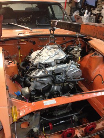

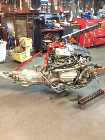

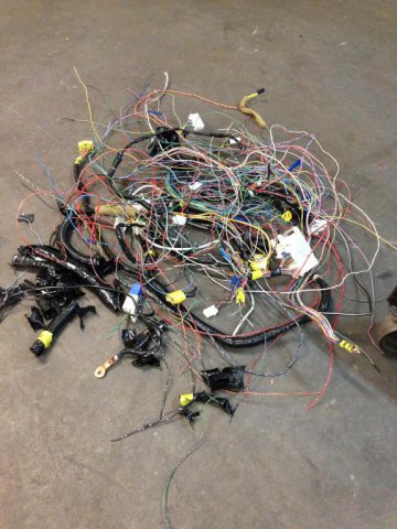

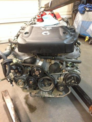

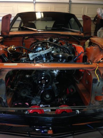

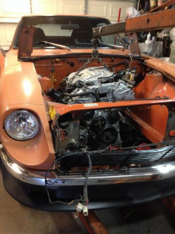

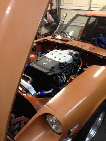

So about a year ago I picked up this low mile VQ35de for cheap. Complete motor, transmission, Ecu, BCM, Nats...etc. Well story short, within a month (maybe a week or 2 more) my father and I had it running. We didn't flash the ECU to get rid of the NATs, had to cut a inch or so off the crossmember, I'm running the stock rear end, custom driveshaft, custom trans and motor mounts, and stock brakes all around (with hawk pads in the front).Im not going to go far into depth about the swap but if anyone has questions, I would be happy to answer them. I'll try and upload current photos of the swap later tonight. Attached File  IMG_7362.jpg   62.55KB   3 downloadsAttached File  IMG_7363.jpg   78.66KB   3 downloads Goodbye little buddy, you did me well  :( Attached File  IMG_7392.jpg   60.22KB   3 downloadsAttached File  IMG_7395.jpg   64.17KB   3 downloadsAttached File  IMG_7396.jpg   75.9KB   3 downloadsAttached File  IMG_7427.jpg   57.83KB   3 downloads Removing some unwanted spaghetti, we didn't shorten the wiring or clean it up that well since that will be done when the car is painted (within a year... hopefully). Attached File  IMG_7382.jpg   88.82KB   4 downloadsAttached File  IMG_7451.jpg   55.81KB   3 downloads I'll try and upload some current engine bay pictures later tonight.

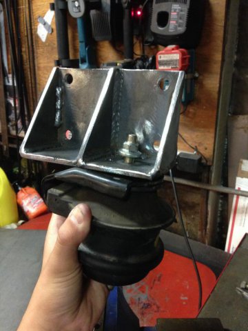

Sadly the only pictures I took of any mount was the motor to bushing mount. I failed on that part. The first motor mounts snapped from bushing to frame, I guess thick metal wasn't thick enough. Went back and we designed stronger ones, they've been holding up very well.
As for the trans mount, we modified the 350z trans mount.
