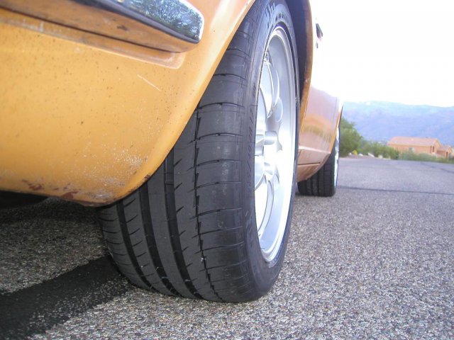

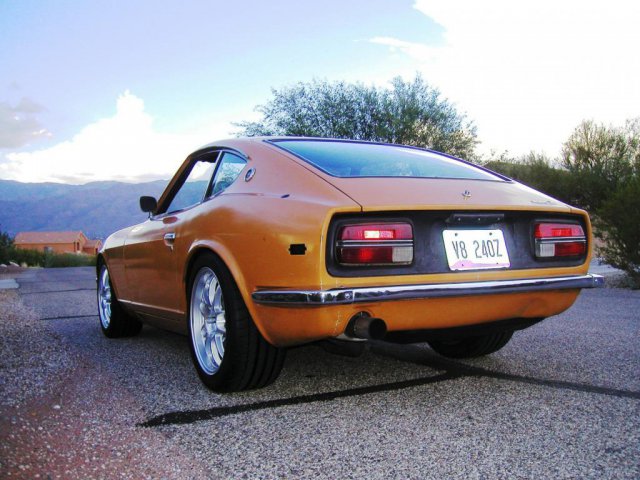

I have 245/40X17s on the front of my car and 265/40X17s on the rear with stock fender wells and no rubbing. I have coil overs, Z31 front hubs and a TTT rear setup. I didn't need to roll my fender lips either.

Yeesh every time I think I've figured out the largest size, someone one-ups it... 265 under stock fenders. Damn. What specifically do you have on the rear and how is it different, dimensionally, than the stock setup? Whats the backspace and offset on your wheels?
I'm impressed that you got that much tire under there... now I need to know if I can get away with a 265 with just coilovers on stock hubs and fenders.
