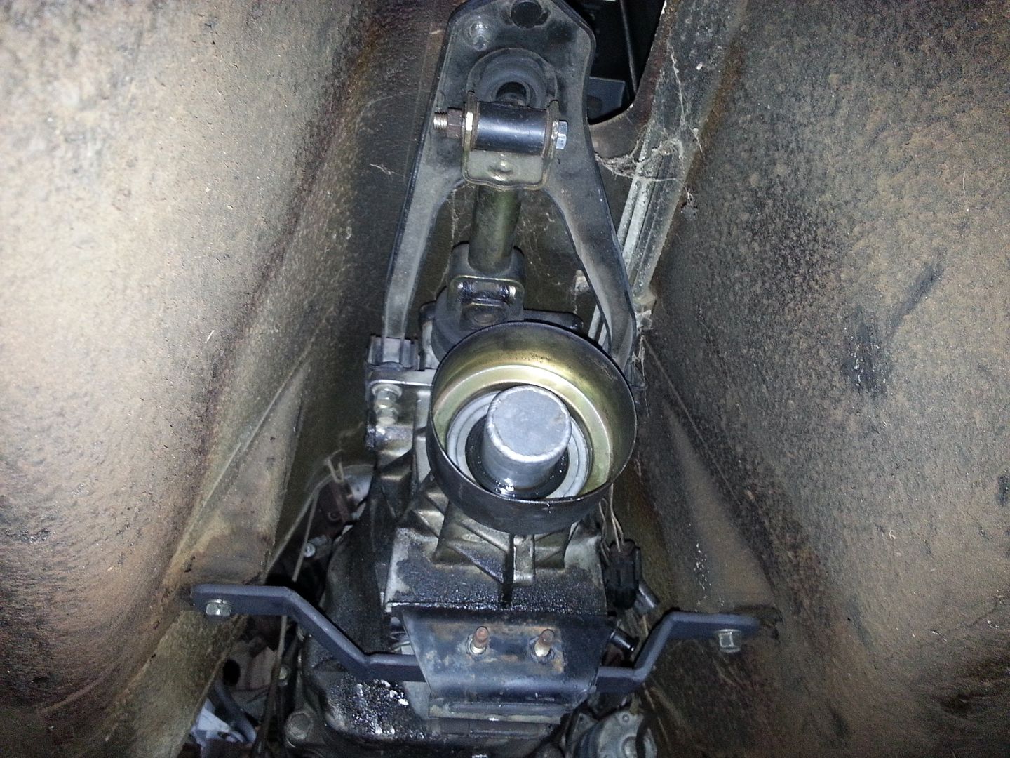

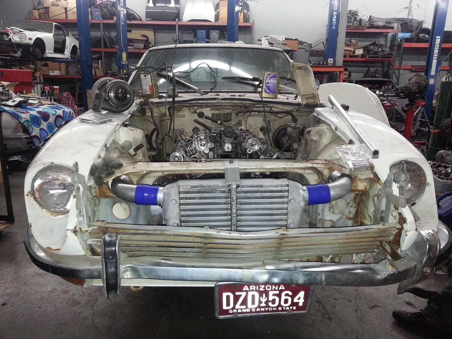

Some progress has been made. Motor motors with urethane have been made, transmission mount has been prototyped ( This along with a few other pieces will be made out of billet aluminum), shifter bracket done, OIl cooler bracket made, ic done. The turbo just got in yesterday ( Borg Warner Airwerks S200SX-51 aka s251), T4 twinscroll flange, the fuel rail stock came in as well. Next will be the exhaust manifold, then exhaust. That should be done in 2 weeks . . . talk about the rest as it is happening

My guy is back in town and was back to working on my car. Got the thurbo manifold complet, and now he is working on the fuel rail and intake manifold.

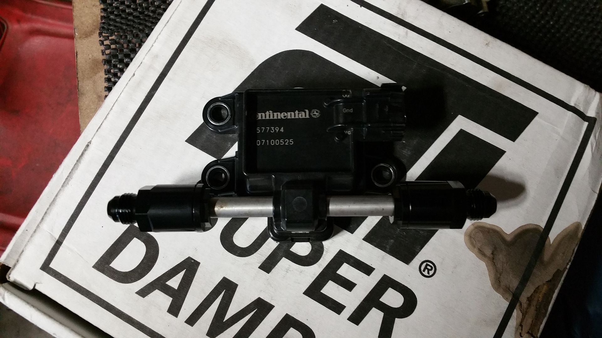

Intake manifold

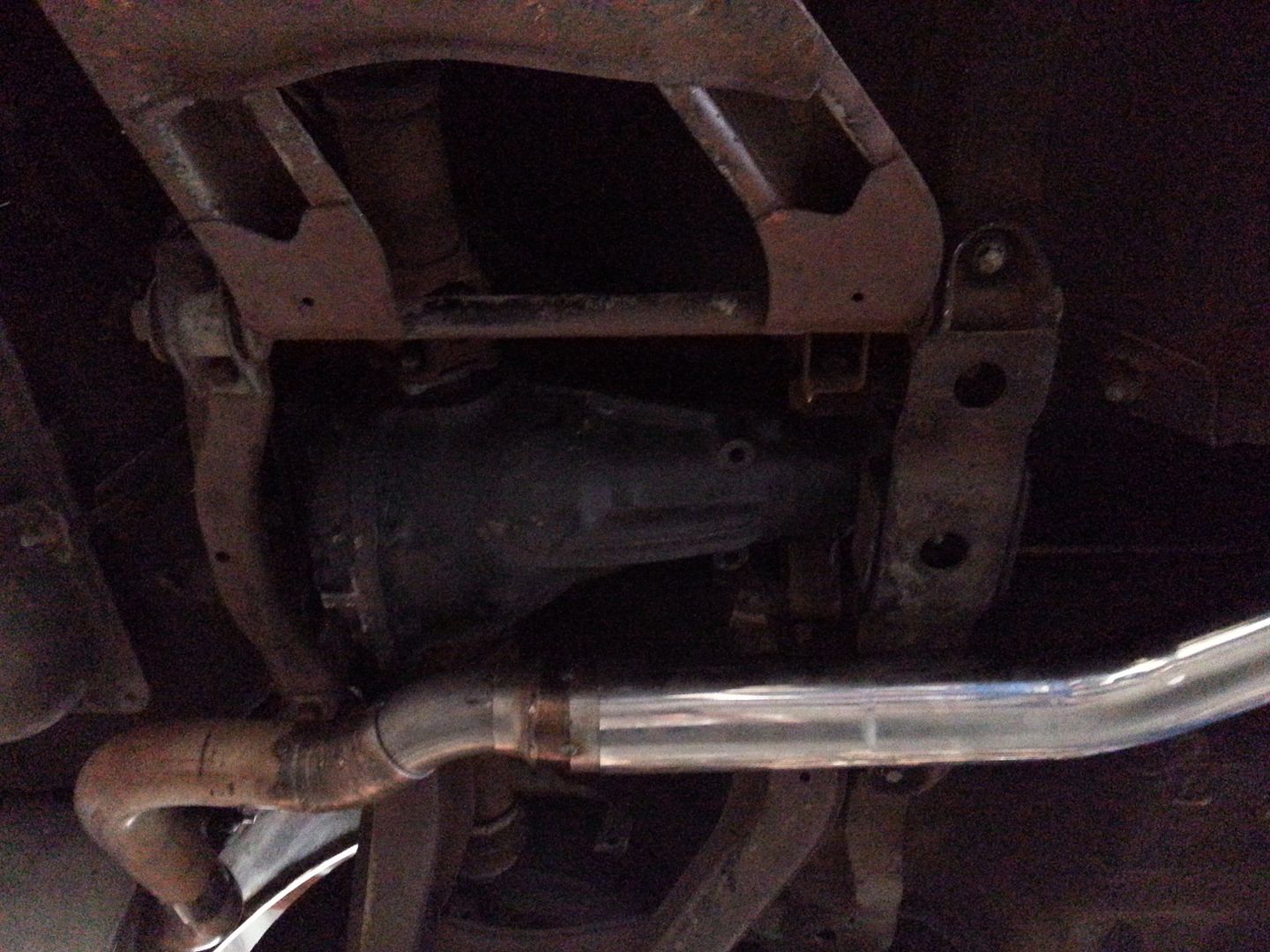

S13 diff with Nismo lsd

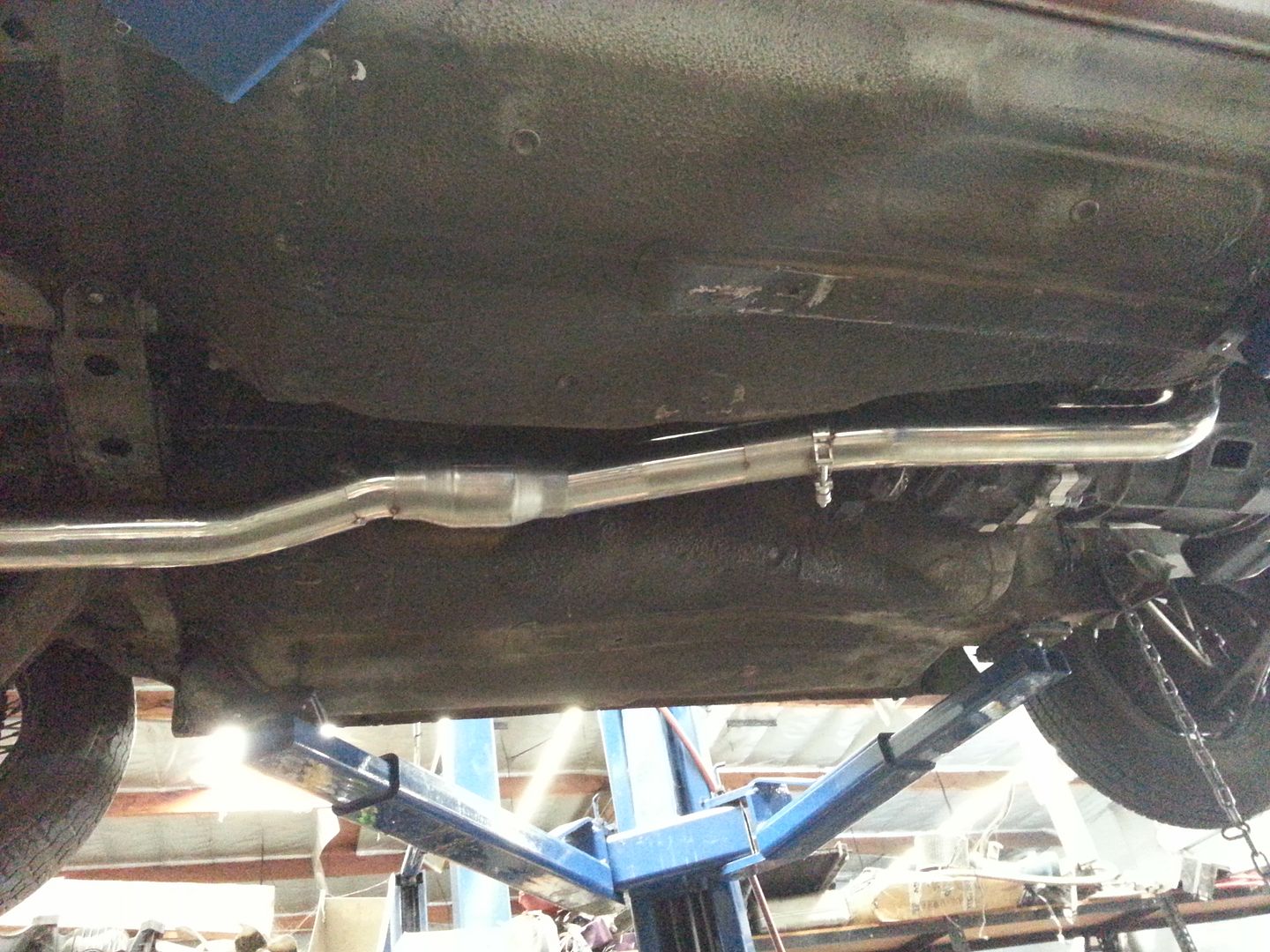

3" exhaust with hi-flow cat tapered down to 2.5" to a HKS Sport muffler

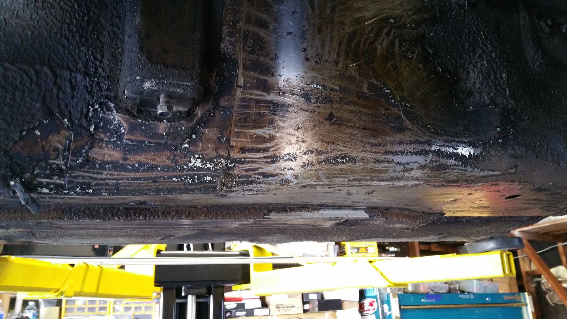

Front suspension installed, undercoating removed, rear end removed for refresh and undercoating access, transmission and exhaust installed.
