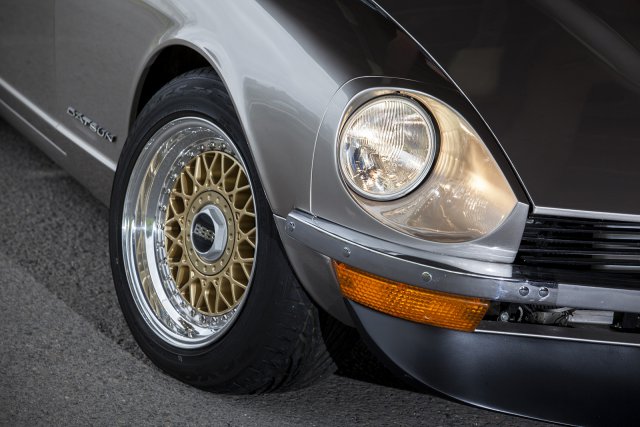

Found original front valance and replaced that MSA front spoiler. Like this look much better.
Engine bay is quite a mess, so need to weld all those extra holes and get it painted again. Also need to hide those electric wires.

Super clean ! More nice with the original front !
