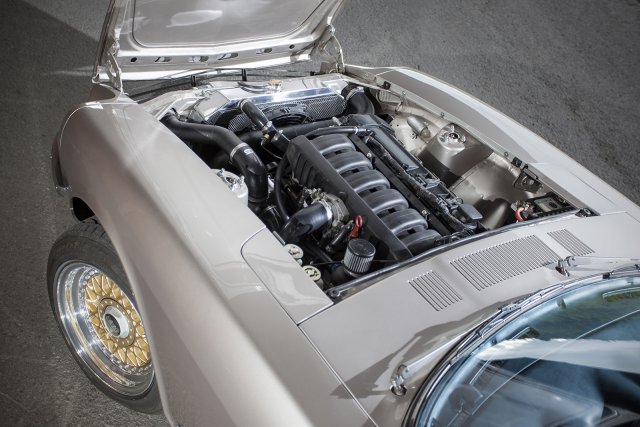

That N52 or N54 would be nice modern 6 cyl option. Haven´t looked if some of those engines have rear sump, if not it is not as simple swap as this was.
Im on the fence what to do next with engine. More displacement, turbo, more displacement+turbo, or totally different engine. European E36 M3 engine would be nice, too bad those are hard to find and quite expensive.

If it were my car, I'd be looking to move toward an aluminum block. Either an Al M52 block, or toss the M52 for an M54 , which should be much easier to find. It's been swapped into an E30, so there should be an easy rear sump oil pan solution if it isn't rear sump already.

M54B30 could indeed be good option. Those are cheap, have dual vanos, and as said have aluminium block. And I remember correctly this sump that I currently have fits to that engine.
That engine combined with Rotrex could be nice combo. But next summer is going to be this old engine.
