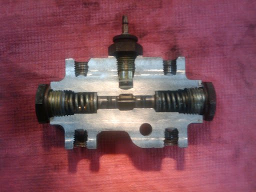

when i press the pedal it is full soft and brake light goes on.

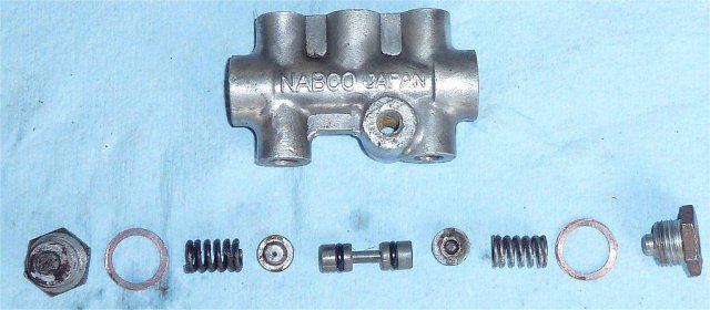

The brake pressure switch is tripped and needs to be reset.  You have to thoroughly gravity bleed the brakes and get fluid to all four corners before pushing on the brake pedal.  If you don't, the difference in brake pressure front to rear causes the switch to trip and block off brake fluid flow to either the front or rear depending on which end has the lowest pressure (most likely the rear).
FYI... throw away the speed bleeders.  The exacerbate the problem you're having.  You have to get the front and rear hydraulics full of fluid without touching the brake pedal and speedbleeders keep that from happening.

Brake Differential Pressure Safety Switch: See pictures. The brake switch has a piston that shuttles to the low side of the brake system if there is a leak in the front or rear brake circuits. As the piston moves towards the low pressure side it makes contact with the wire that turns on the brake failure light.  I took mine appart and it appears that the piston will return to the central position once pressure is equal for the front and rear brake circuits. I found no mechanism that locks the piston in the rear or front brake circuit position.  If the piston/cylinder is corroded,  then the piston may stick in the bore and not return to the center position. My switch was badly corroded inside so I removed it and replumbed the lines to the master cylinder. Do not "gut" the brake switch. If you do you will tie the front and rear brake circuits together. Most likley, once you have all of the air out of the brake system the brake switch will not be an issue
