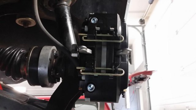

That's nice that yours went well. I went to go install mine today but the bracket doesn't seem to be right. The rotor touches the bracket.
I am pretty sure I have mount installed correctly with the logo facing outward.
  • 2 weeks later...
Got the new brackets and everything fits. They (brake calipers with parking brake) even fit my konig rewinds 15". The sticky wheel weights I have on wheel were to thick and caught the parking brake mechanism. Have to get the wheels rebalanced with either slimmer weights or conventional weights.

Anyone have any driving time on this kit yet?  I have the 300ZX/240SX rear set-up now and find it a bit weak. If you have them do you also have an adjustable proportioning valve?  If so or if not how is the balance front to rear?  Ebrake work fine?  My front Willwood rotors are just about toast after about 30,000 miles.  Bake pads were too aggressive so they are doing great but the rotor is almost gone.  Not the way you want to do it. I'm seriously considering redoing the back with the TTT kit when I go in to replace pads and rotors on the front.
Currently no adjustable proportional valve. Have s12+8 with vented rotors up front.
E brake doesn't work yet since there is no cable yet...
Balance feels pretty good.
