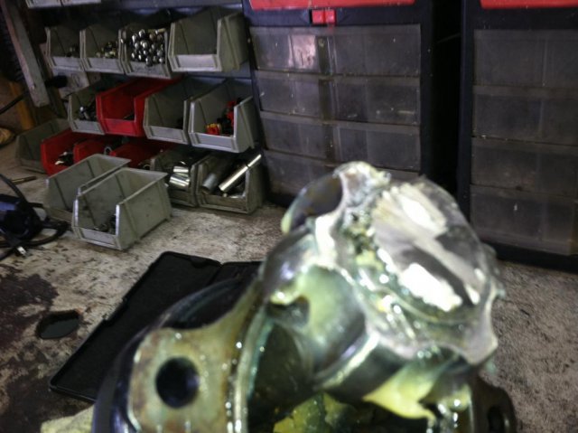

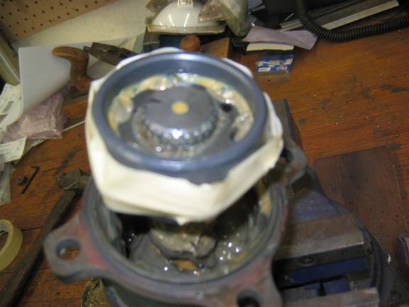

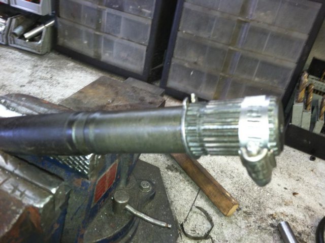

Anyway, I took the CV's into work to flip the cages and got to looking at it. The bearing cages are held onto the shaft by a couple of C clips at both ends and then slides within the CV housing. After flipping the cage, the axle itself is now the longest point. I got to thinking about this, it's the CV axle shaft that makes contact with the stub axle causing the binding which in turn pushes against the diff and can wreck the ring gear/carrier bearings. This is why MM sells shorter axles (by 1/2 inch I believe).

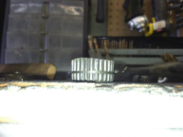

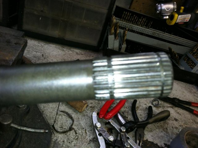

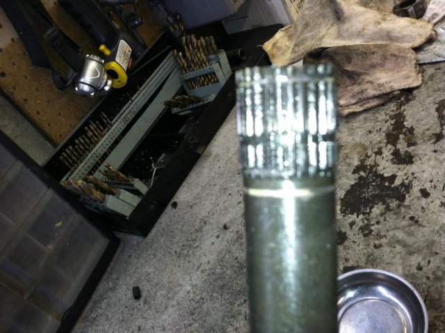

So I got to thinking, why not just move the channels where the C clip secures the bearing cages and cut down the remaining axle? There is plenty of spline left on the axle for the bearing cage, the new grove I cut in the axle is still larger than the factory indentation for the CV boot, so I didn't compromise strength at all, so I'm not sure why no one has done/thought of this.
With that said and considering CV axles are way cheaper than a R200 LSD, I busted out the grinder and shortened the axles by about 5/8 of an inch. I made 2 new groves for the C-clips and I believe I have a very inexpensive solution to buying shorter axles.
I just wanted to post this and to see if anyone can chime in to a potential problem that I'm not seeing as this seems like very simple and cheap solution..

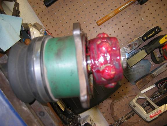

I stole a couple of photos from another web site as I didn't take a photo of what just flipping the cages looks like.
One is as it sits, the other is when it is flipped... and then on from there.

It won't hurt the heat treatment and it's on the very end of the shaft so it wouldn't really effect the shaft. Also, if you look at the 4th photo, the "weak link" would be the grove for the CV boot.

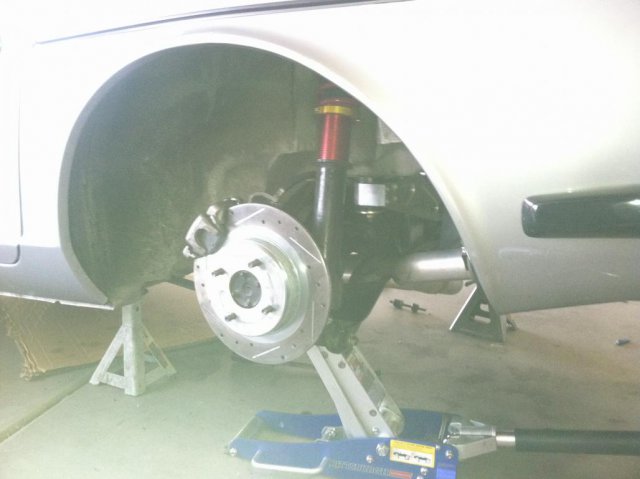

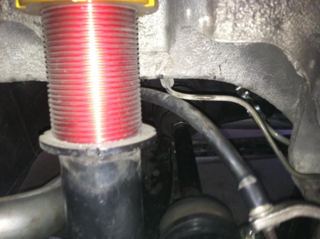

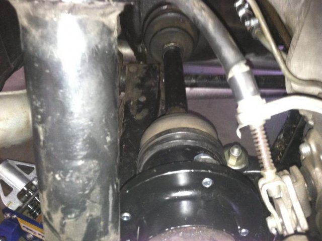

So I installed my newly shortened CV axles yesterday. I installed the pass side first and then the drivers side. When I installed the drivers side, I had the control arm supported higher then when I did the pass side (I don't like the suspension to hang from the top hats).
Anyway, both popped right in without removing the strut and I had at least 1/2 inch of clearance. I then took her for a drive and it might be my imagination but it seems much smoother so drove on over to the freeway to test her out and no issues at all and it got rid of the slight vibration I used to have at 90+.  When I got home I pulled one of the axles (drivers side) to check to make sure the cage stayed put and it did. So, about 30 miles and so far so good. I will keep this post updated as I put more miles on my conversion.  I might add that my car is only lowered about an inch.

Looks great!  The last thing to do to verify your axle length, is to drop your spring seats on the threaded collars and jack your suspension up, using a jack under the spindle, to the lowest level you could imagine your car squatting to under hard acceleration.  (Remember, the axle needs to be as short as possible in order to install it when the suspension is in full droop/hanging from the top hats).  The axle needs to be as LONG as possible in order to not pull out of the outer CV (or out of the diff,depending on which c-clip is strongest) when the suspension is in full compression.  Back to where I started: so once you have your suspension compressed, pull back the larger diameter side of the outer CV boot and inspect to be sure the balls are riding in a position well inside the CV "cup".  If not, the axle will pull out of the CV some random time when you launch hard.  When the cage jumps out of the cup, it jams the inner CV into the diff.  I only know this by experience from having both axles that were too long and too short.  The outer CV cup is so short that there is actually a very narrow window between too long and too short.  That window is so narrow that I have to change one of my axles when I change my camber significantly when changing from drag set up to autocross/roadrace setup.  Instead of fancy CV band clamps, I use large screw-type hose clamps from the hardware store on my CV axles to make this sort of inspection easier.  So far they have never slipped-even when a CV came apart.  I'm gonna try your technique, but I gotta get some more axles to play with.
