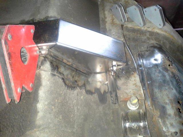

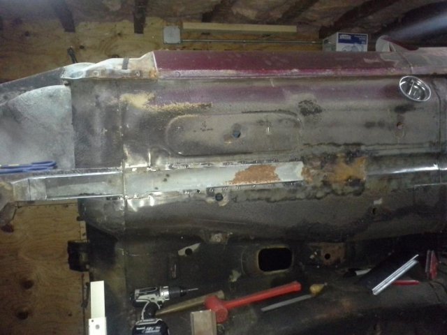

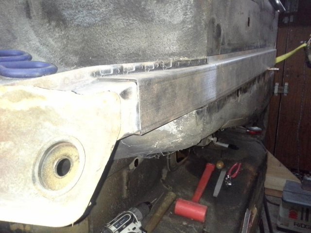

At this point, I'm cutting off the frame rails. Drilling out do spot Wells in pretty darn easy, as long as you're patient with it. I went to Harbor Freight and bought 3 spot weld cutters because I read people go through them real fast. I'm still on the first wside of the first one, and have cut out a few hundred spot welds so far. Just don't go full speed. But I digress.
Removing the original rail makes installing the new rails much easier. The floors are easy to make as straight as the new rails. Using Cleco's to hold it all together. I got the driver side front rail fitted up real nice and am currently fighting with the rear rail, having to pad it a litte here and there. I just wish my welding skills were as good as my fitting skills.post-39558-0-74158900-1416627856_thumb.jpgpost-39558-0-74158900-1416627856_thumb.jpgpost-39558-0-41482200-1416627875_thumb.jpgpost-39558-0-25486000-1416627897_thumb.jpgpost-39558-0-56373300-1416627938_thumb.jpgpost-39558-0-05296200-1416627955_thumb.jpgpost-39558-0-75541400-1416627984_thumb.jpgpost-39558-0-64826300-1416628012_thumb.jpgpost-39558-0-59750200-1416628034_thumb.jpg
