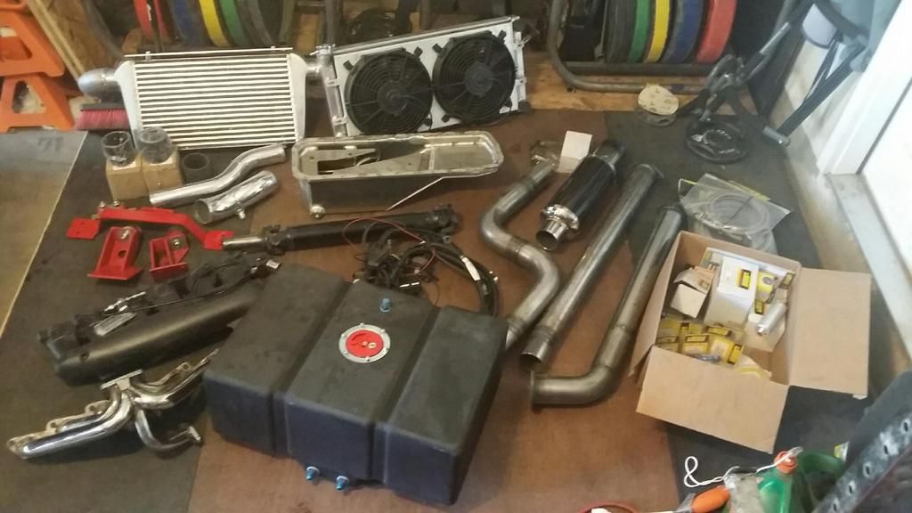

  I stumbled on a killer deal on craigslist on a TON of RB parts from McKinney motorsports...  check this out this little jackpot...
  Lots of goodies for cheap.      Anyway.. I will be going with a RB25DET NEO, rather than the RB26.

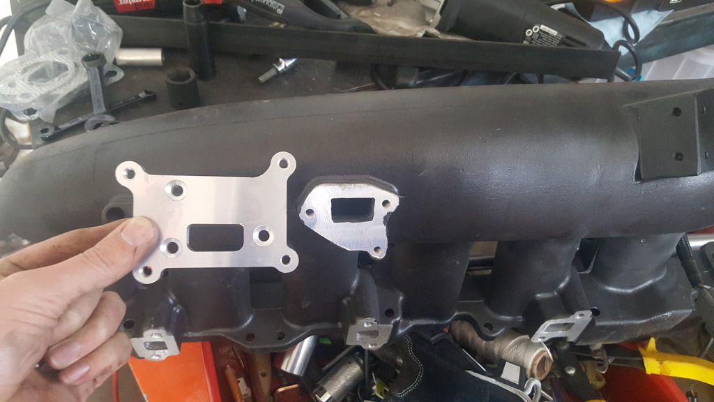

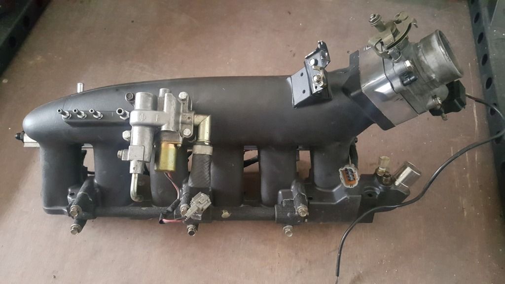

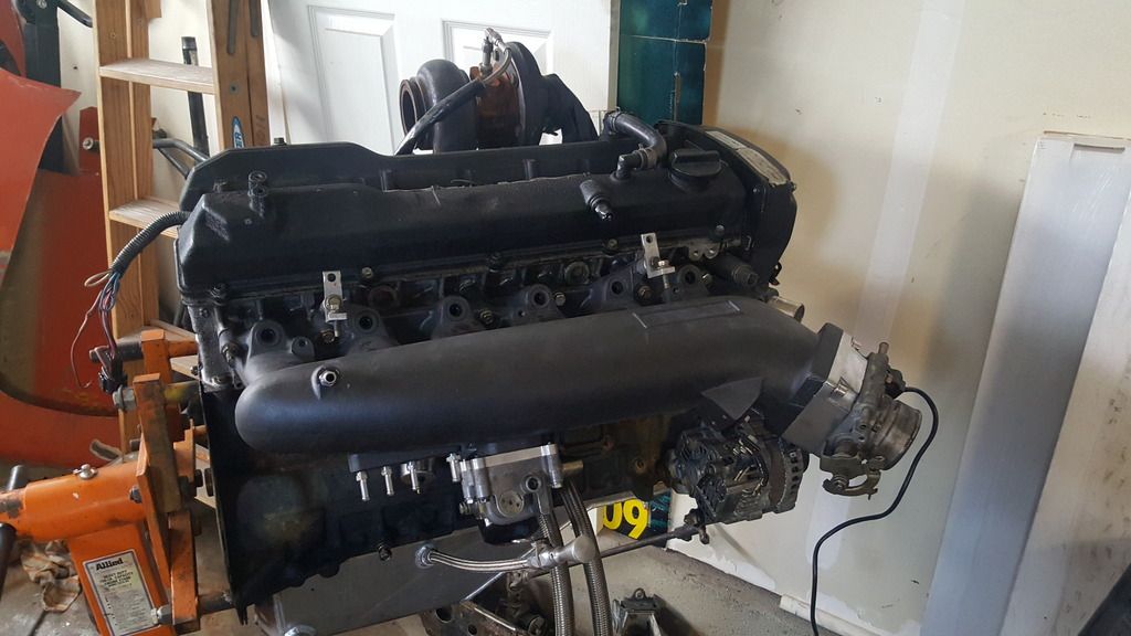

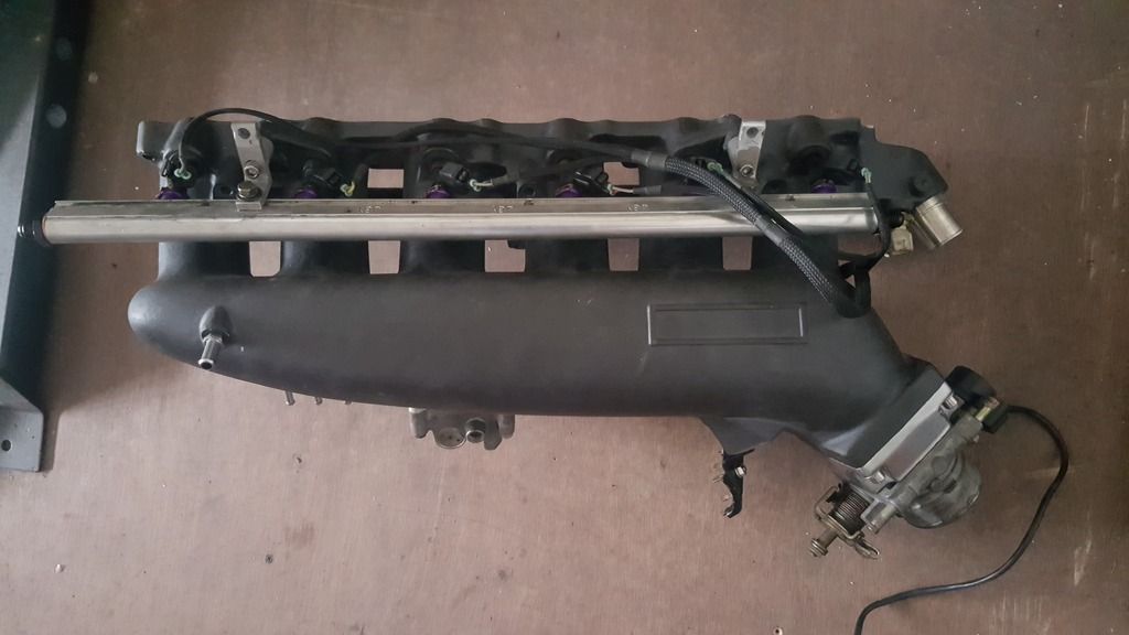

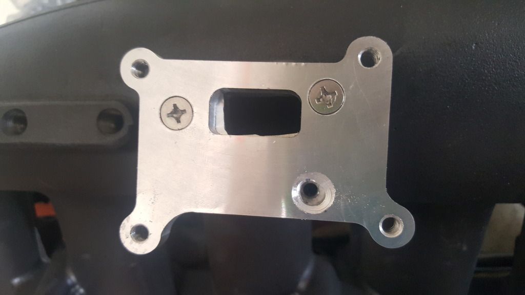

Alright ran into some problems today swapping in my Greddy intake plenum...
First off in the NEO, the fuel rail bracket has a different spacing so I had to modify that.

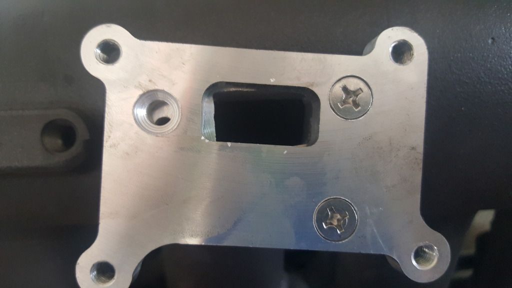

In addition the NEO has a 4 bolt IACV instead of a 3 bolt. So I ordered a machined adapter to fit the 4 bolt IACV on the Greddy manifold... surprise surprise the holes weren't drilled properly .
So I had to re-drill and countersink it..

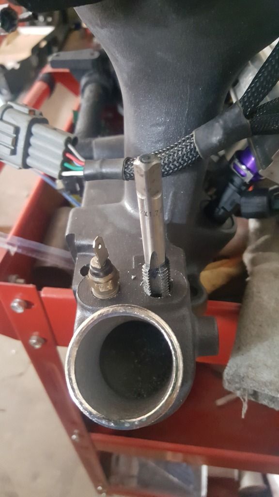

I also had to re-tap most of the air and water fittings...
All done
