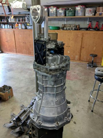

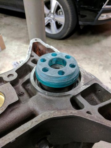

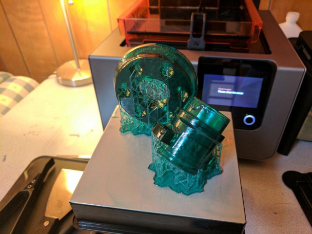

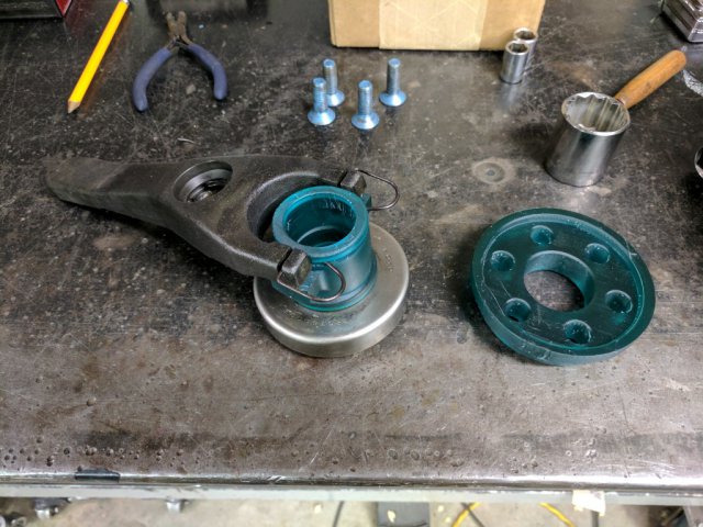

Flywheel spacing has been confirmed,  the L28 flwheel and clutch is positioned using both a spacer and a new throwout bearing sleeve.  The combination of these two parts aligns the flywheel with the input shaft splines and locates the 350z slave cylinder fork correctly.  Due to the thicker dual mass flywheel (DMF) and clutch used on the 350z the 6spd trans has the correct shaft length but different spline location compared to the stock S30 transmission...thus requiring the spacers.  The great thing about this though is you may use any L series clutch which most folks will have already invested in upgrading. The flywheel spacer will be a turned component which is then ground to ensure the two mating faces are parallel within several ten thousands of an inch....I have a quote out to ARP for custom metric flywheel bolts with the correct grip length for this new setup. I have a SLA printer in house now and used it to mockup these components and check fitment:
Attached File  IMG_20170316_231029.jpg   83.85KB   2 downloads
Attached File  IMG_20170317_213703 (Medium).jpg   254.18KB   1 downloads
Attached File  IMG_20170317_220214 (Medium).jpg   56.88KB   1 downloads
Attached File  IMG_20170318_100914 (Medium).jpg   71.1KB   1 downloads

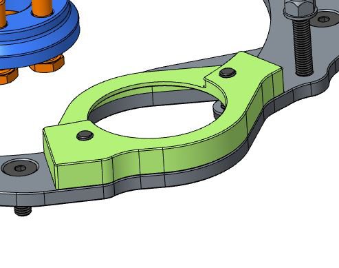

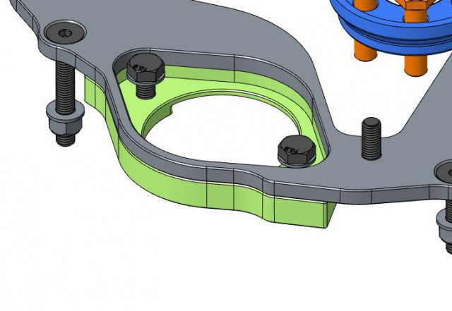

With the clutch at home the next step was the starter location.  With the new flywheel spacing the starter has to shift to match the flywheel, this was easy enough to work into the adapter plate.  Unfortunatly the starter pockets in the CD trans line with the L series block and just dont jive with where the starter needs to be.  This will require material removal on the bellhousing, its not precision work through so it can be done by most folks at home.  I'll use basic hand tools to develop a suggested method on my transmission. Here are a few shots from CAD, I will be 3D printing this over the weekend.
Attached File  starter_spacer1.JPG   33.42KB   0 downloads
Attached File  starter_spacer2.JPG   49.88KB   0 downloads
