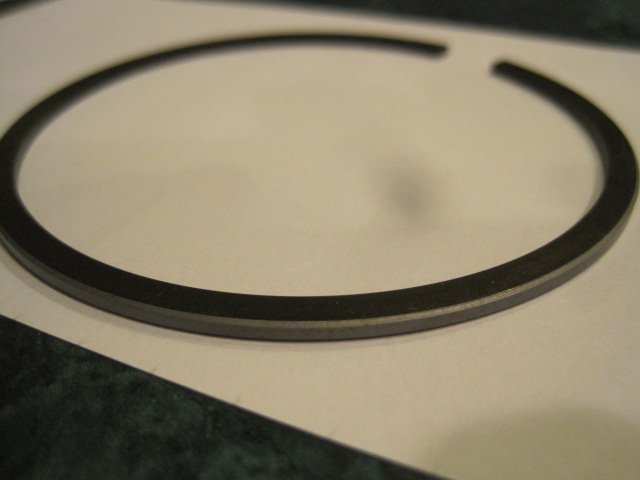

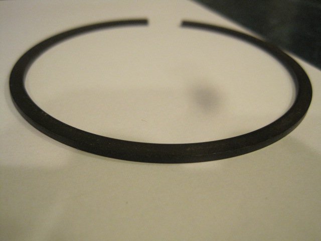

Well my ebay rings arrived today in their Dana Corp box. I haven't delivered them to the machinist yet, but our big concern was the second ring being a napier style ring. The rings have no instructions and ,or description of what is what. I can only ASSume that the second ring is the one with the shinier outer surface.
It is the only ring that has any "cut' or resemblance of a napier cut. It looks chamfered with the naked eye, but under a magnifying glass it looks more like a napier cut. The only markings on the rings themselves is a TP and .075 on both rings. I would also like to ASSume that the markings indicate the top of the ring. I think TP is for Teikoku Piston corporation, but I would think the placement of the mark would be to place it topside.
