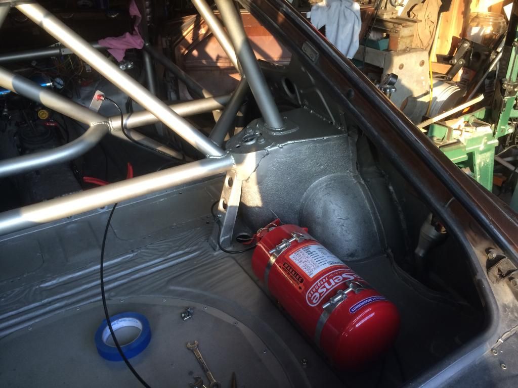

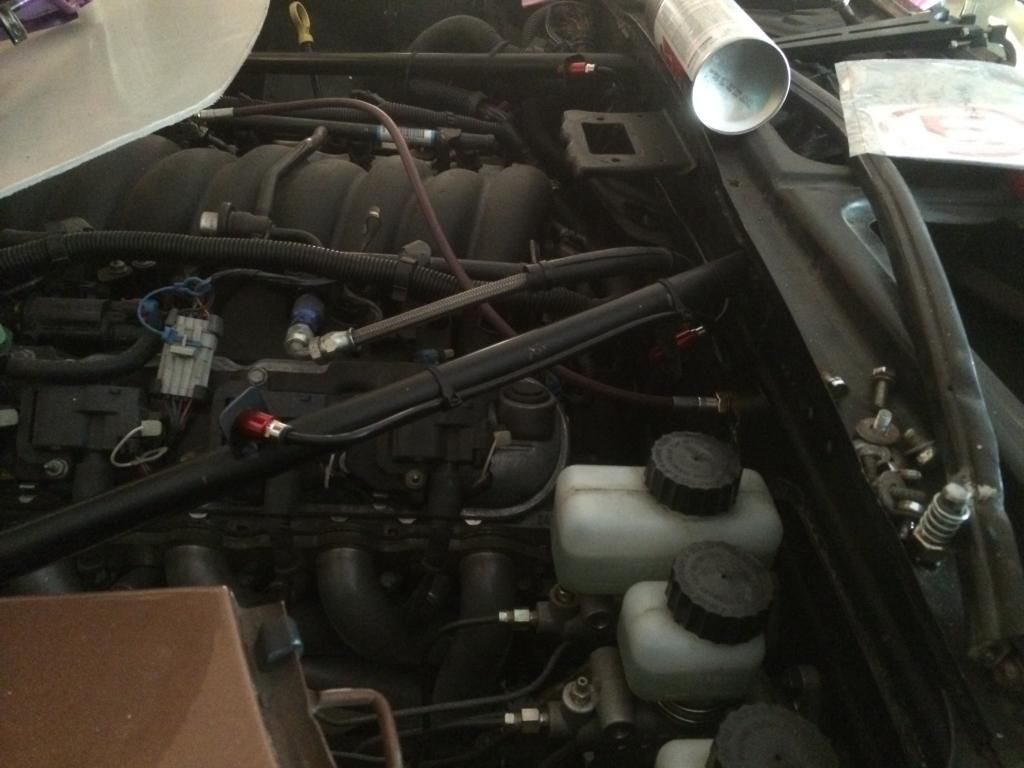

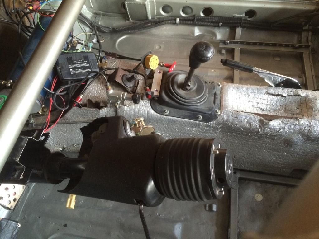

Thanks for the update! I hope to finish up my fire system this weekend. My bottle is a 10# and looks smaller diameter and longer-I like your bottle better. I got all my installation instructions from the supplier. My nozzles have to be oriented vertically-they aren't to be mounted on their sides. They are a different design than yours (Im not at all suggesting that one is superior to the other-it's just wild how much the products vary). My bottle is in the package tray because my battery is where your bottle is. My safety guy also instructed me to orient my nozzles I to the foot wells facing away from the driver. He says the idea is to activate the fire system while still moving to allow time to get car stopped and let the driver bail out of a stationary car. He was very concerned that I not direct nozzles onto myself because doing do might make it too hard to see to drive the car to a stop. I've seen em installed both ways. I too love your shifter boot (from a camaro)? And I like your prop valve location. What is the yellow knob?

Yellow knob is the dual master brake bias adjuster.  My fire instructions said to put the nozzles in the corner of the windows.  I thought that would be not good at all if you wanted to see and breathe so put them towards the legs/feet as well and the over the shoulder one.

The only guy I know who has been on fire is CobraMatt. My safety steward said that most fires come from the engine/firewall/dash and the flames lick backwards following the wind thru any holes in the firewall. He said that at 150mph, a tiny hole is like a blow torch. I asked if I should do anything back at my gas tank due to my stock rubber filler tube passing thru the interior of the car. He said that statistically that was a low-risk area and not to worry with it. I will be putting a nozzle on each kick panel facing in and forward to firewall. Then later this summer I will put one on each side of the radiator support facing rearward. He says the wind blows the foam backward and that sprinklers on the engine side of the firewall don't do much beneficial. They are super strict against any openings in the firewall, so I will be taking a roll of foil tape. I watched some videos on YouTube of race car fires and they were all under the dash at the driver's feet. But, none of them were crash videos-just fires that started during the course of a race. So, you can adjust brake bias both mechanically and hydraulically?
Share this post
I've been in two cars that have been on fire on track... As RebekahsZ mentioned, most are due in no small part to fluid igniting on hot motor parts.  Do yourself a favor (as I will be doing) and weld closed ALL openings in the firewall, transtunnel, or anywhere else along the driveline... Think about any fluid that will connect with HOT exhaust pipes from CV Axle grease to differential and brake fluid to trans and motor oil to wheel bearing  grease.  ANY petroleum based fluid will ignite with enough heat and I've seen heat as high as 800 degrees on brake rotors/calipers/wheels.  So keep all that in mind.

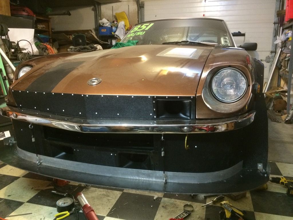

The new front end for whatever reason makes the engine run much cooler. Its what you see plus the splitter was extended back maybe 8" to right up against the crossmember. Has always been sealed and ducted to the front but now pretty much run at the stat setting instead of the low 200's before. Ran Gateway in St Louis which was more fun than i expected then UTCC and NASA TT at VIR last weekend. VIR was even more challenging than I epexpected and only ended up with a 2:04.5 lap time well off the target 2 flat. The UTCC was really not much of an event with only 35 cars and didnt feel any different than a TT. After the UTCC I found the right rear gland nut to be completely loose alowing the strut to slide up and down in the spindle. Then Saturday the spindle itself snapped and caused wicked loose condition but got luckly and made it onto the trailer with no other damage. The new 3.54 / tuned OS Giken worked really well. Now need to replace upright and figure out rest of season.
