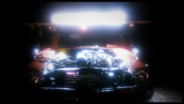

When ADHD meets darkness. I think a plane was circling waiting for permission to land. :-)

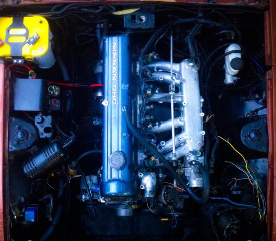

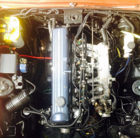

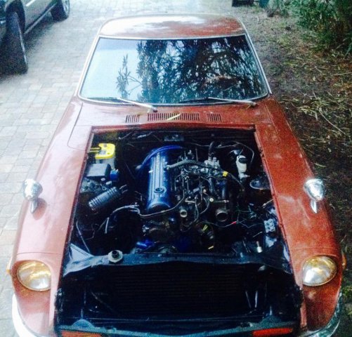

I went through and cleaned/replaced all the grounds. I replaced a good bit of wires. I really can't wait to put in a MS. It probably would have been easier to just rip everything out and put the MS in.
I have just been looking at the efi bible and reading stuff online trying to figure out the vacume, efi and fuel system.
I pulled the fast idle and I think I'm going to take out the cold start. I was also thinking about pulling the air regulator.
I have a pallnet fuel rail on the way just for the stock injectors. I will switch injectors down the road but I'm going to run this for now. I think I am going to rewire the injectors into one new wire harness as well, but all that stuff will probably get pulled out when the MS goes in.
I'm still reading and don't fully understand the whole system yet. Any advice or good reading material is super appreciated.
The vacuum switch valve was a riped out wire and was never hooked up, still trying to understand that?
Well, making small progress things are just moving slow.
I have a planet fuel rail on the way just for the stock injectors. I will switch injectors down the road but I'm going to run this for now. I think I am going to rewire the injectors into one new wire harness as well, but all that stuff will probably get pulled out when the MS goes in.

Left out the adhd light :-)

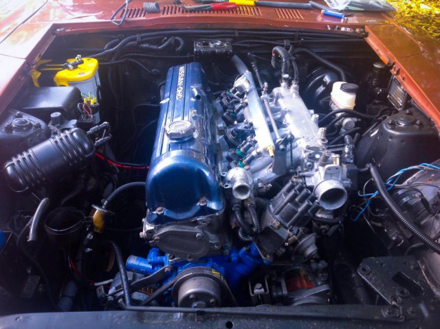

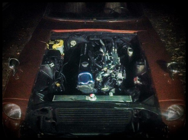

Getting closer.
Still reading about using the 83 distributor on the 75, I also have the msd.
Pallnet fuel rail in the mail, as well as a new radiator, and new pig tails for the stock injectors.
I still need to make sure I have the vac system set up right so the ac and heat work, still trying to understand how everything works.

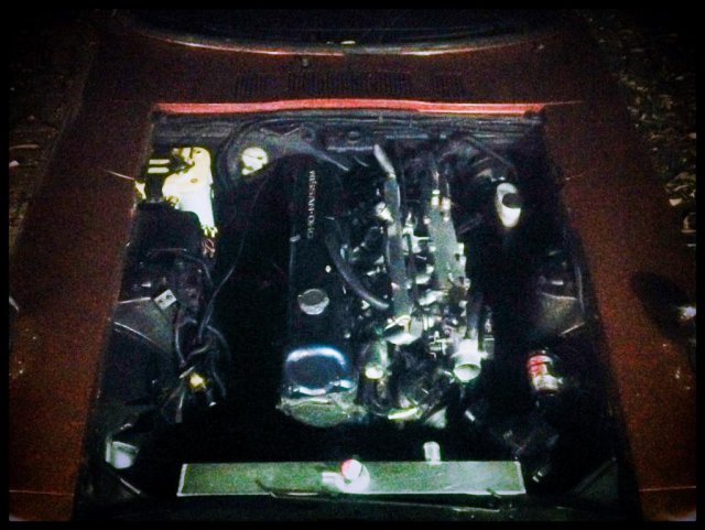

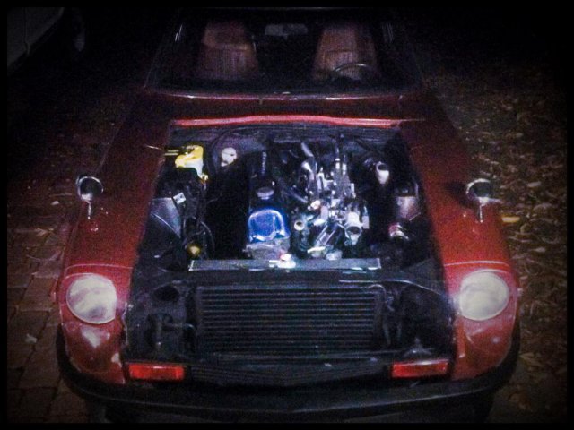

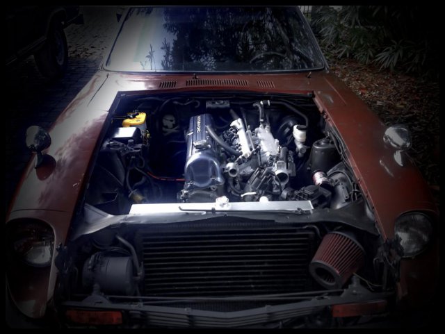

Made a bit more progress, sorry for the night pics.
It's pretty close. I would say less than 12 hours of work before I give the key a turn and see what happens.
All that's left is the vacume system, plug wires, fuel lines, electric fans and a few switches.
Finished the motor today!!! The pic is from the start of the day not the end, but it's done.
All that's left is the switch panel in the interior and turn the key. So tomorrow ... We'll see what happens.

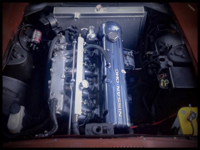

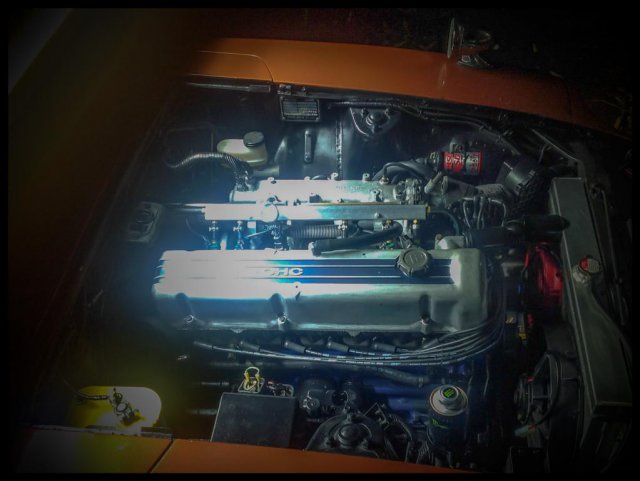

Finally,, this thing is running !!!!
