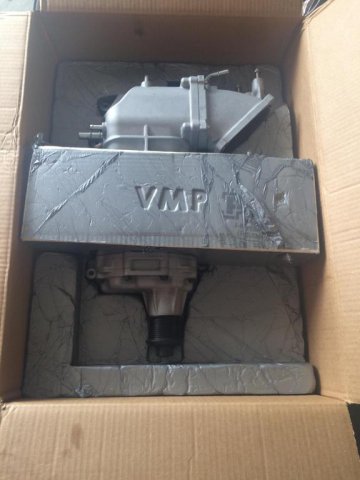

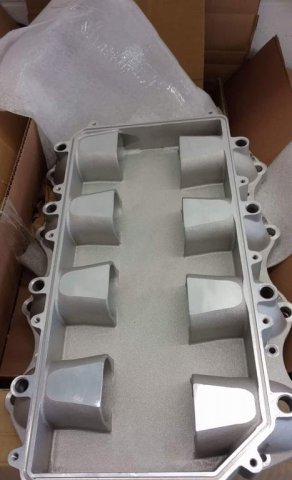

Pictures is a little deceiving, shows VMP on the foam but it's just the packaging. I had a little cash burning a hole in my pocket and couldn't pass this up at the price offered.
So now that the mass airflow device has been secured I really need to come up with some manifold designs...

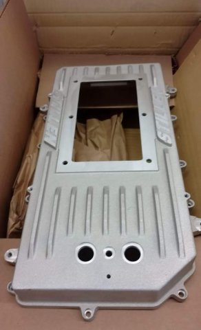

Small but exciting change, found a Harrop TVS 2300 for a really good deal and the m122 is up for sale. Also started collaborating with another VK56 enthusiast and was able to get a great deal on a Stillen lower manifold and upper plenum that should be here tomorrow. Really excited as this will get things rolling on having the blower alignment and intercooler mostly figured out with about half of the original expected fabrication work.

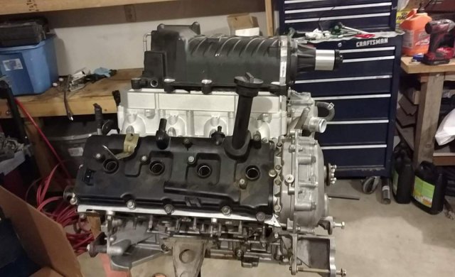

Mocked up the Harrop TVS2300 on a Stillen manifold set, also ordered in a water pump, fan pulley, idler pulley and tensioner pulley to start routing the belt. Best part about the stillen lower manifold is they cast in two sets of injector bungs so direct port meth or nitrous down the road will be an easy upgrade!

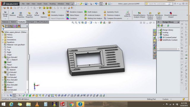

Speaking of that TIG welder I've already drawn up the pieces to adapt an LS1 cable operated throttle body to the aluminum manifold I have, thinking about the Holley Sniper 92mm or 102mm.  They look fairly simple and for about $175 they are definitely a good price compared to a Nick Williams or FAST piece, just haven't seen any real feedback on them, one comment on LS1Tech was that they mirrored some of the cheaper Chinese pieces for quality.  I'll see once I have it all figured out, had to spend a little of my Z money on other ventures today so I'm back to saving mode again, hopefully my buddy that's coming by later this week will have good news on wiring my garage up for 240v.  That would be a huge step forward for me and really open up the possibilities of getting some progress made on my chassis
