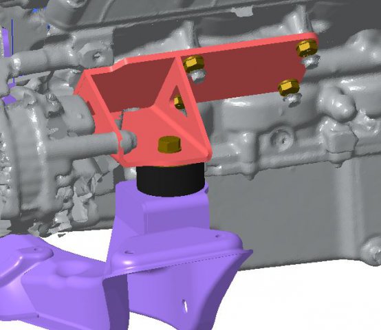

It's been a awhile since I checked this thread...... A quick update for CXR mounts. There have been a few comments/concerns/observations about how "high" the CXR mounts place the motor. I did some research and it does in fact appear that these mounts sit higher than most everything out there from what I can tell, which will raise the cars CG, traditionally declining the handling. The trade off is better oil pan clearance, good angulation of motor to drive line..... And I read from the monster miata crowd the LS likes a few degrees tilt in the back for oiling issues (need to research that more to be honest). I just installed my TTT triangulated strut brace (made for straight six) and I have tons of clearance..... Indicating that my LS on CXR mounts still sits lower than stock for better CG than stock, with continued pan clearance, and angulation. I'm not endorsing one kit over another, just posting my results to help future swappers make an informed choice. My .02. Jimpost-38304-0-68476500-1469287880_thumb.jpg
