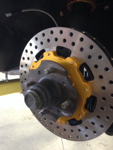

front brakes installed.

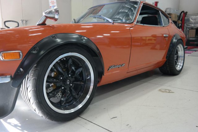

grounded the car temporarily and ride height is a little low. rears will hit the edge of the flares at about 1:00 position. Will just raise the rear up a little via coil-over.

Also, I too just bought T3s big front brakes.
Happy to see them on your car first!

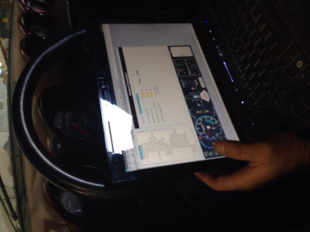

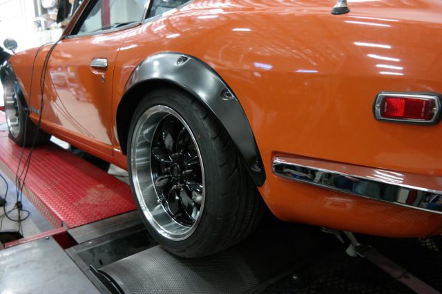

on the dyno.....sorta....
since we didn't have the original bin file, we have to figure out how the PCM was set up.....and without timing marks to confirm crank trigger, it's going to take a little more time.....
notice the original wheels are back on? car was too low and i'm out of adjustments on the coil over.....
need a taller spring.....

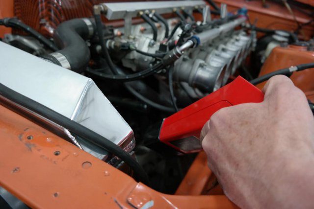

calibration begins. made our own timing marks and I can only guesstimate that we're close by the sound of the engine. One trigger tooth is worth 6 dg. so we have to be very careful.....
