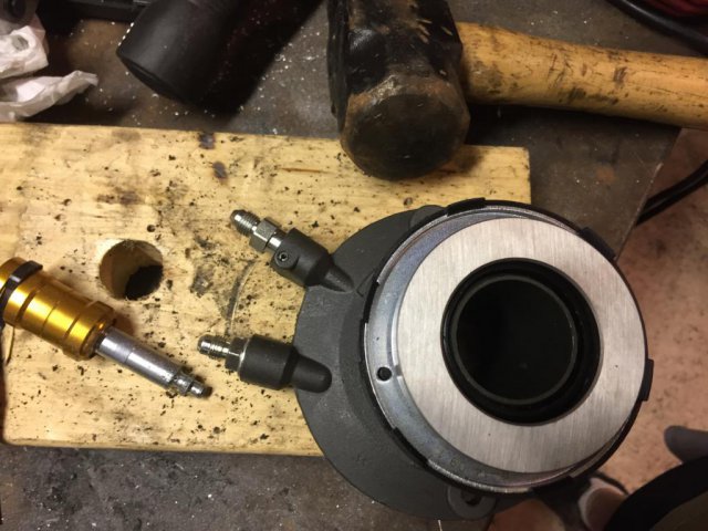

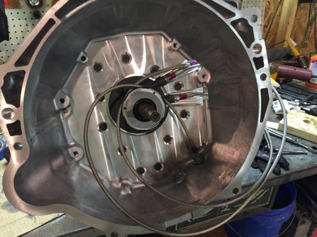

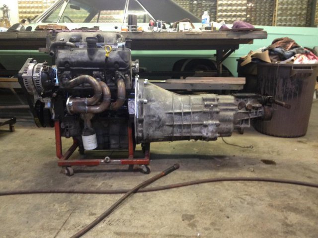

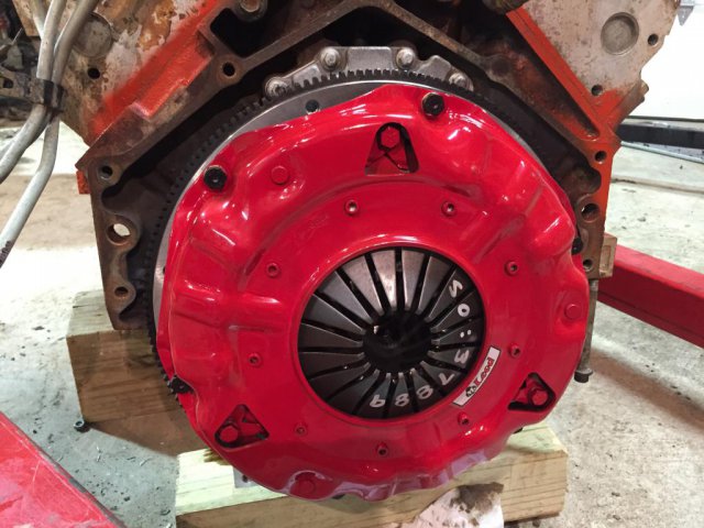

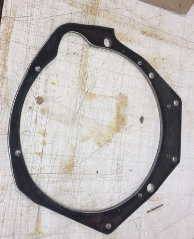

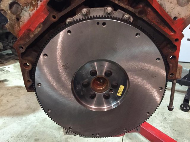

Well I finally got the bell housing cut off last night and everything fit great. I'm really impressed with the quality of the adapter. The only think I had to do was take a reamer and open the dowel hole a few thousandths. I just used a cut off wheel to get rid of the original bell housing and then used a new T56 bell from american power train. All the bolts were labeled great and start to finish it only took about 1.5 hours to do the swap.. The biggest fear is the cutting part so just go slow and you'll be fine.

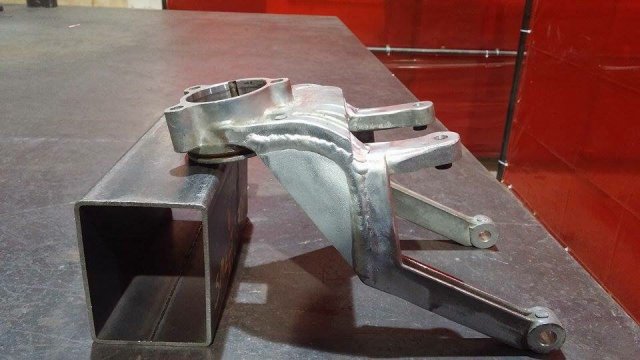

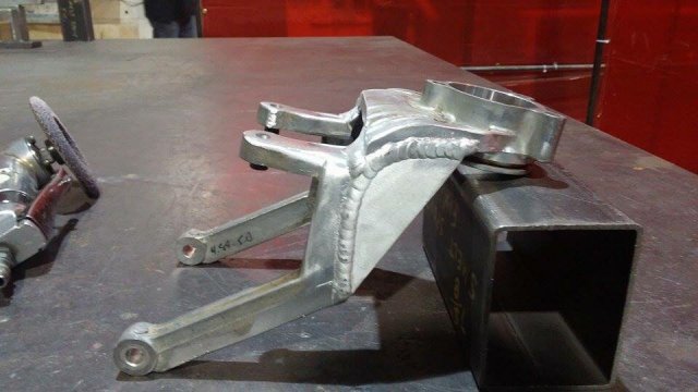

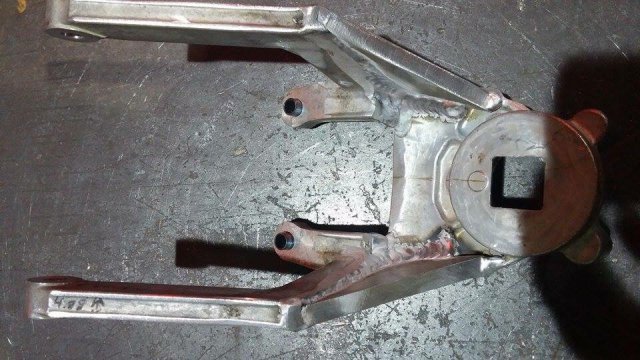

Fro the center of the shifter hole to the bell housing face its 38". That's with the stock shifter support bracket. I think I can take 4 " out of that to make it make compact. Also I'm using the dirty dingo mounts which should help with lining things up. I got the slave modified for a remote bleeder and 3 -an main line. Hopefully I can get it sitting in the car by the end of the weekend.

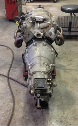

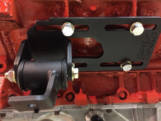

So I got the engine in and handed my shifter bracket off to a friend that works a fab shop. He looked at the shortening services and he said that it wouldn't be a problem. Using the dirty dingo mounts I slid the engine back as far as it would go. Here are a few pics from the install and I just need to adjust the mounts a bit since the tailshaft is a few degrees off center.
