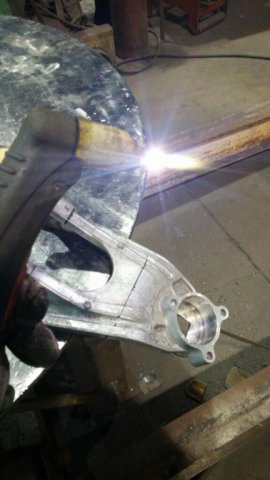

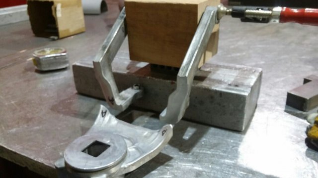

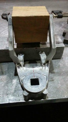

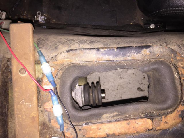

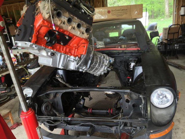

Sorry not much to update since a new addition has kept me out of the garage. A buddy of mine was able to get the shifter extension bracket shortened for me. Currently the engine is all the way back but will need to slide forward about an inch to line up perfectly with the shifter opening. Now I just need to get a car intake, turbo, manifolds modded with v bands a fuel sump.
