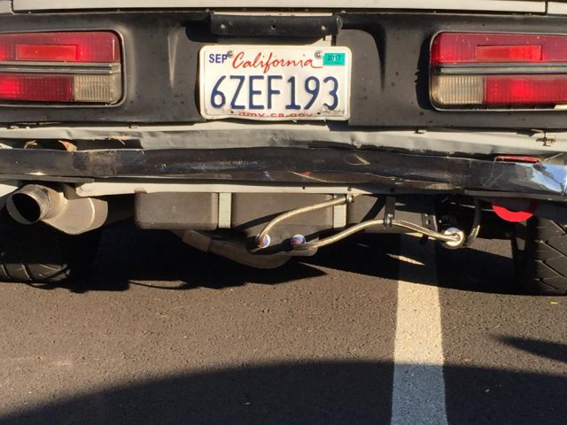

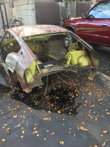

I picked up a 240 body...... Selling off complete doors, hatch, hatch glass, complete front fenders, hood, tail lights (complete), hood, front cross member...... Contact me if interested. I'm using the back end of the donor to fix my car. Thanks. Jim

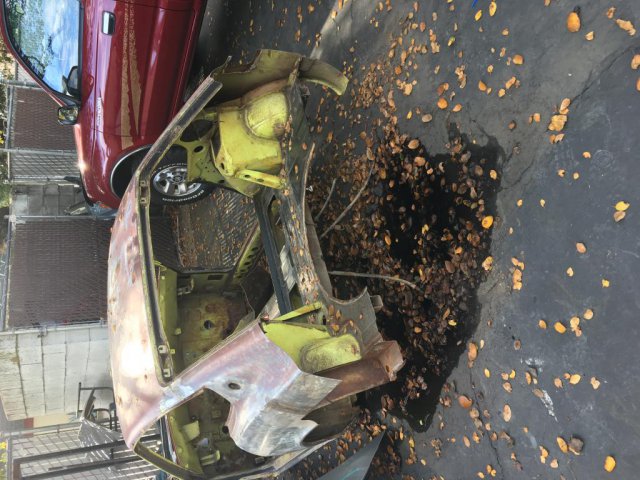

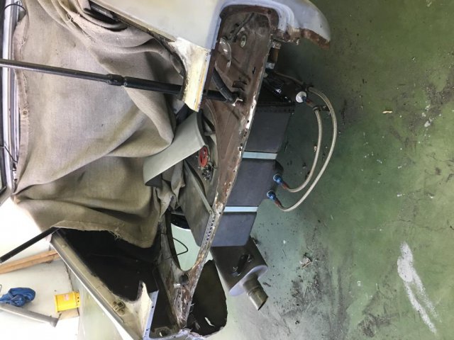

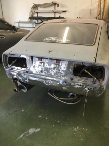

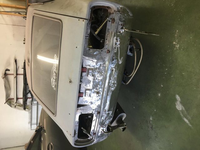

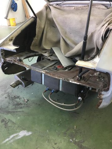

Attached File  IMG_1248.JPG   108.18KB   0 downloadsAttached File  IMG_1249.JPG   147.49KB   0 downloadsAttached File  IMG_1250.JPG   92.72KB   0 downloads

That looks like they are doing a good job, there is lots of work there, it takes some skill to get it all to line back up.  Before they get too far make sure everything is sealed up really well to avoid the dreaded Z exhaust back draft.  Congrats on progress! Richard.

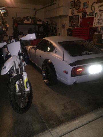

Attached File  003.JPG   48.42KB   0 downloads
I'm back!  Still some work to go but at least she's home.

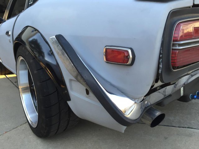

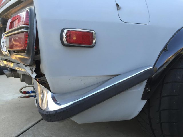

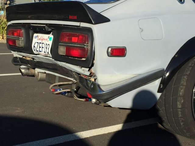

Attached File  012.JPG   64.64KB   0 downloadsAttached File  004.JPG   117.2KB   0 downloadsAttached File  006.JPG   90.75KB   0 downloadsAttached File  004.JPG   117.2KB   0 downloadsAttached File  005.JPG   65.53KB   0 downloadsAttached File  006.JPG   88.09KB   0 downloadsAttached File  007.JPG   56.99KB   0 downloadsAttached File  003.JPG   48.42KB   0 downloads
Death and resurrection..... Glad have her back in my garage.   Bumpers should be back on soon.... Racing starts in February
