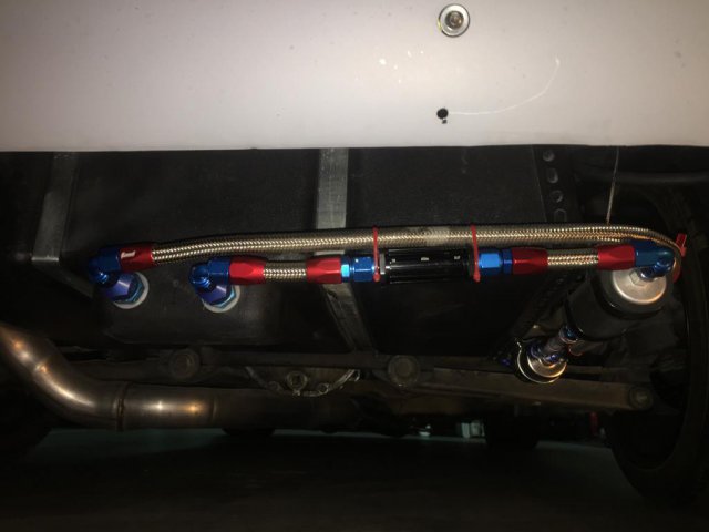

I'm adding a fuel pump pre-filter to my system...... Recently found some fuel cell foam chunk that tried to clog up my pump. A 150 micron filter should solve that and maintain Good flow. I also added some camber plates that work with stock diameter springs to add 1.5 neg camber..... First impression is good but my next AutoX will be the real tell. Jim

Pic of my of my new plumbing with pre-filter. I love making braided fuel line systems

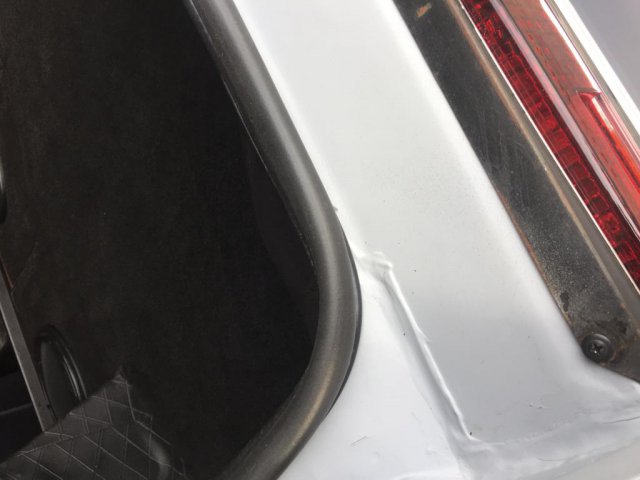

I picked up some Kia weather stripping from the yard..... Will post some pics and opinions once it's in. Only ran me $15 for both sides. Also bought some universal rubber for rear hatch. I'm getting a lot of fumes right now since the old rubber got sacrificed when the back end was rebuilt. Pics of that to follow as well. Jim

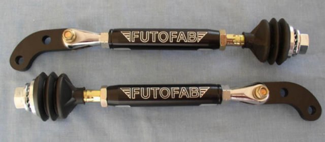

Running this motor puts the car and chassis under increased stress..... 45 year old parts will only last so long, so I ordered up some new adjustable LCA's and tension rods.  I'll post some pics and feedback when I get them in.  Jim

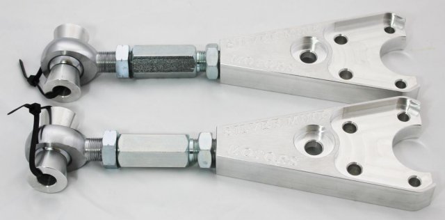

I was going to install the electric steering kit from silvermine motors but opted for their LCA for now insteadAttached File  image.jpeg   53.57KB   1 downloads
Coupled with the futofab tension rod Attached File  image.jpeg   34.88KB   0 downloads
I'm running mild camber plates up top for -1.5 and will gain more with the LCA in addition to more castor. Electric steering is still on the table as budget allows but I'm going to maximize my cars potential with this first. Jim

Still waiting on LCA parts..... Installed the precision universal rubber in the rear hatch. It works really well and seals nicely. I'll get some pics of that soon. Another AutoX race tomorrow but weather calls for rain. Weather permitting I'll post some video and get a shot or two of the hatch seal installed. One of these days I'll have my daughter set me up with a YouTube account to post full length video instead of 10 second clips.

Attached File  IMG_1401.JPG   70.52KB   0 downloadsAttached File  IMG_1399.JPG   60.55KB   0 downloads

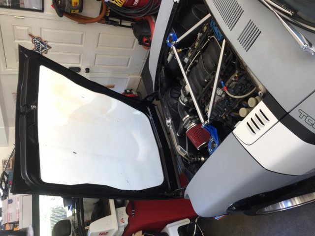

Took some time to clean up the underside of the hood. Painted the border satin black and once that's cured I will go back and Re-shoot the white. Look much cleaner for now anyway.

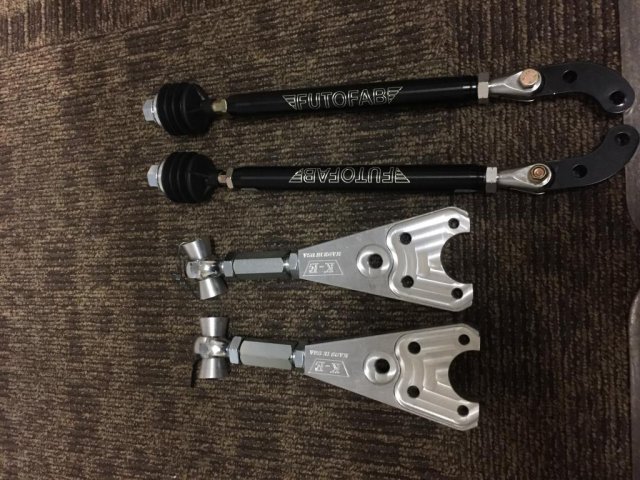

Look what showed up today. These things are massive and stout! Can't wait to get them on.Attached File  IMG_1480.JPG   149.18KB   0 downloads
