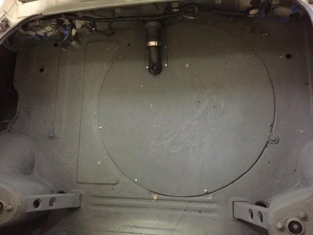

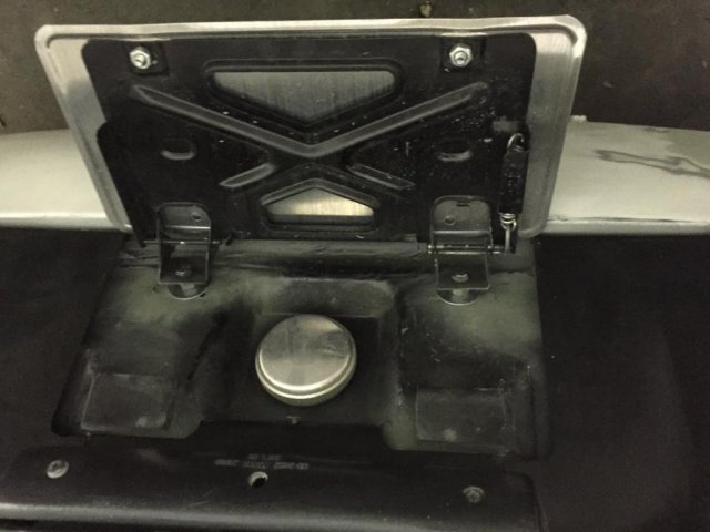

Jim,
My son put a 16 gallon fuel cell in place of his spare tire well and ran the filler neck out behind the license plate on his '73 240Z.  It's a nice installation.  If you're interested I'll see if he can give me the MFG/model number.

My son got his fuel cell from www.Tanksinc.com.  It is a universal pick-up truck fuel tank.  Part number UT-N.  When you go to the website it will show tanks.  You'll want the one on the right as it's for fuel injection. You'll need ventless gas cap to go with it and to run vent for the tank.  He ran his up in the rear passenger shock tower area. He has a bolt down plate covering the installation. He got the license plate bracket off a 50's/60's vintage auto from a salvage yard.
Also - I've been driving over 50 yearns and I've had a total of 5 flat tires, and none of them in the last 15 years.  I've had a few nails but was able to driven the tire to a shop to get it fixed.  The tire well in my Z is not useable except as a small "trunk".  The only flat I had in it was about 20 years ago when a really old BFG radial T/A blew out a sidewall on me.
