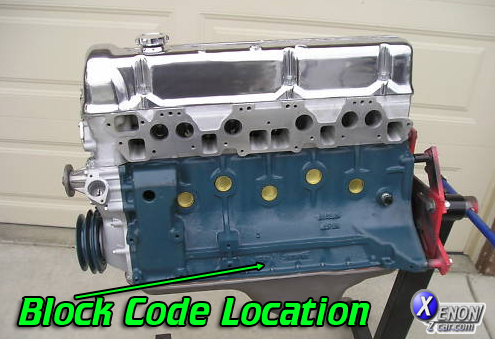

Threaded Core Plug or ?
Just a follow up. Its interesting that of the various FSM & Haynes I have for 70 - 83 that only the 79 FSM ever mentions it in an ambiguous way when draining the coolant. Anyways I used the drain plug to clear out most of the coolant in the block when I had the header & the triples off. I poured 4 liters of Evapo-Rust in the block & let it sit for a few days to clear out any internal rust.
