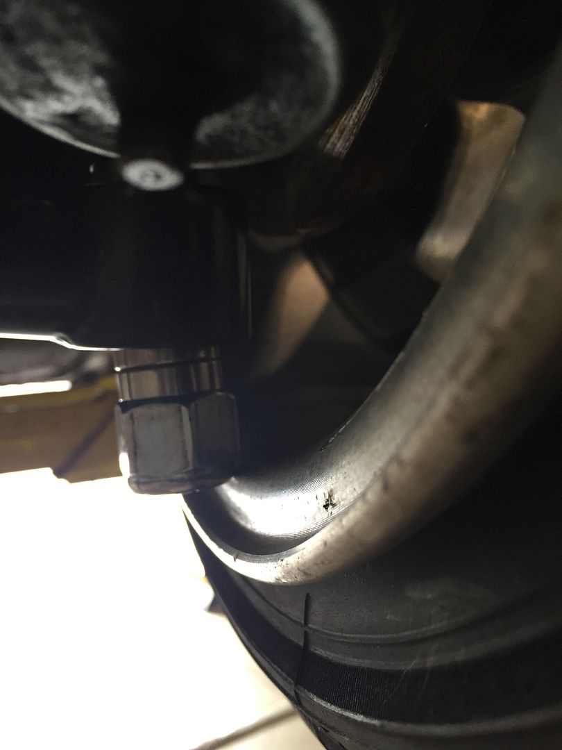

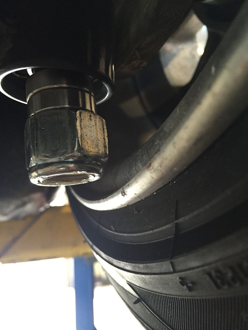

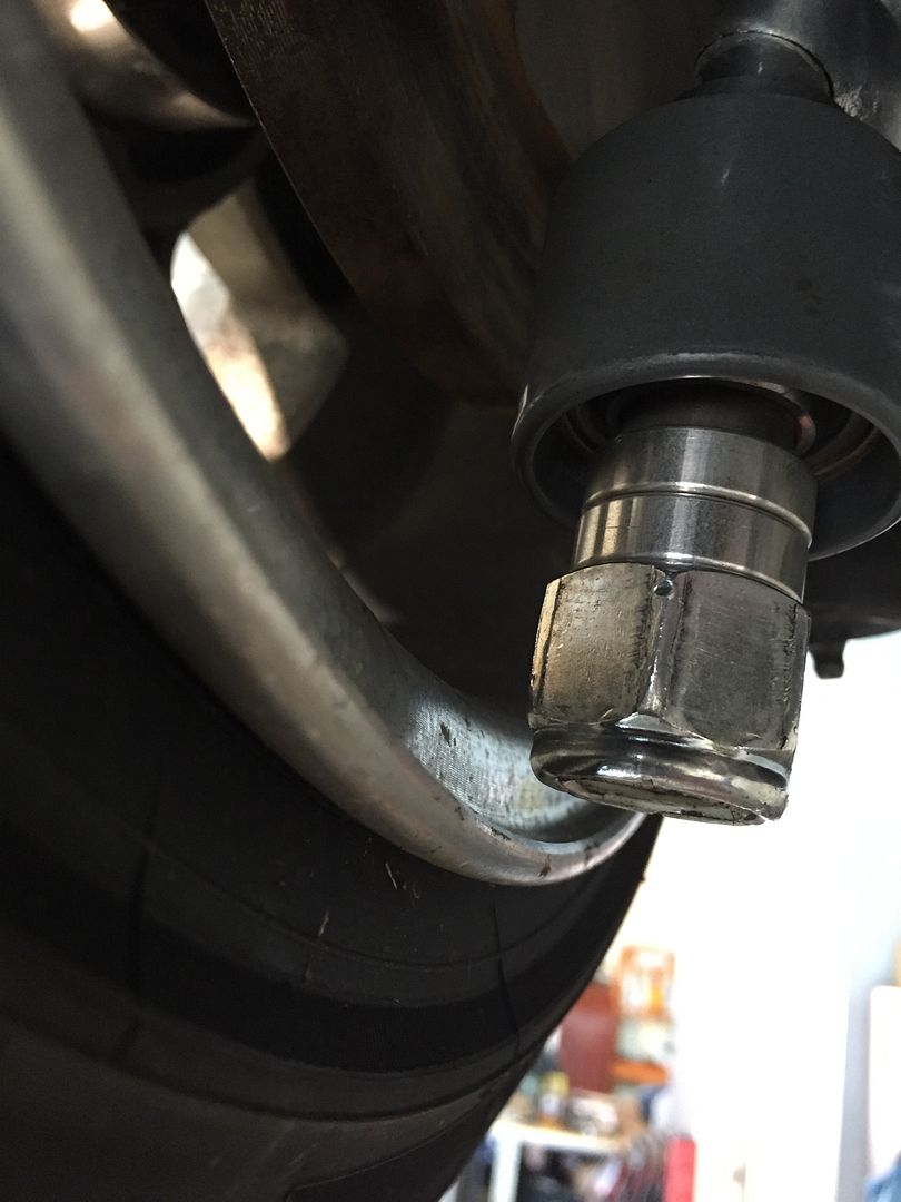

I think T3 needs to include instructions with this setup. Had to send my stock steering knuckle to be machined in order for the LCA to fit. Sooooo that also means any aftermarket steering knuckle like the AZC will also need to be machined to fit. Sorry it took a while for install. Had coilover issues and had to order a new setup which took a month for arrival.
Edited by miky360
So the hole that the ball joints bolts through to was the wrong size or taper? Interested to see the pic. I'll be at T3 Friday to drop off some parts and will ask about it. Maybe I'll bring a steering knuckle with me as well.
I asked gabriel about any issues he has heard of with these. He said he's already sold around 200 sets and the only thing he has heard is on the very early cars the ball joint pin is smaller, 11mm I think he said, compared to later models with a 17mm? taper pin.
  • 1 month later...
Update: It's not clearing because of the AZC Roll Centre Adjusters/Steering knuckle. (They're adding about another inch or so) But usually, when you order aftermarket arms, chances are you have coils or some kind of lowering setup and RCA's are almost mandatory no? So I wonder why, T3 didn't consider this.
