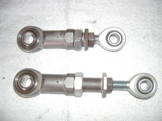

The QA-1s are called a slot bearing.  They are a 2 piece design and not designed for the amount of vibration you'll see on the rear suspension.  We used these first as they are low cost and they lasted one event and the liners pounded out.  Then AM Auroras in 5/8 and they pounded out and then 3/4 X/Ms (not sure but their top lines) and they worked fine.  I've done CMs on a street car and those seem to be working fine but it hasn't done a ton of mileage.
It's your money but I don't think you need to spend $200 a rod end to get some that work.  Hope this helps.

These are the ones I fabricated using a simple jig.  Used a 3/4 x 5/8 for the front rod end and 5/8 x 5/8 for others.  Used QA1 rod ends and have about 4 or 5 race weekends on them so far with no problems.  Also made some oil-lite bronze bearings for the inner pivot.

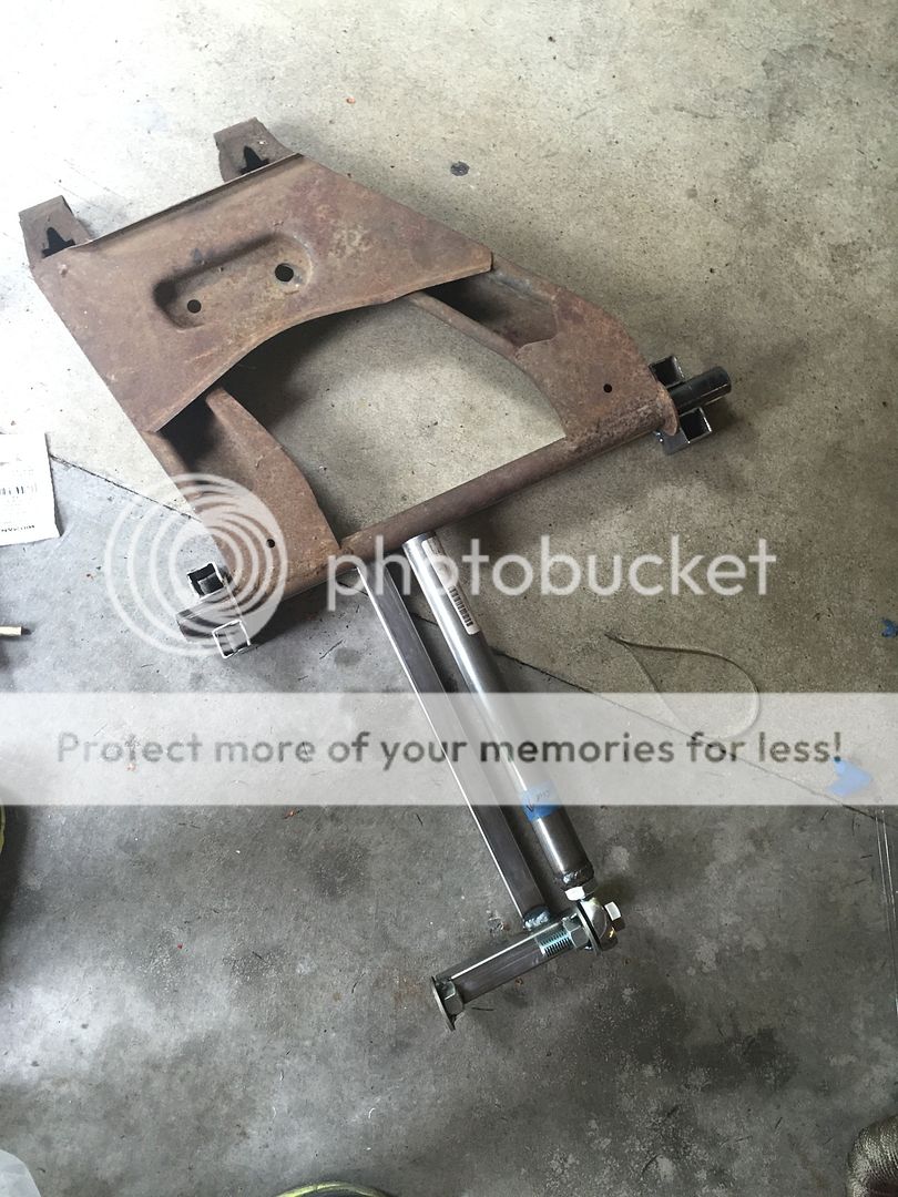

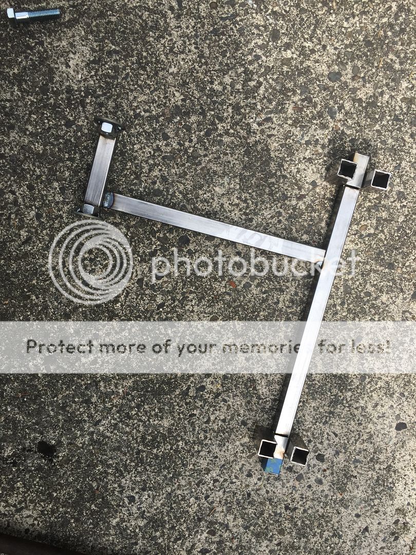

I built a negative off a factory control arm.
A31F9171-1F41-45ED-AE10-1C152239AA51_zps
And with the control arm removed I have a pretty decent starting point.
961BDB58-66CA-42D7-B5AD-21BBB1419153_zps
Started welding my tube adapters to the tubes and making measurements for the cuts.
7367AA4E-A95E-451B-9EA8-C3701FE17A44_zps
I'll have to dig out my tube notcher and chop saw, but hopefully should finish at least the first one next week. After I finish the first one I plan on making alignment points on my jig and measurements to make the second one faster and identical to the first.

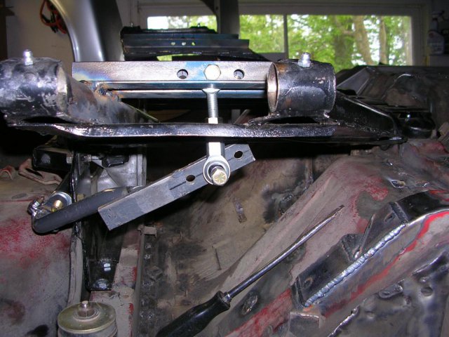

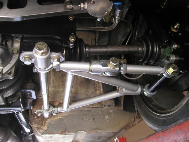

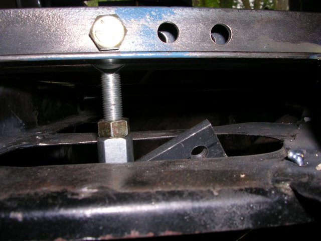

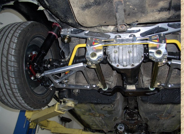

Well, you could get female rod ends and run a stud with poly on the bar side, but what I did was to cut the end of the bar off and then weld on a .25" x 1.25" piece of just plain ol bar stock, then drilled the holes in that to mount the rod end. I had pics of all this stuff when I did it about 10 years ago, but can't find the threads anymore. Here are some of the pictures. None of this is on the car anymore. We did another thread with A-arm and toe link stuff and I redid all of it and decided to run springs stiff enough that I don't need a rear bar. Might still have to adapt one later on, but hoping not to.
