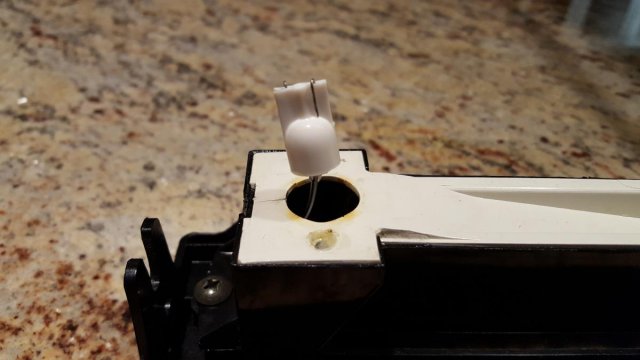

One more detail:
My cigarette lighter socket was not working so I decided to change it for a very similar unit that I found on Ebay from England. Not only does it work perfectly but I also had the option of installing it with an illuminated trim. Very cool and practical.
The best part is you can still use the original lighter itself in that aftermarket socket.

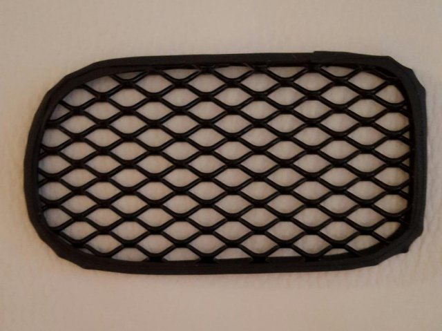

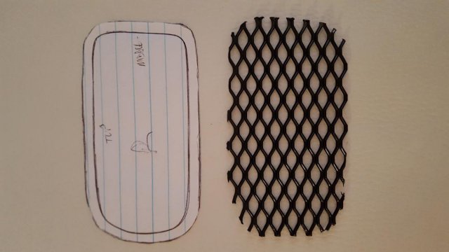

Hey @Spooky_Intentions, it's really not that hard to do an all led conversion on your Z. There are a couple of very good write ups that explain it. Search "Datsun Z led conversion" on Google and you should get some hits. Most of it are just simple bulb swaps.

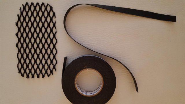

The net pockets are great for your phone, wallet, parking lot tickets, etc. They are simple and very cheap double stick tape add-ons from Ebay. Here's the link for those:
http://www.ebay.com/itm/Universal-Car-Auto-Storage-Mesh-Net-Mobile-Phone-Organizer-Bag-Holder-Pocket-/251869476390?hash=item3aa4973626:g:TggAAOSw~OdVb78g&vxp=mtr

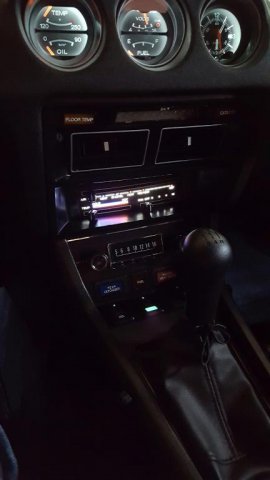

Update on my stereo setup: I wasn't totally satisfied with the underdash location and the quality of those speakers (front) so I trashed those and decided to buy the kick panel speaker pods (from Derek on the sister Classic Z Forum and Ebay) and install a pair of 5.25" Polk Audio coaxials in those pods. I also changed my generic amplifier to an excellent Kenwood unit but placed it similarly under the carpet over the transmission hump. I left the 4" Infinity Kappa coaxials in the stock 280Z position under the quarter windows and the 6x9 Infinity Kappas in the MSA rear deck enclosure acting only as woofers (crossovers and tweeters disconnected). I used soft enclosures around every single speaker. I kept the same Retrosound head unit that I had before but tweaked the faceplate a bit with a textured ABS overlay to look more like the original Datsun faceplate. The remote USB connections are in the glovebox and in the armrest compartment. In conclusion: stereo sounds amazing and it all might pass for OEM (maybe). Pics attached.
