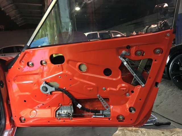

After a long 4 weeks wait the project is moving along again. Had to play with the placement of the power window motors so there would be minimal torsion on the belt mechanism in order to get the best speed in the window movement. The pics show where we finally mounted the motors and that it's almost a straight line to the window crank. I was surprised by how quiet the motors are and the speed is similar to an OEM system. Switches went in the center console behind the shifter.
Attached File  FullSizeRender.jpg   98.83KB   2 downloads

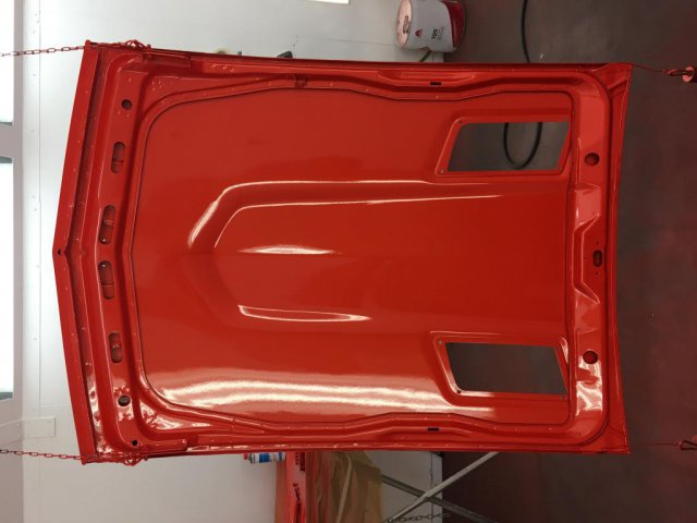

Posted 22 October 2015 - 09:46 AM

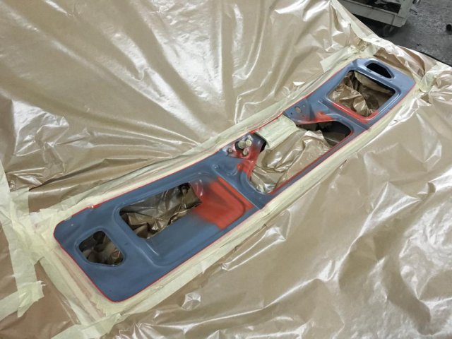

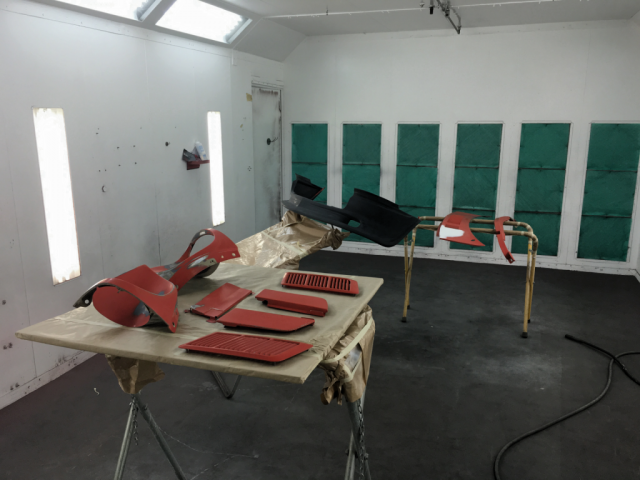

The remaining body pieces that still need painting are prepped and going in the booth today for that shot of orange. Hopefully these will go on the car tomorrow  :wacko: .

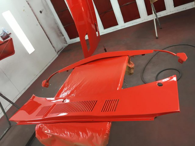

Posted 22 October 2015 - 06:25 PM

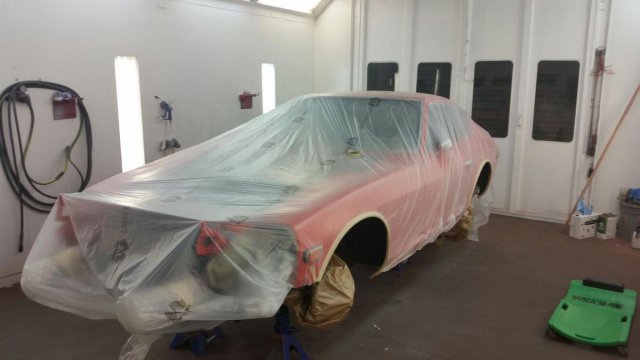

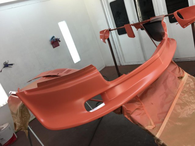

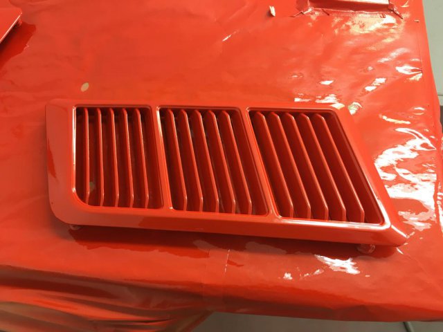

Fresh three stage paint on the remaining body pieces went on today. Took lots of pics just to remember how labor intensive this whole process is BUT it sure is worth it when you see the final result.

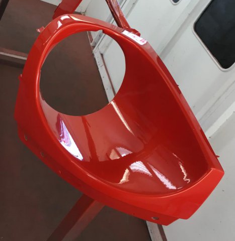

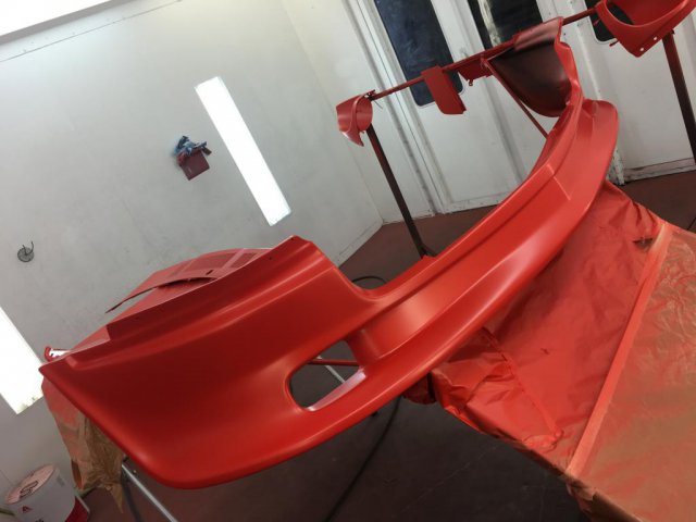

Posted 22 October 2015 - 06:53 PM

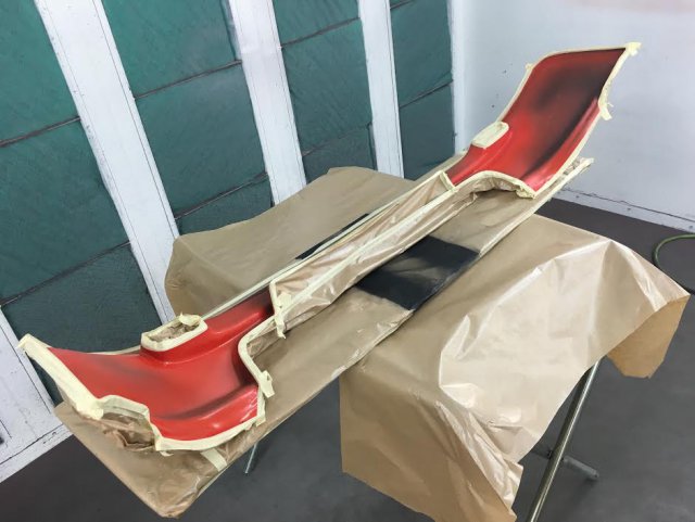

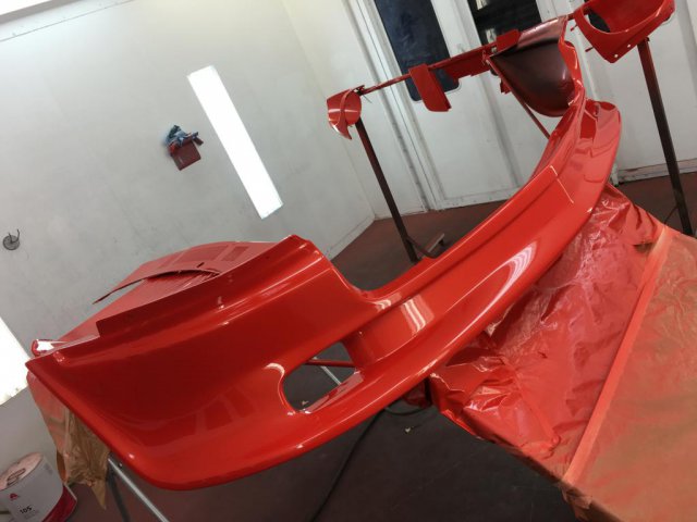

A few more shots of the airdam prep and paint:
Attached File  IMG_0641.JPG   65.02KB   0 downloadsAttached File  IMG_0650.JPG   65.73KB   0 downloadsAttached File  IMG_0669.JPG   64.18KB   0 downloadsAttached File  IMG_0680 (1).JPG   72.38KB   0 downloads

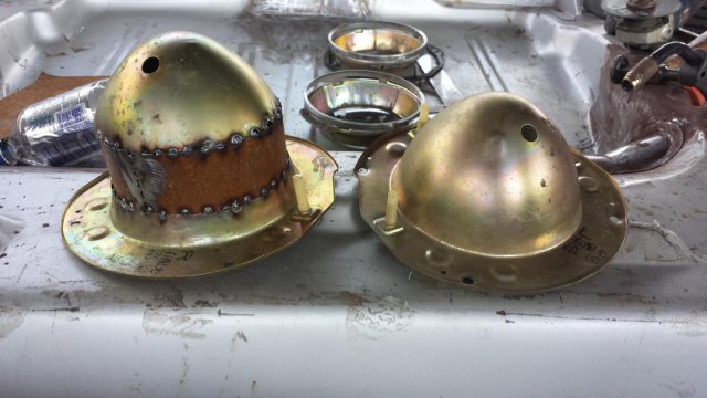

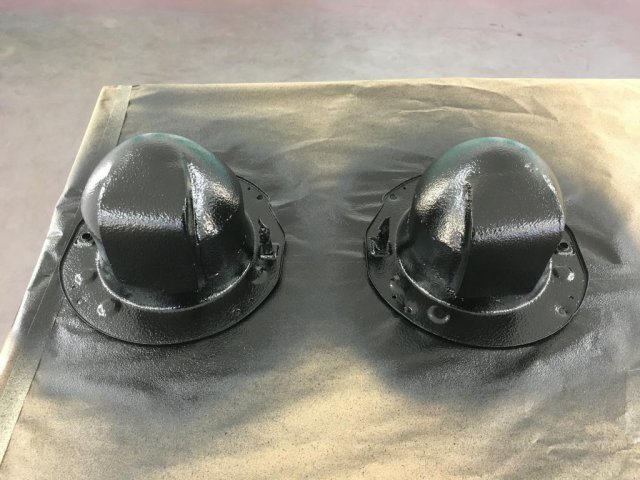

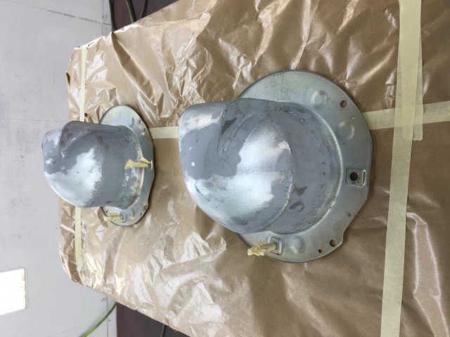

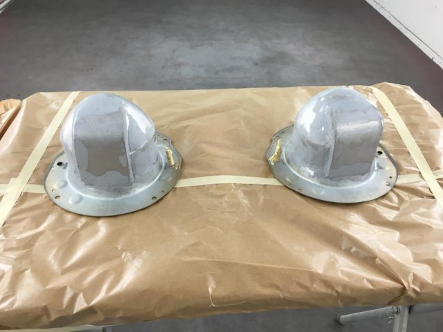

An update on the lengthened headlight bucket mod that we came up with in order to fit the longer LED bulbs and ballasts:
OEM buckets were cut transversely at the base and a 3 inch metal strip was tack welded between the parts. A "pocket"  was created to fit the ballast and tack welded as well:
Attached File  20150724_141359.jpg   101.21KB   1 downloads
The modified buckets were then finished off with All Metal filler, sanded and given a couple of coats of zinc paint:
Attached File  IMG_0601.JPG   72.42KB   0 downloads
and then 2 coats of black undercoating:
Attached File  IMG_0607.JPG   122.07KB   0 downloads
Will update again with final assembly with LED bulbs and headlamps.

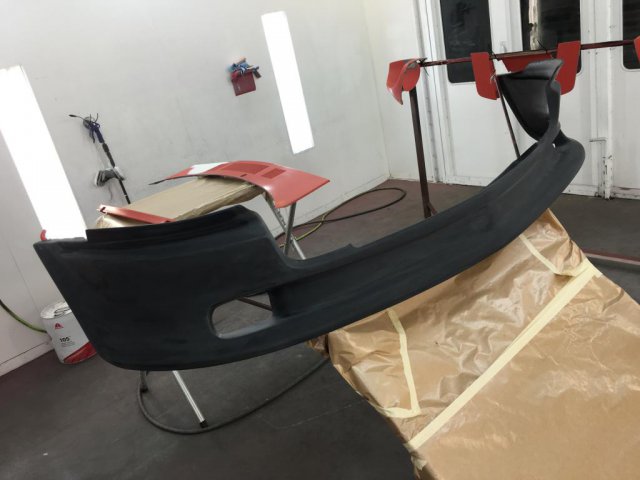

Video of the front air dam freshly painted in Lamborghini's Arancio Argos Pearl. This is a 3 stage process (base color, pearl, clear coat) and coincidentally the base color is virtually identical to the original Datsun 110 code paint.

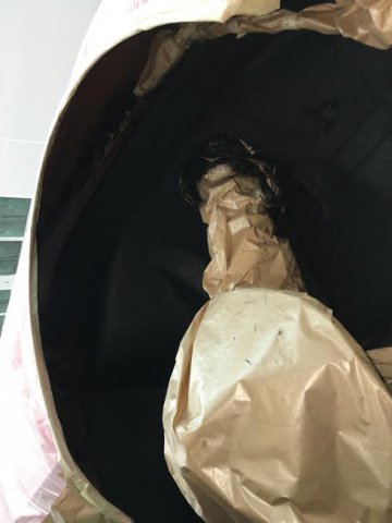

Posted 27 October 2015 - 04:13 PM

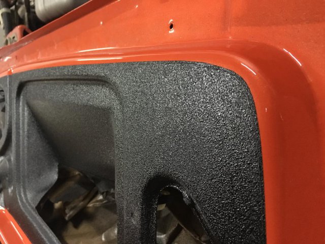

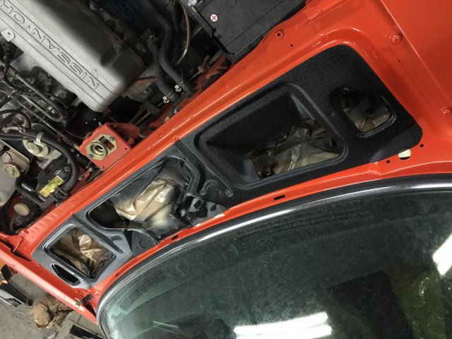

We decided to coat the area underneath the windshield wiper cowl (that was half ass painted grey at the factory) with textured anti-corrosive black. Should give a nice background contrast once the cowl is installed again.

PS: Sorry I can't seem to flip the upside down pic.

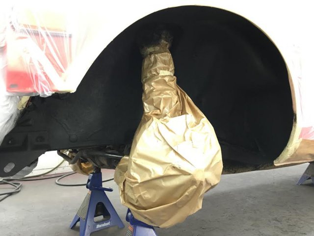

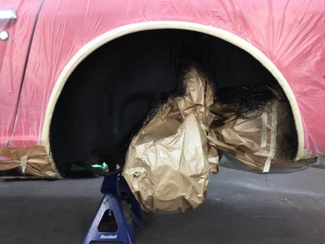

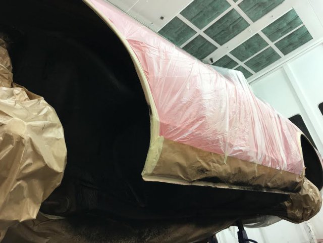

It's been very frustrating waiting for things to happen with my 280Z. The paint shop has been really busy and it seems like they're giving new projects preference over my "old Z". Anyway, the undercoating is finished so the build should advance further this week. I will keep posting.
Attached File  IMG-20151204-WA0006.jpg   63.41KB   0 downloadsAttached File  Undercoating 2.jpg   51.09KB   0 downloadsAttached File  Undercoating 1.jpg   43.25KB   0 downloadsAttached File  Undercoating 3.jpg   52.27KB   0 downloadsAttached File  Undercoating 4.jpg   21.63KB   0 downloads
The materials used for the undercoating was :                                                                                                                                                                 3M Body Schutz Rubberized Coating Black 08864 and 3M™ Scotchgard™ Autobody Coating,7277.
Here are the links for the products:
http://3mcollision.c...black-8864.html
http://3mcollision.c...ating-7277.html
Edited by dmoralesbello, 12 November 2016 - 07:50 AM.

Here's an update on the headlight bucket extension mod that we started a while back but are only now in the process of installing.
A 3"extension was welded in and a "pocket" for the LED  ballast was incorporated into the back of the bucket.
Attached File  20150724_141359.jpg   101.21KB   1 downloadsAttached File  IMG_0601.JPG   72.42KB   0 downloadsAttached File  IMG_0607.JPG   122.07KB   0 downloads
After finishing off with black anticorrosive paint a 0.5" hole was drilled on the engine side of each bucket, fitted with a rubber grommet, the OEM wires were fed through and the LED ballast placed in its pocket and held with 3M double stick trim tape.
Attached File  166a52ce-6f0d-4eda-b58e-bb48a96d0ce8.jpg   46.04KB   0 downloadsAttached File  987e812f-4155-4198-93b7-ae70028a3b01.jpg   41.95KB   0 downloads
The Autopal headliamp with the LED light installed has the cooling fins protruding from the back plus the ballast but fits nicely into the modified extended bucket.
Attached File  2sest-lot-New-Brightest-LED-headlight-4500LM-6500K-H4-LED-Headlight-Bulb-45w-Auto-Led-Headlamp.jpg   188.63KB   0 downloadsAttached File  e501823e-23ea-4aea-af62-d4497b350fb2.jpg   35.35KB   0 downloadsAttached File  9a65536f-a3bc-4ffe-973f-015d45e4ac60.jpg   57.32KB   0 downloadsAttached File  f7e445aa-d8c3-4f70-a9d2-8ef9707a5b18.jpg   45.79KB   0 downloads
The remaining installation is SOP.Attached File  32b1ab16-057e-4bdb-992b-69b62d1efbda.jpg   45.22KB   0 downloadsAttached File  0b362c3d-0212-48aa-9625-ea44b4543873.jpg   76.05KB   0 downloads
The intensity, quality and focus of the light emanating from the LED bulbs is excellent and the final look is very close to stock.
Edited by dmoralesbello, 12 November 2016 - 07:52 AM.

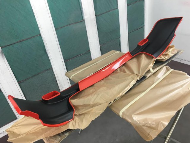

Painted black the inside of the airdam  last night in preparation for installing it today.
Attached File  f93254c9-821a-4a37-9743-9ab7f818b5eb.jpg   58.21KB   0 downloadsAttached File  8b426f92-dfc0-46a0-91da-17976c0d0449.jpg   62.51KB   0 downloads
