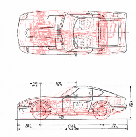

I looked around the internet an did not fine anyone talking about transplanting the complete miata subframe into a s30 body. The miata has a lot more economical suspension and brake options. Sure the motor is not all that powerful but its modern and has some potential. The wheelbase is very close and all you would relay have to do is move the motor mount 1.5" back.
Anyways just some food for thought.

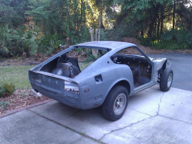

Here is an overlay of the miata with the z in scale and here is what im working with right now for a z body

It's an interesting project but it's not an economical one. Your savings with Miata parts will be offset (by orders of magnitude) by the fabrication costs. As I said, it's interesting.
I have a metal shop at my disposal and a machine shop in the evening that only cost me cold beer to sneak in small things. So... Not as big a deal as it is for most.
The Miata is the better car (I own both). The only advantage I can see for putting the z body on Miata chassis is that you would have room for an inline 6. Can already do v8 in the Miata.
This thread does give me ideas about a z bodied Exocet.
I do not have both but on paper the miata looks to be a better platform and it has a lot of aftermarket performance support. when i look at s30 performance stuff, its expensive and limited.
"z bodied Exocet" That is exactly what got me interested. I will not go so crazy as to hollow out the Z body but i would plan to transfer the mount point from the miata body and then gusset it up just a bit with tube. One cool thing is that the miata is all four wheel double wishbone and if i do a little math i could position the mount point so that the suspension is the correct geometry at whatever ride height i want.
