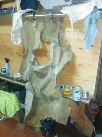

In the process of fixing that, I cleaned the carpet with an anti-mold product, that I sprayed on and brushed in vigorously; that did the job, BUT! I realized that my carpets, after 30 years, were now rather brittle, and the fabric of the carpet ended up ripping if I only looked at it wrong, or for too long.  This is what it looks like now...
I know, it looks more like the skin of a dead animal than anything else..  the rips are bad... and numerous (it's hung like that to dry, from when i cleaned it).

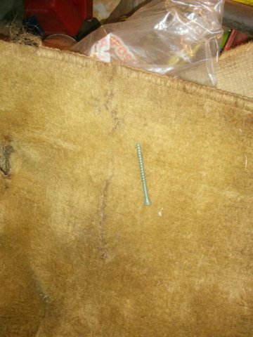

Anyways, I just got around to doing what he'd done, only I tried a test patch.  I wasn't able to find any rubber cement in appropriate quantities, but after some research, I realized that contact cement should do the trick, as it's sturdy and flexible.  Here is the rip that I fixed..

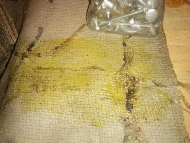

with the glue

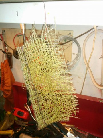

Here is the burlap, covereled in glue too (you can't really see it, but it's there).  To get he glue on the burlap without glueing everyting around, I laid the burlap patch on the rip after I'd painted glue on it (the back of the carpet), and brushed glue on the burlap there;  because I did it while the carpet's glue was fresh, the burlap didn't stick to it.

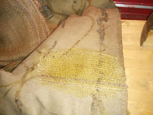

After about 10 mins, as instructed on the glue container, I lined everything up and dropped the burlap on the carpet.  right away, it was solid, but to make certain it was well glued, I used a hammer and basically hammered every inch of the patch(not too hard, but enough to see the burlap getting flattened against the carpet;  the guy in the video had used a big mallet that had a surface of about 4 inches square.  I used a regular carpenter's hammer.  it took a while...). it worked like a charm, and I tried to re-rip rip it: no dice, it's solid.
