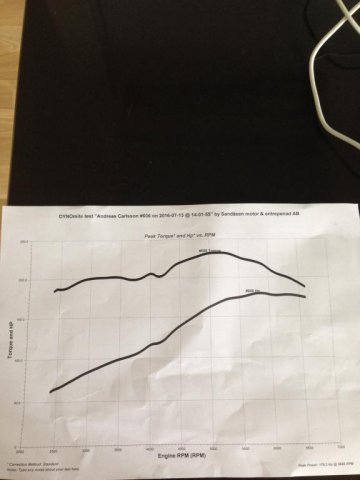

Datsun 240z -73
180 hp/235nm to the wheels.
Have not done a proper tuning but it runs great.
Should be some more power to be had with a good tune.
L28 N42 block and late E88 head
Bored +1mm (0.40 over)
Itm flattop Pistons with Hastings rings.
Head has bigger valves and steel seats like the N42 head and has been shaved to get the chambers to 44cc but no porting has been done.
Msa stage 3 cam kit
Harada shokai intake
Triple Fajs 45s (weber copy's)
Msa 6-1 header and 2 1/2" system
Zx dizzy and Msd 6025 box
Cr should be at 10 and runs pump fuel (95 or 98 oct here)
R200 3:9 and zx 5 speed boxpost-32020-0-41456500-1472897339_thumb.jpeg
