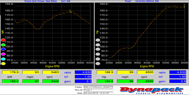

It's not that aggressive on duration - .540" lift and 270 duration, with a 109degree lobe center.
Nice, that's the same cam I use in my NA L28 (Isky L6 grind). :)

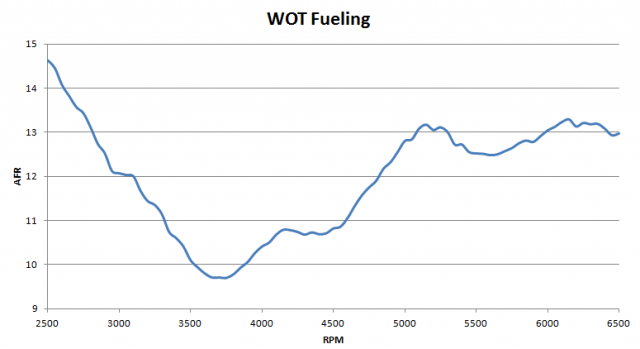

I could use more duration as my power peaks at 6000RPM. The torque tip is due to the crappy F11 emulsion tube, planning to tune that out in the coming months.

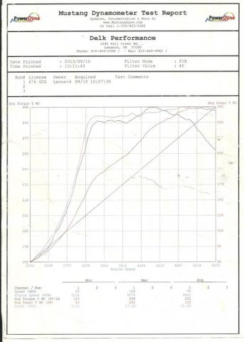

Here's what I have:
1978 280z
Rebello Racing 3.2L Stroker
N42 block N42 head
Ported stock intake
360CC Injectors
60mm throtlebody
Pace Setter header 3-2-1
Adaptronics ECU
Z32 Trans (Hoke Adapter)
Infinity Diff 3:69
T3 Susp.
Impressive especially NA with a nearly stock induction. Who says you can't get any power from a N42 intake. You could only get maybe 32mm runner ID?
Share this post
Thanks madkaw! Rebello wanted to do the triple weber setup, which would have given me about 50 more hp but I just wanted the fuel injection.
I don't remember what the ID was but they did cut the intake wide open to do it.

Are these crank or wheel?
This is crank. I wish it was at the wheel.
