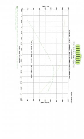

51 minutes ago, supernova_6969 said:
Hey nismospek.
Thanks for sharing indeed.
Seems like the engine is at least as good as when it left the factory.   Has it even been rebuilt?
Performance looks pretty good, especially at 5000+ feet.
Thanks again!
FWIW, looks like there's a 25% correction factor applied in an attempt to adjust for the altitude. Motor seems either tired or out of tune to me. Start with the basics: valve adjustment, timing, compression check, fuel mixture (dyno shop should've output that). Make sure ignition system is in good shape, e.g. cap, rotor, wires, plugs, and properly functioning advance.

Hi leon.
Are you saying that the loss of power should be corrected/compensated for in the dyno chart and thus the numbers should be higher?
I might need to brush up on my numbers, but isn't 115 hp and 133lbs/ft at the wheel relatively normal for a stock engine?  This is an honest question, not an rebuke...
S.

The power is already corrected, according to the chart. A dynojet+25% correction is telling me that there's something left on the table.
