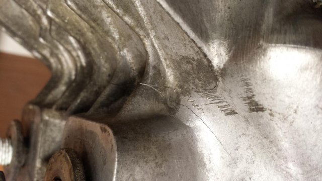

R200 billet diff cover
I have swapped covers on a Q45 with an R200 that came out of a Z. Can you tell me what you are referring to? The only thing I have ever seen different is the provisions for the speed sensors on the Q diff. Obvoiusly, since this is a Z forum, the covers won't have those.

I think the reason there isn't one already available is because it can't be done for that price. The problem is the chunk of aluminum needed to make the billet cover costs $350 by itself. Adding bosses and or different stud spacing is not a big deal and I'm sure can be done without additional cost.

Rags, Have you considered sending a cover to Derek to be 3D Scanned and then recast out of 356 Aluminium? He could add strength in the areas needed.
Additionally, besides me does anybody else have one of those covers  set up for the OEM differential cooler as found on the S130's, Z31's, etc found in Europe?
Screened oil pickup for differential cooler pump and return fittings? Billet opens up the possibility to move those outlets around a bit to better suit retrofits...
