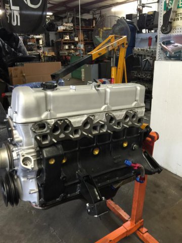

So if you have followed my son's build blog on here you know we hurt the motor last year. He is tooquick260 on here.

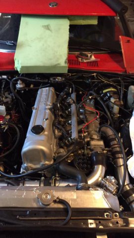

We had the motor rebuilt, installed, plumbed and wired the motor. Fired it last weekend. Lucky fired right up once we got oil pressure. Of course with oil pressure the oil cooler lines decided to leak and we had an exhaust leak. So working on that. I live 300 miles away and will be back next weekend to finish everything.
Question? Do I need the engine breather pipe?
The builder of the motor removed the engine vent pipe, installed a freeze plug.
I know building my air cooled vw motors I ran breather box that had the motor vented to the valve covers. Used the Clyde Berg designed one that was an oil filler that had baffles.
So do I need to remove freeze plug , reinstall pipe and vent it?
L28 motor, P90 head , Schneider cam, 8.2 to 1 compression, 280zx turbo, MS3PRO megasquirt,500cc injectors, 6 speed S-15 tranny, Z32 rear diff and brakes.
I'm not sure I'd be happy with a builder that sealed up the breather hole with a frost plug. No doubt your research has uncovered that the breather performs a critical function and must at the very least be left open to atmosphere though should be properly vented through a PCV valve to the intact.
It would be interesting to hear the builder's rationale.  Confused maybe?  Or maybe he knows something.  Who is it?

The guy that did the work has done a lot of L series build. I will talk to him on Monday. Machine shop in Orlando. Family business in Orlando. Dover Cylinder Head.
I have a fast breather tank that I can plumb in. I could run the valve cover vent and the crank vent to it. I also have an additional bung welded to the oil pan. I could drain any over flow back there.
