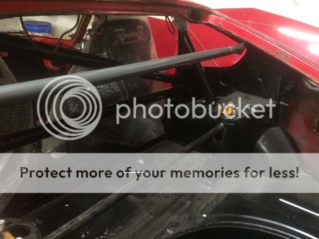

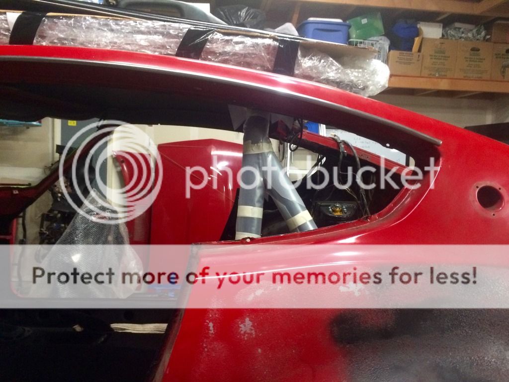

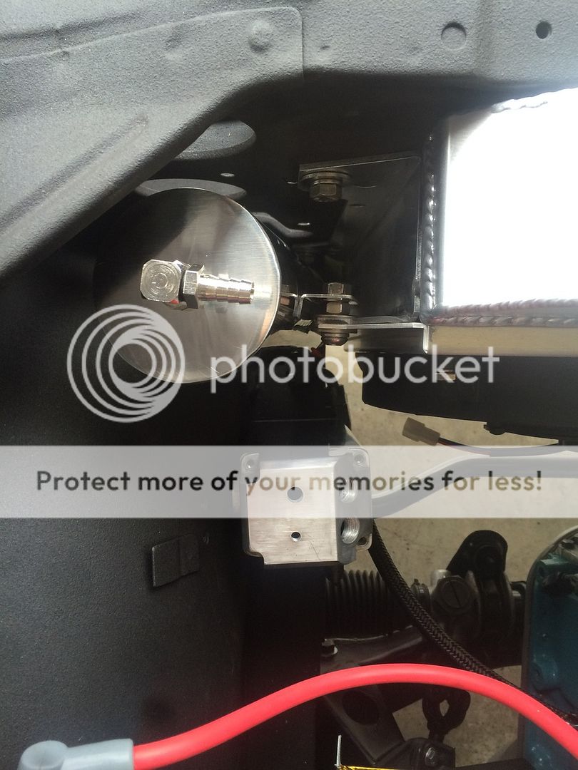

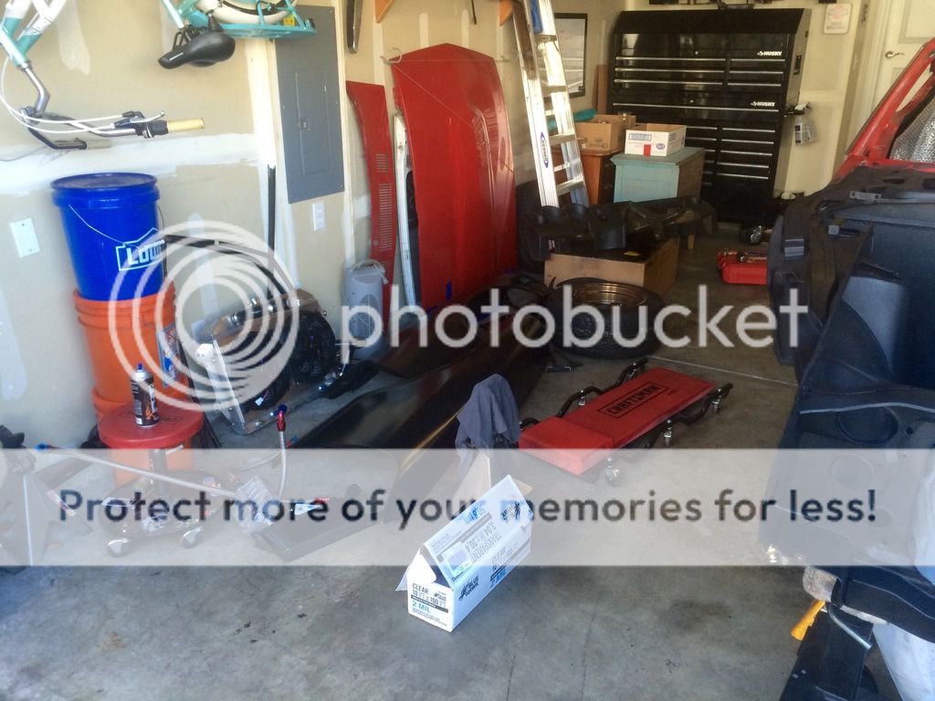

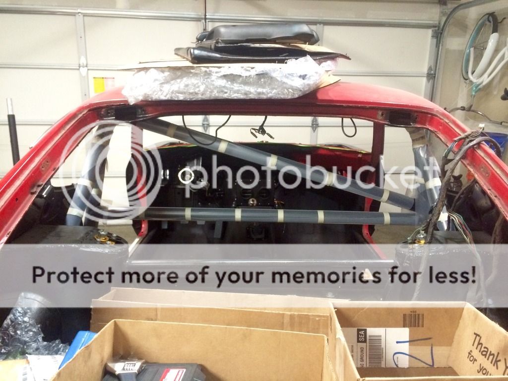

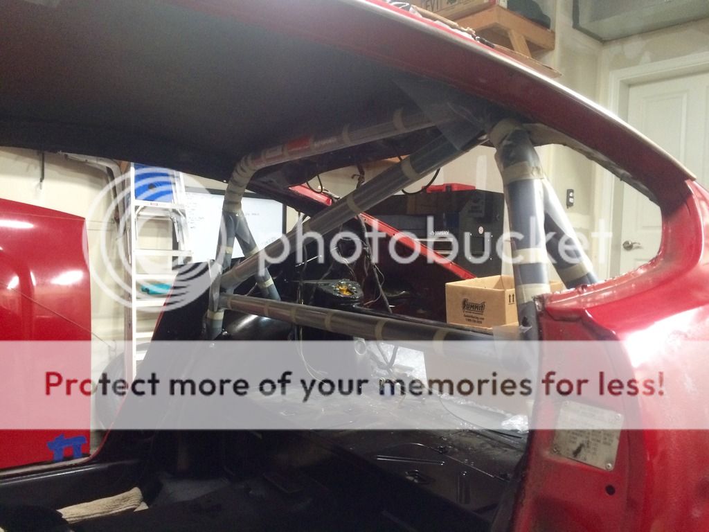

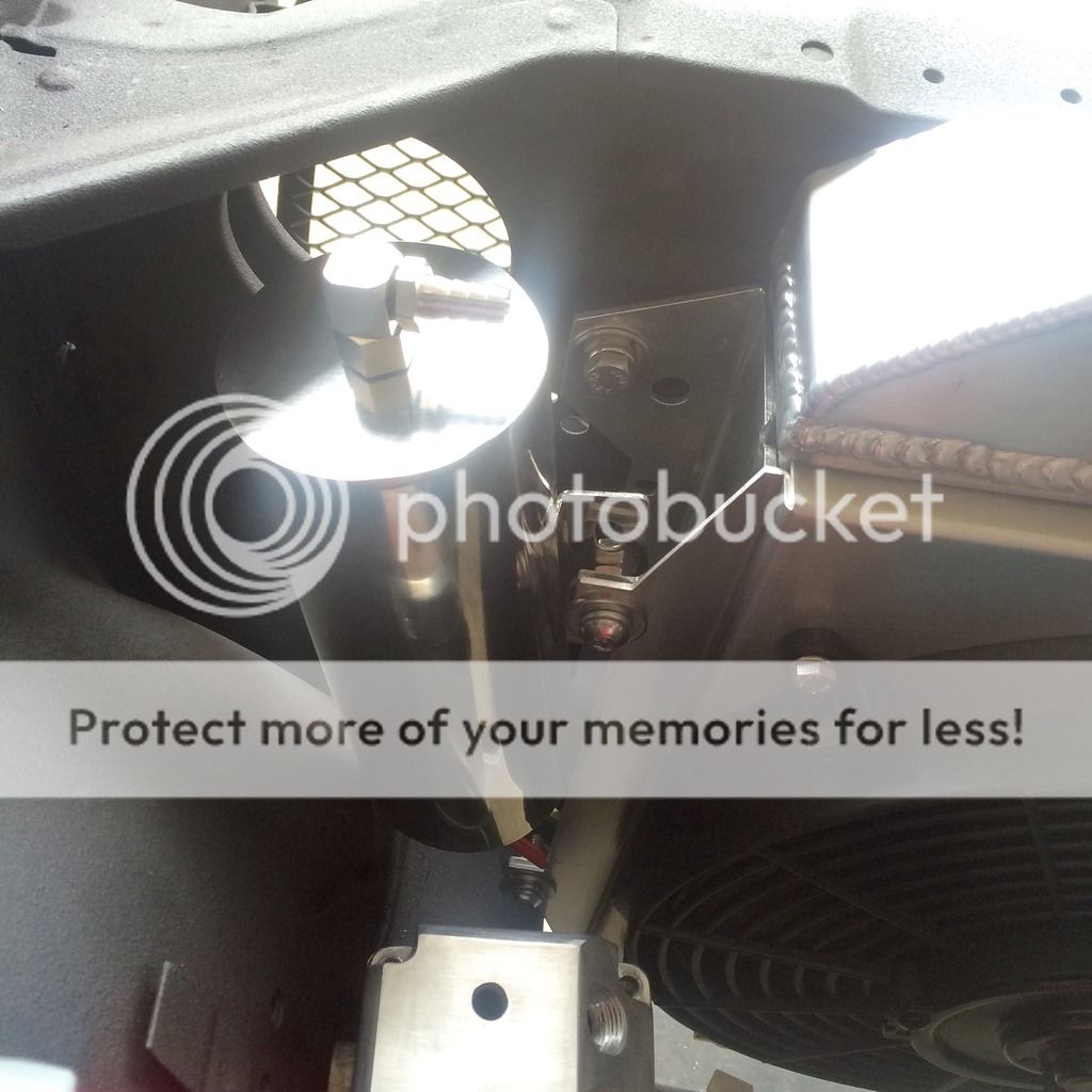

Did a few things over the weekend. Got the coolant overflow can mounted (super tight fit), and test fit the roll bar.

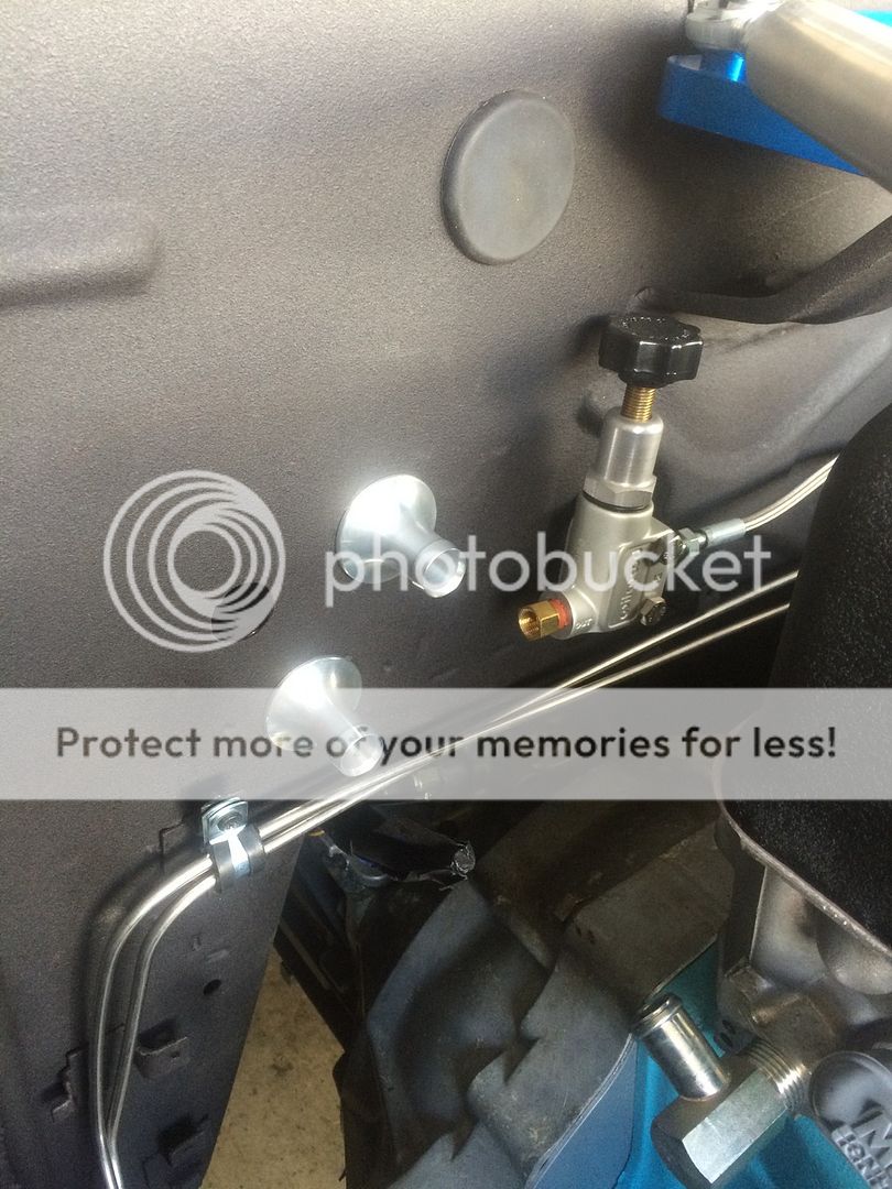

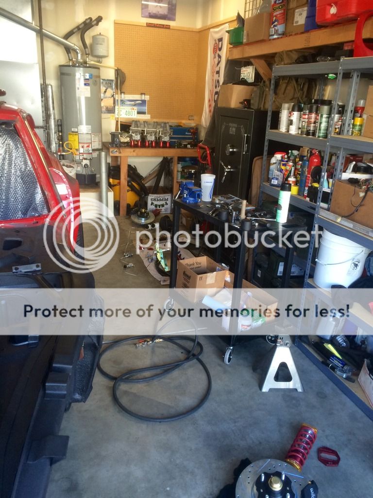

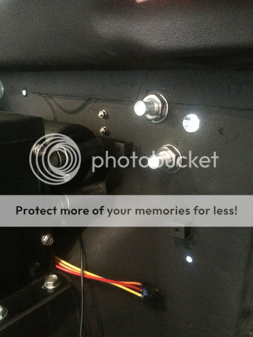

Got my bulkhead fittings in yesterday for the heater hoses, now just waiting on my silicone heater hose to show up to finish plumbing it.

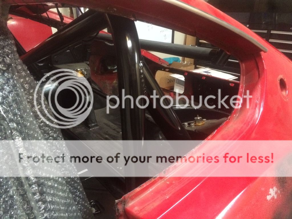

Also got my C pillar bar from T3, that and the roll bar are getting powder coated white to go against the black interior.
12BEEC9E-B25F-4437-B57E-C553F3A99EFB_zps90D090D5-8AD1-475E-9B60-DB7C0677FF55_zpsEBF99667-5BB1-477E-829D-E957D6AD618C_zps

silly question but how exactly is the c pillar bar connected?
#46 73Fairlady
73Fairlady
    Regular
  • Members
  • PipPipPip
  • 74 posts
  • LocationSeattle, Wa
Posted 17 March 2016 - 06:18 AM
it mounts to the factory upper seat belt mounts

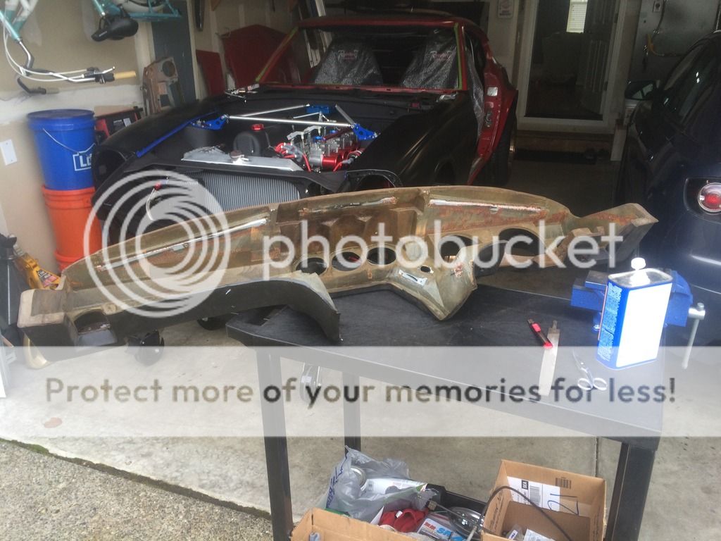

Posted 21 March 2016 - 04:29 AM

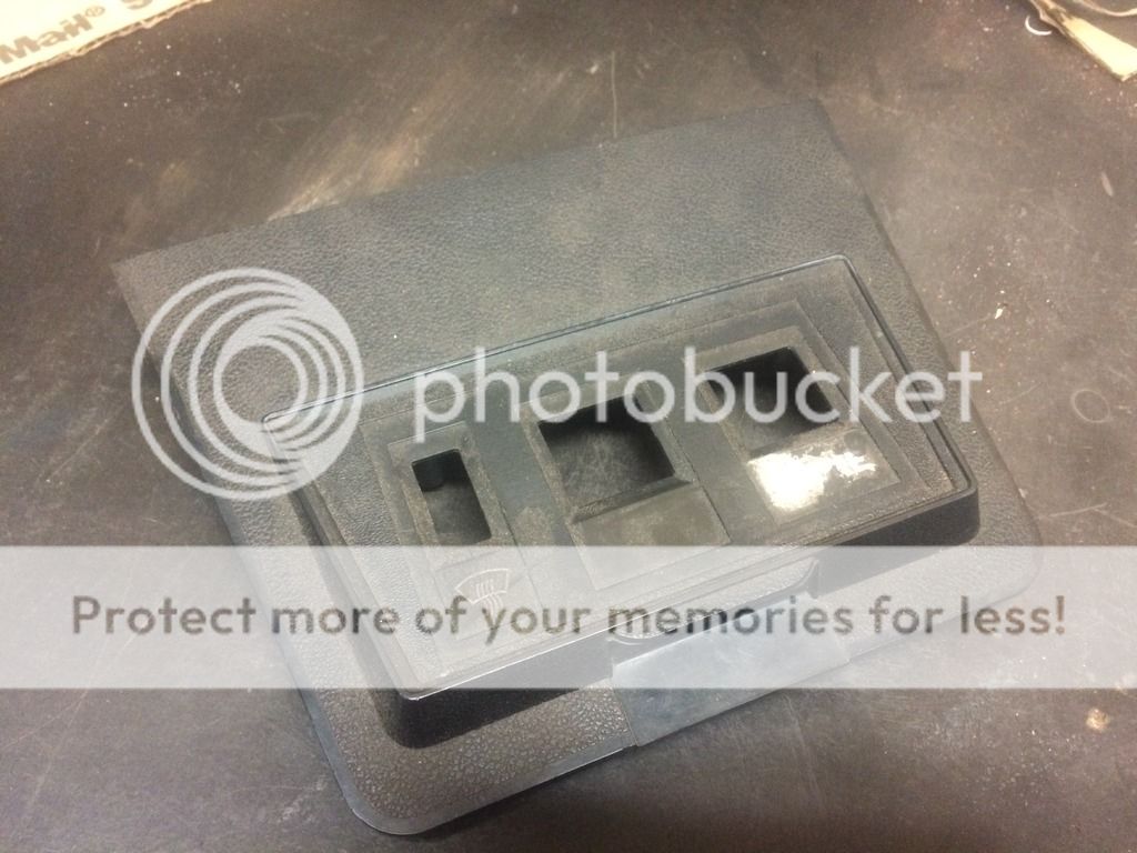

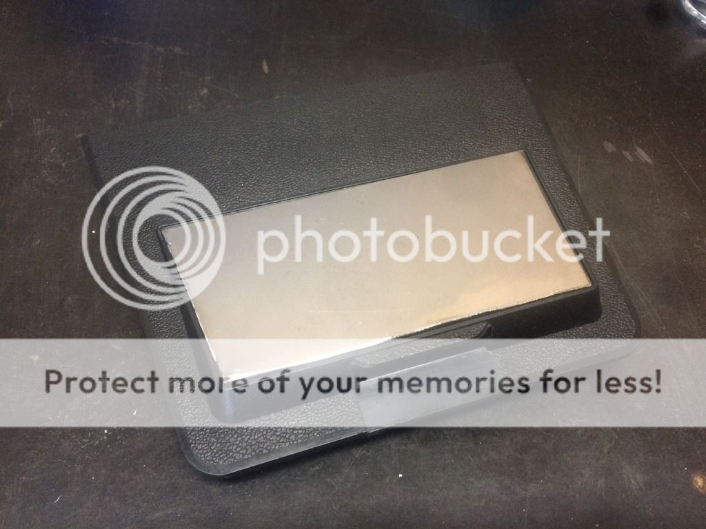

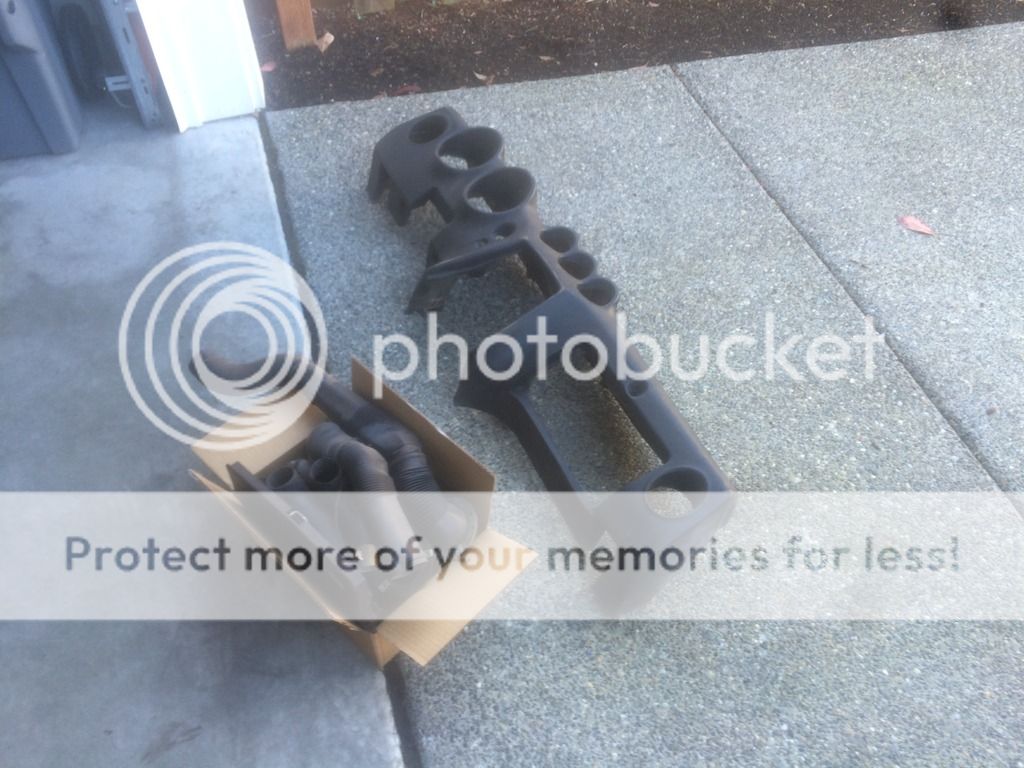

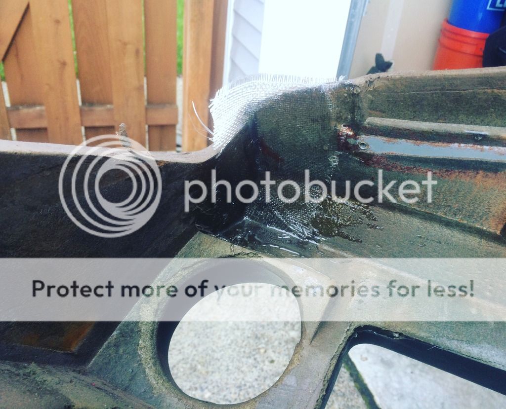

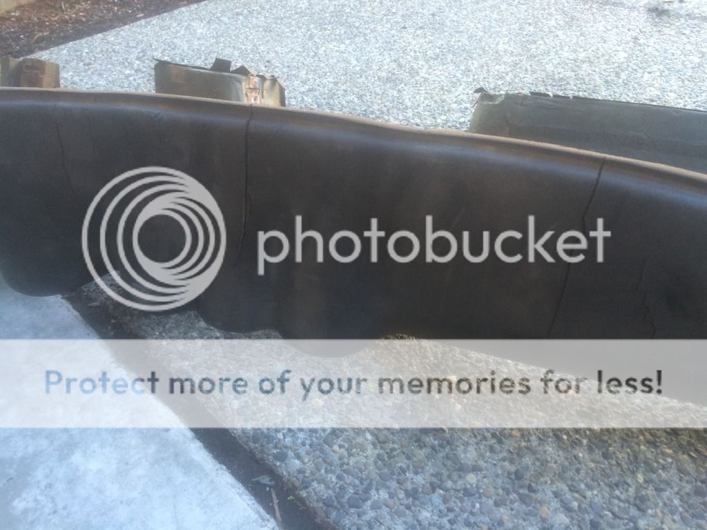

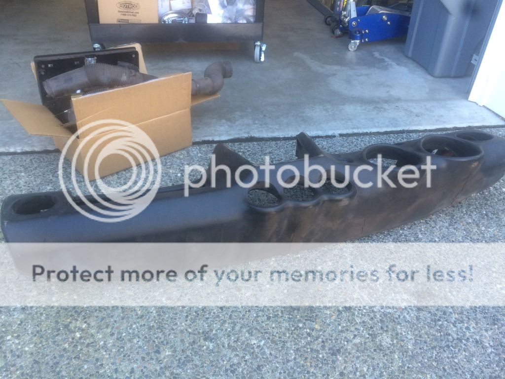

started working on the dash this weekend. Its in pretty bad shape, and there was a leak so the pad had to be separated from the frame so i could get all the surface rust off and paint it. I started by fiberglass reinforcing the corners of the pad where it was starting to crack, ill get all the cracks filled and the frame painted and get them back together for texture and paint. I also started working on the center console, repairing the cracks and doing a little modification to the fuse box cover.

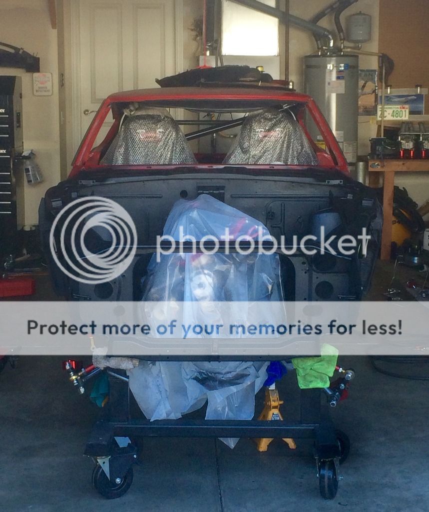

Posted 28 March 2016 - 08:43 AM

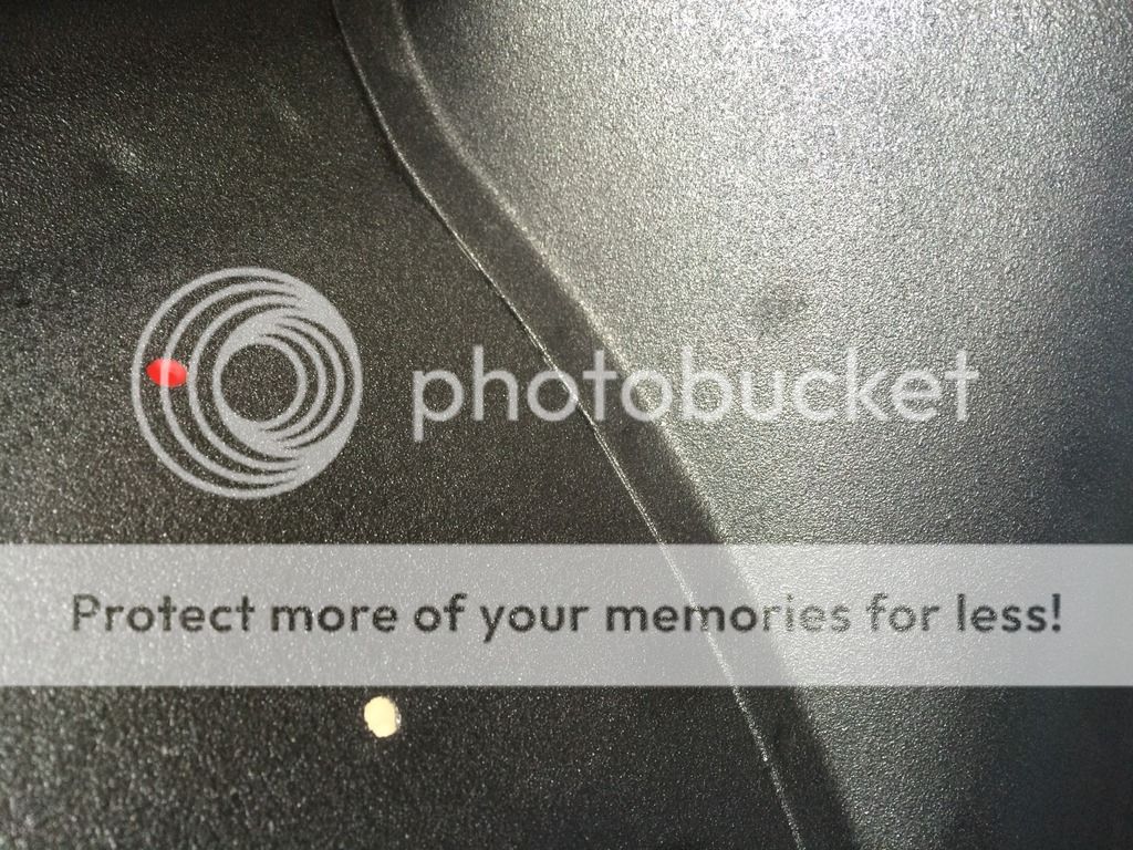

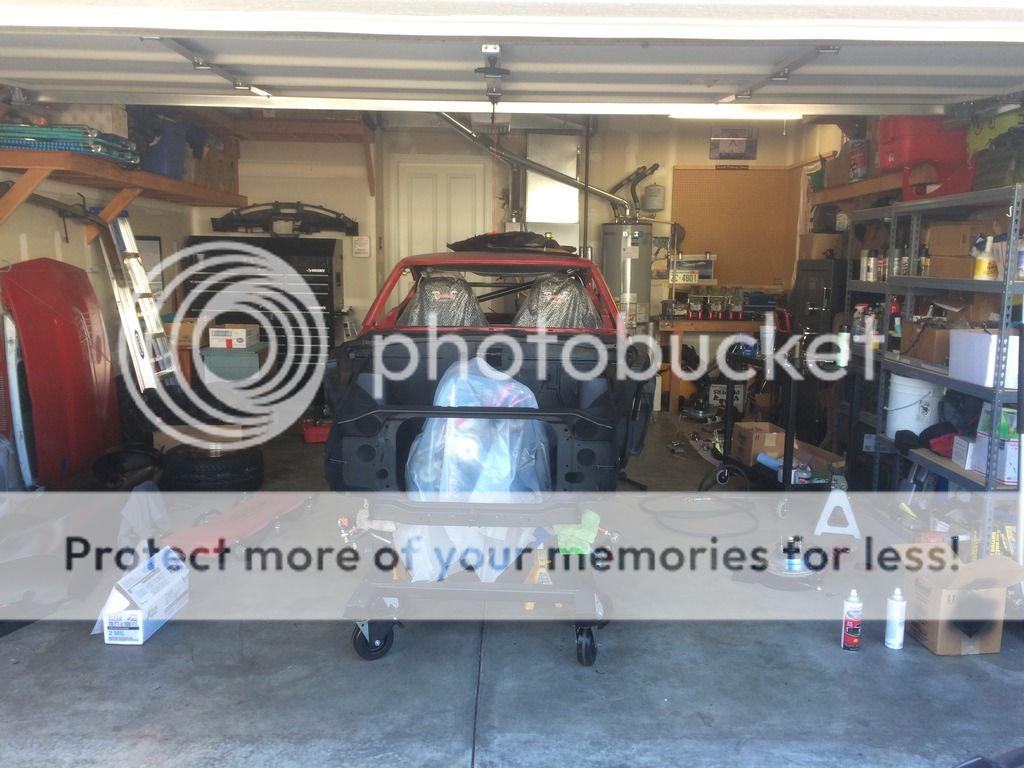

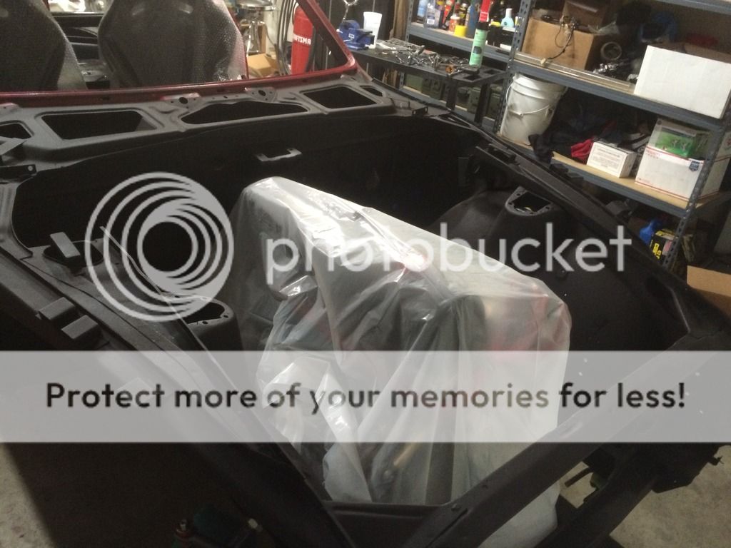

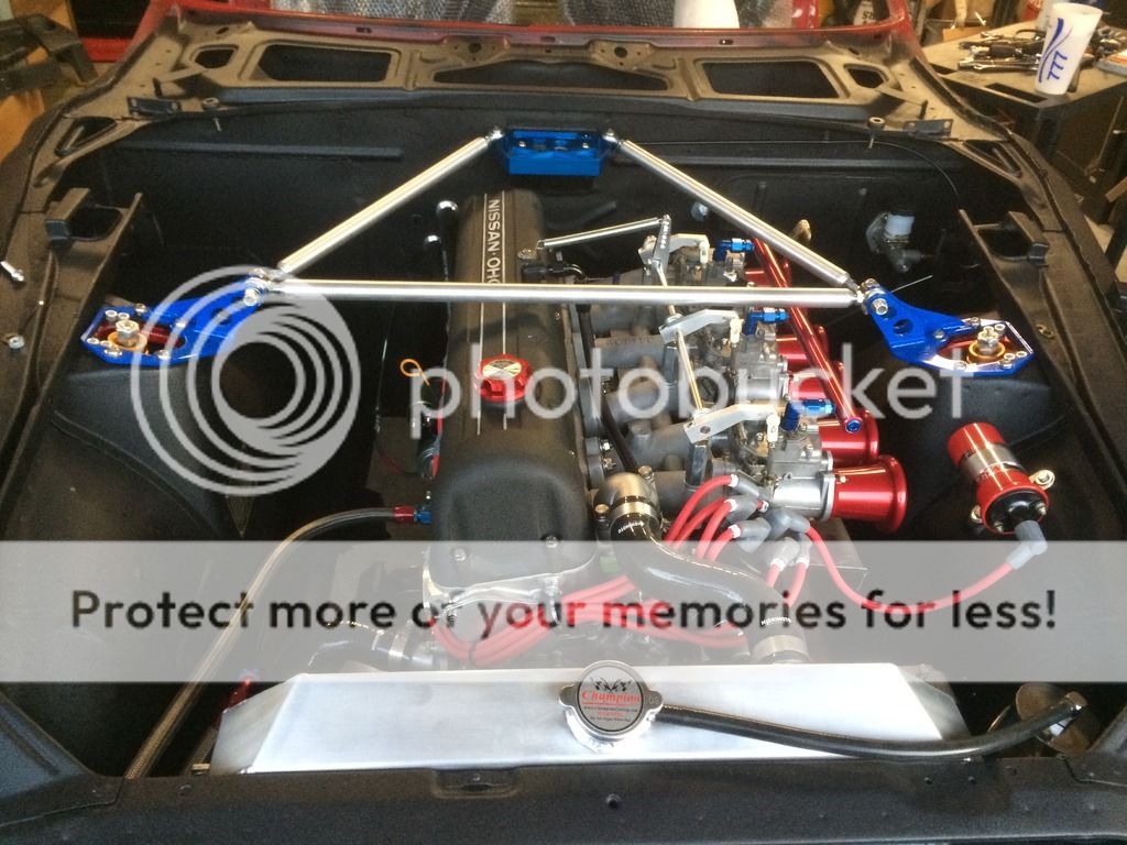

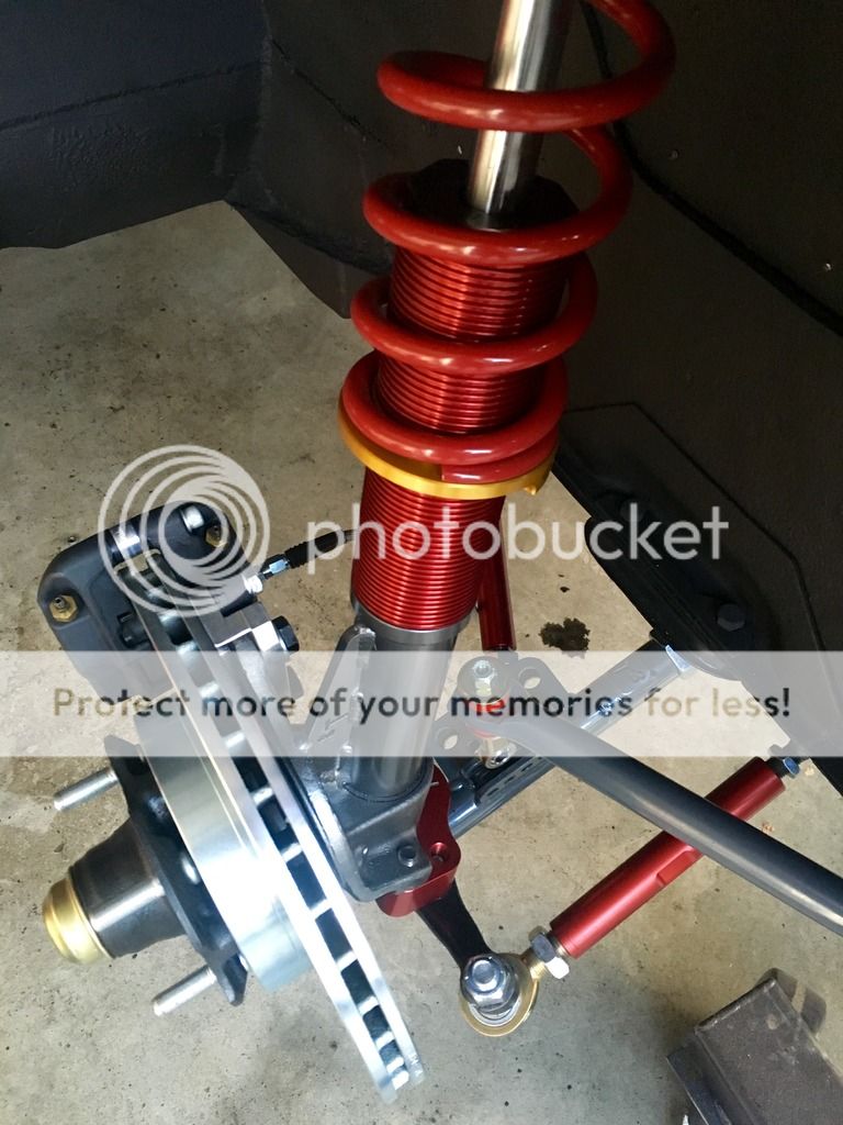

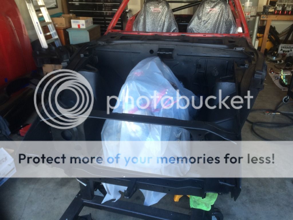

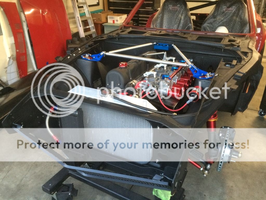

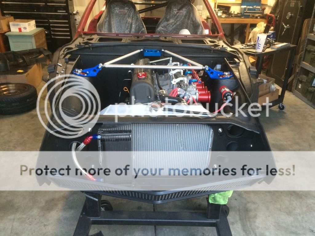

so had a small setback over the weekend. decided I was not happy with the undercoat in the engine bay. i stripped it (other then motor/trans) and cleaned up and repainted with bed liner. looks and feels way better. I'm giving it a few days to cure then will be reassembling and finishing setting suspension this week.

Really digging the seats. I'm actually in the process of doing my engine bay similar to yours. I have been thinking of coating mine with this http://www.eastwood....parent_id=26929
How rough is the texture of the bed liner?
Posted Image
#58 73Fairlady
73Fairlady
    Regular
  • Members
  • PipPipPip
  • 74 posts

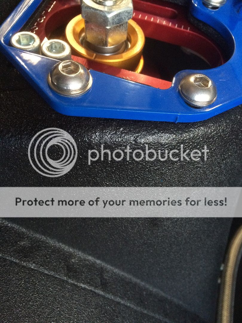

Posted 29 March 2016 - 04:37 AM
I don't know if you can really tell from the picture, but its pretty rough. I like it though, that was what i was going for was the wrinkle/rough finish. I'm sure the Eastwood will be better then the rustoleum, Ive always heard really good things about there products.

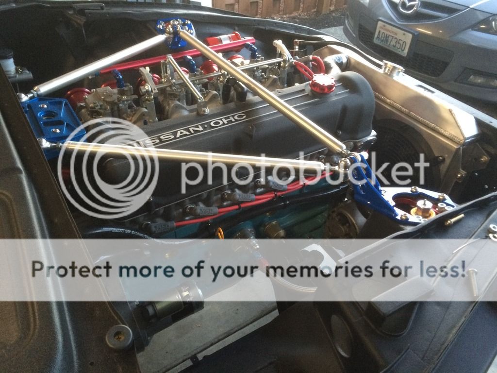

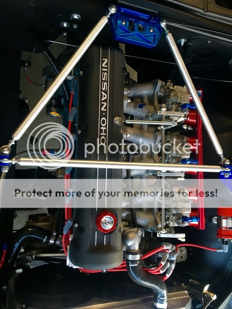

well got most of the car back together, looks better and its defiantly more durable just hitting it with tools.
