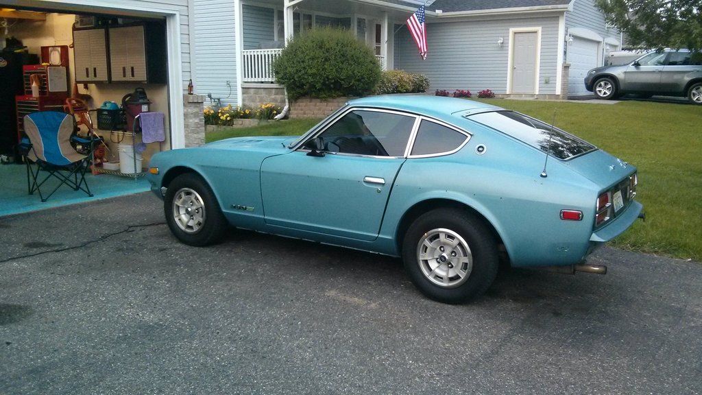

For many years I've been intrigued by the 70's z car's that I'd rarely see in the upper midwest.  It was a rare occurance you'd catch one driving and I was always aroused by how small and sleek they looked.  I started my search to find a project z over a year ago and could find nothing but cancerous crap up here in the salty winters we have.
I expanded my search and felt that a field trip was bound to happen to get a solid car.  I ended up talking with a nice older gentlman from Seattle (Kent) Washington that had an all original car that he had owned and maintained meticulously since 1990.  After talking for about a week, I decided that was a car worth purchasing.  I flew out to Seattle in June and took a chance at driving a 37 year old car on a 1,700 mile trip back to Minnesota.
And so the journey begins....For those who are intrigued by pictures, my photobucket link is below:
http://s176.photobucket.com/user/StockCarMafia/library/LS2%20280Z?sort=3&page=1
I made it back with no issues.

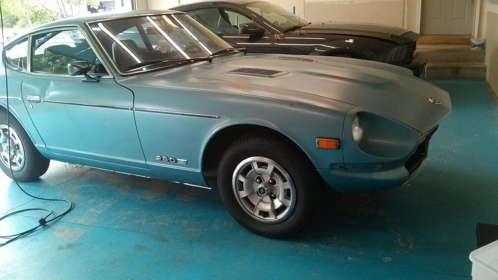

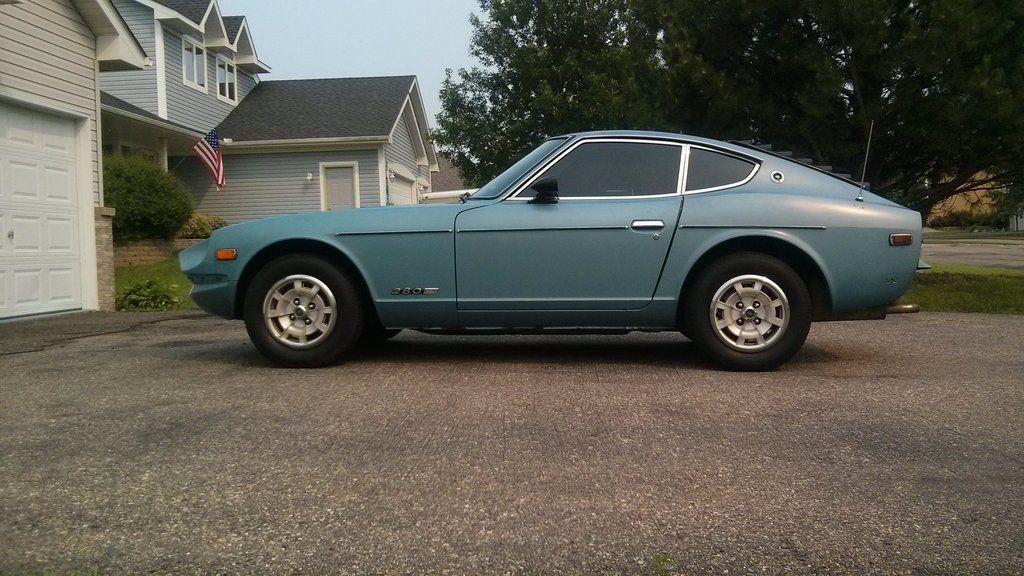

The interior is in great shape with the typical fading of the black carpet.  The dash has no cracks and the driver seat has a small tear.  The body has been repainted but it was a quick spray with no bondo used.  It is really faded and flaking off in some spots.

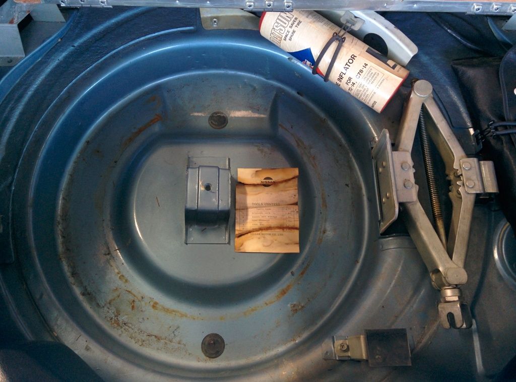

The only signs of rust on the car is one spot in the back hatch area, where I assumed water was sitting and then in the battery tray as well.
After the long trip, it definitely needed a bath!

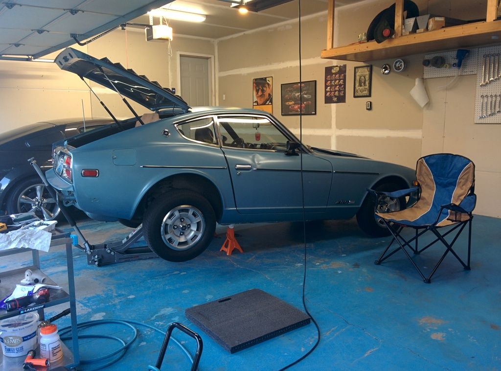

As I've been quite busy with some life changes, I've spent the last couple months collecting information on my ideas for what kind of build I am looking at doing.  I'll slowly add the progress of the build up to today.  The build will be around an LS2/T56 pull out of a 2005 GTO.
Share this post

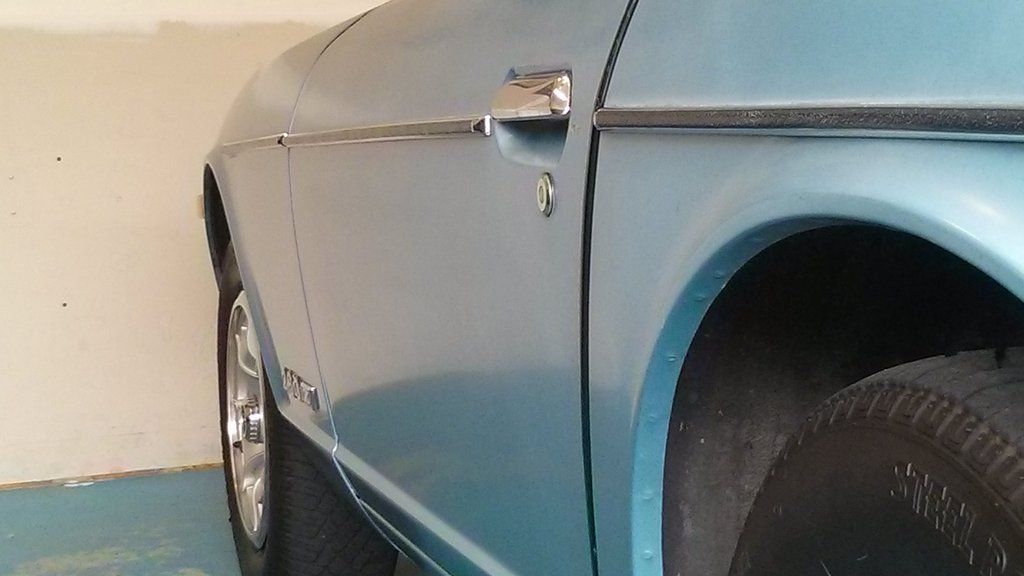

He had it garaged. I'm sure it sat out here and there, hence the rust in the back hatch portion. I can manage with the one dent on the passenger door for now.
The underneath just has surface rust but the undercoating is in good shape.

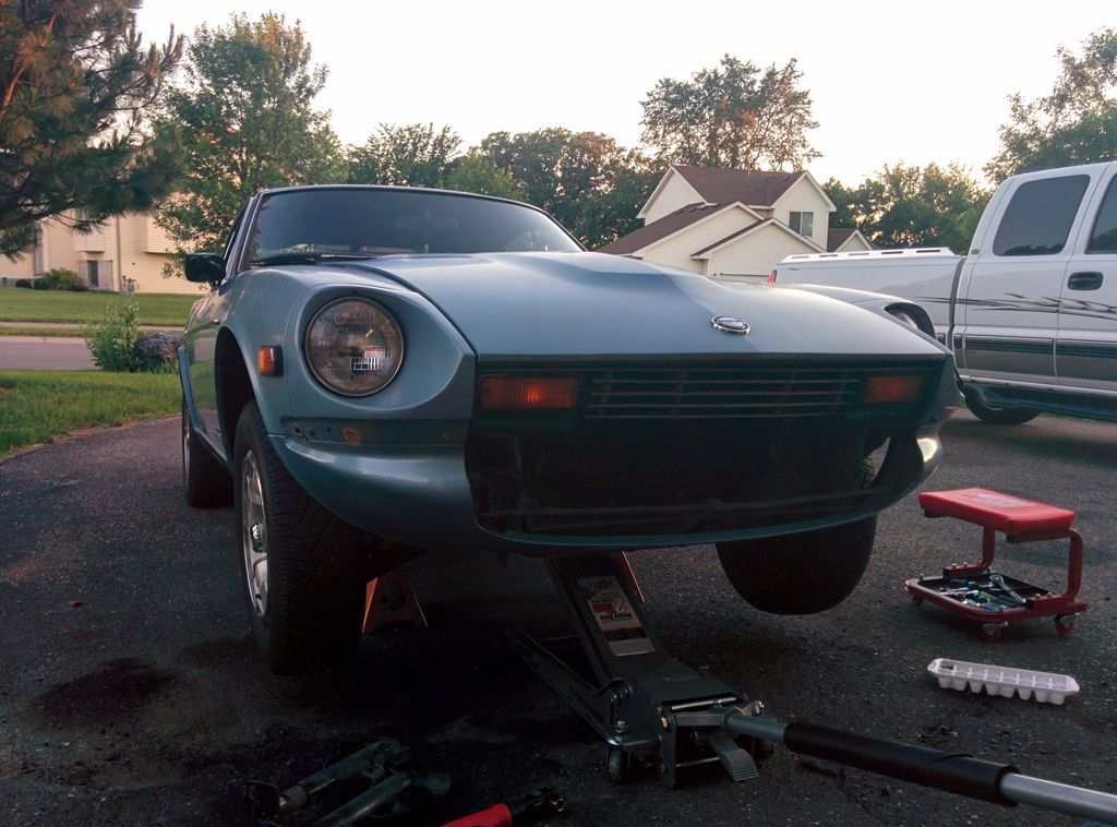

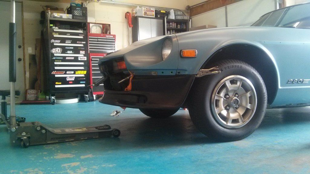

I have the ground control weld in coil over kit going in at some point. We will see how dreaded those spindle pins are then!
Share this post
Start soaking them in penetrating oil now, especially the locking pin. Look into a spindle pin puller, and use 5/8" bolts in place of the spindle pins when you reassemble. I think you should keep those stock wheel covers. I agree with the coilovers, but keep those wheels! That car is righteous.
Share this post
Keith, I've soaked them a few times over the last month and will continue to do so.  Does anyone sell that spindle pin puller still today?  I have an air hammer that I planned on using if I can't get them out.  I'll have to dig and see if there is a write up on those 5/8" bolts for replacements.  I take it, its not worth buying a second set of spindle pins?
Share this post
The spindle pins are a bitch every time. I haven't done the 5/8" conversion but rumor. Has it that it is much easier to deal with. I don't have a link, but I'm certain we have discussed it. I have used a spindle puller and I've done the hammer-cut-torch-hammer thing. You might get lucky. There used to be a spindle pin puller rental here. Been a while. Try searching the suspension FAQs and the Vendor sub forums. Might find it there. I put antiseize on mine liberally before reassembly. Next time one side was easy, one side was still a bitch.
Share this post

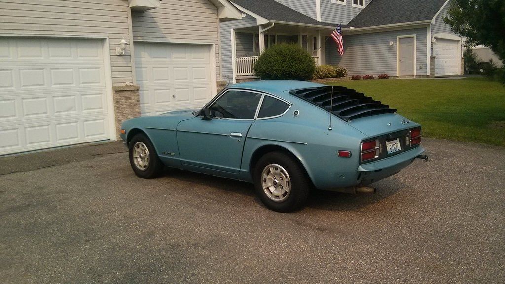

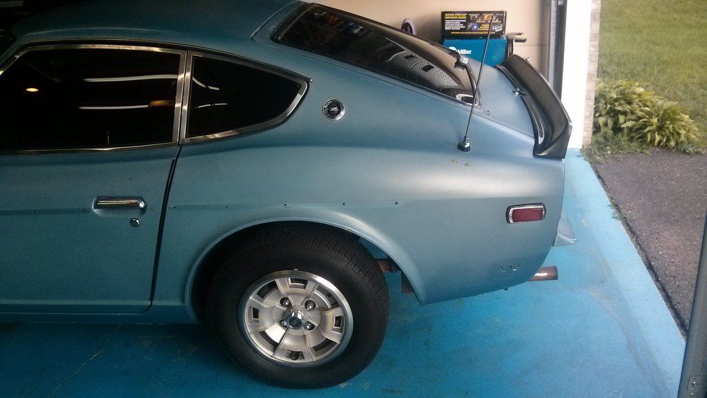

Since I'm "sensitive" to sunlight, I tinted the windows to 30%.  In MN, I needed to get a tint prescription to go lower than 50%.
The louvers will be coming off.
Since plastidip is extremely cheap, I like to play around with it :)
We also removed all the side moulding on the car.  Many were small screws, but there were a few rivets that had to be drilled out.  Which form was from factory?

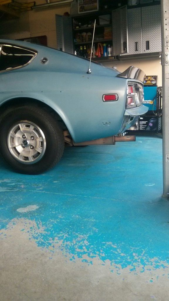

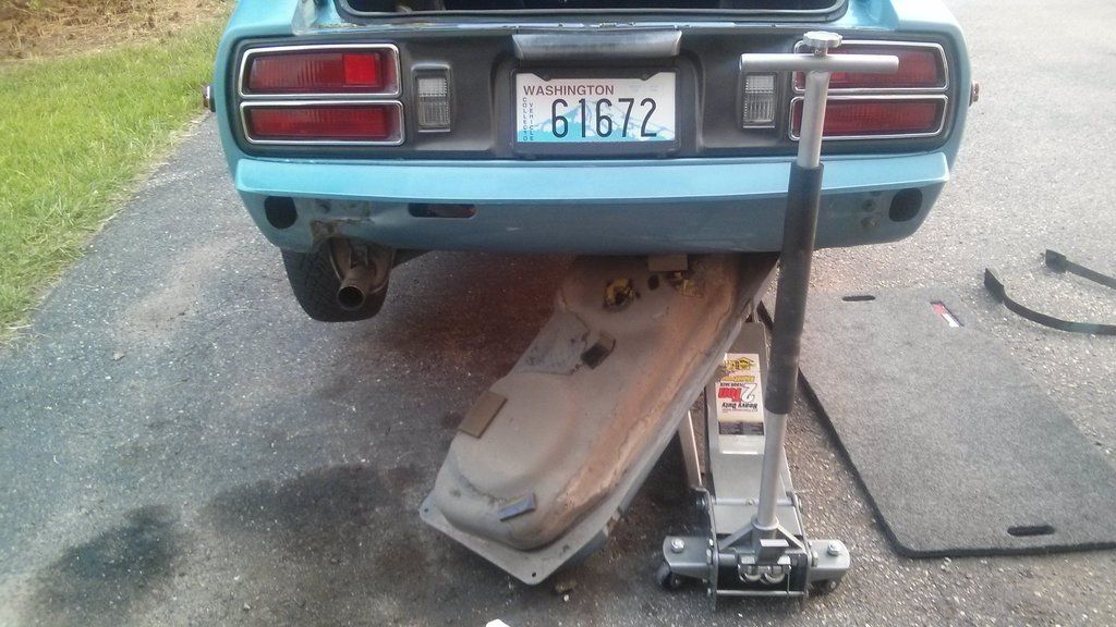

I finally dropped the gas tank and get the last rear bumper mount removed.  For now, I RTV'ed pennies over the holes until it get permanently fixed later.  :huh:

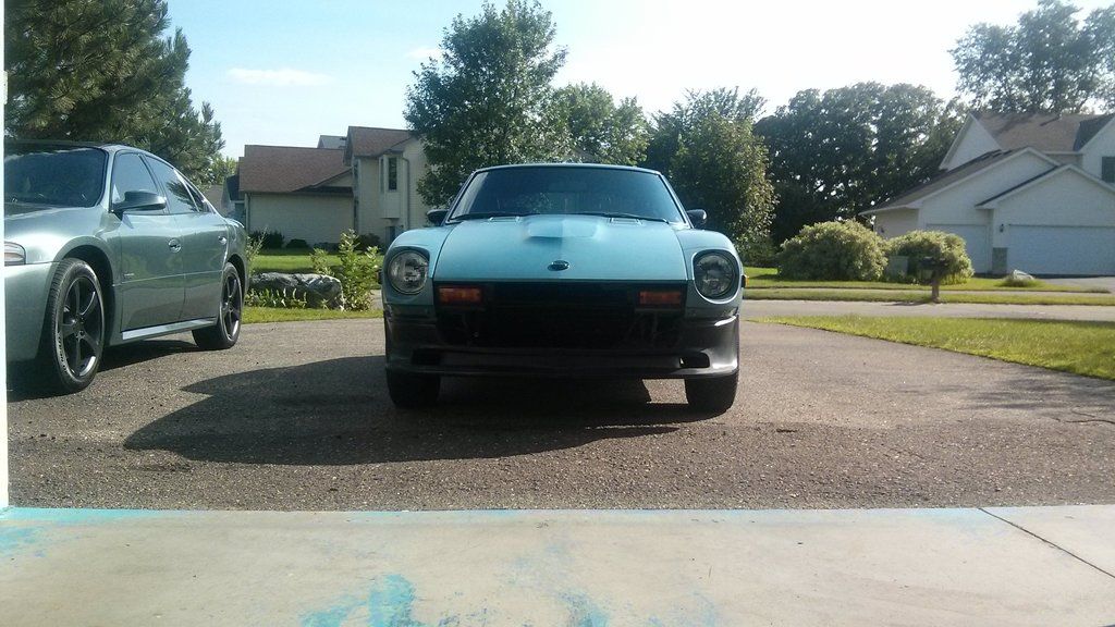

After the 4th of July I finally got my urethane front air dam and BRE type carbon fiber spoiler from the Z store.  The air dam fit really well and I ended up using larger stock bumper bolts than the small bolts and nuts provided.  The spoiler was damaged during shipping and the clear coat was not very shiny.  I ended up having to pay for shipping back but the replacement was definitely better.

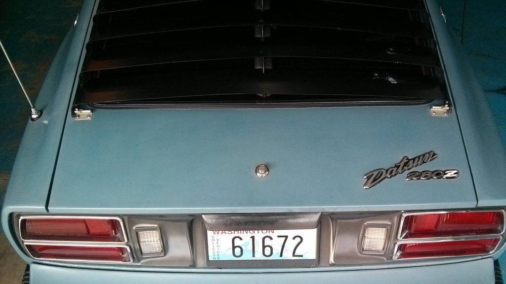

Here are some more pictures of the lens and LED install from Klearz.  All it took was a good heat gun to loosen the glue and they popped off with a screw driver.
Since it was all apart I hate the chrome bezels around the taillights, so I plastidipped those and also spray painted the license plate holder flat black.
Here is the end result with the new LED's.  I forgot to purchase the reverse light lenses so those are coming too.  The upper and lower lenses were smoked a little bit lighter/darker than each other so Tina will be sending me a replacement set to replace them.

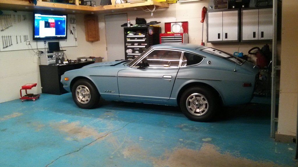

Now on to the real meat and potatoes of the project....I started to pull the motor out this last weekend to clear up some room.  Disconnecting everything was pretty straight forward.
I pulled the stock exhaust too, and will use the piping for practice welds as its been MANY years since I have welded.  The F%*king manifold bolts were a pain in the ass.  The first one snapped so I said screw it and chopped it off to save time.
