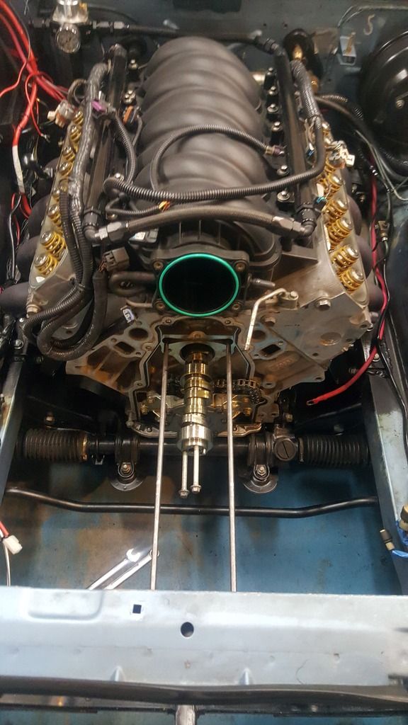

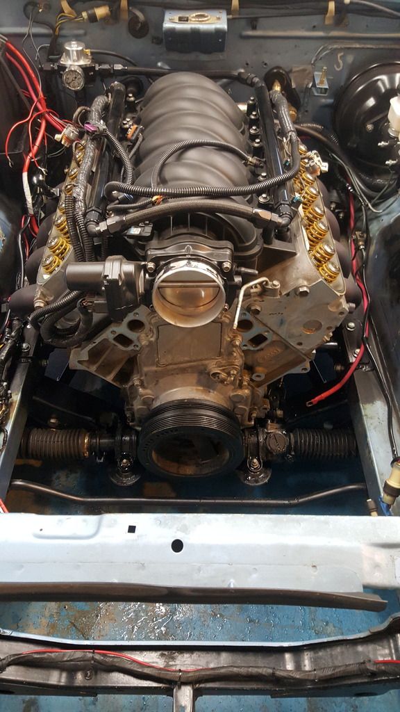

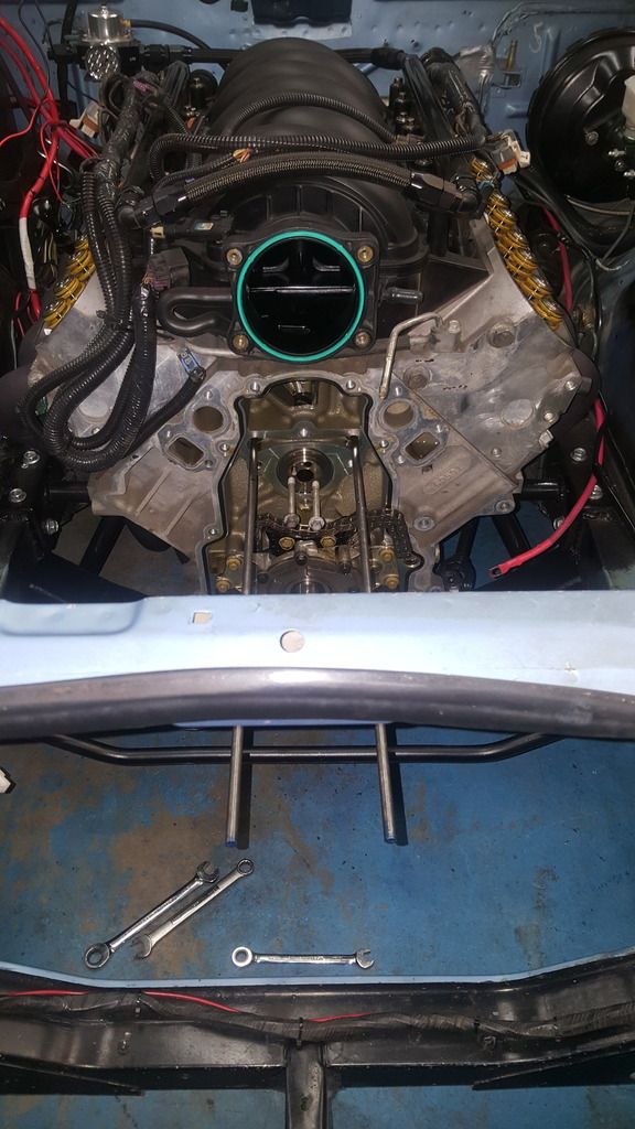

I feel like getting out today so I will probably keep my post a little short.  I decided to swap the cam and what not prior to Saturday.  Thursday night I was able to strip the block down fairly fast to get it ready for Friday night.  This stuff is pretty straight forward.

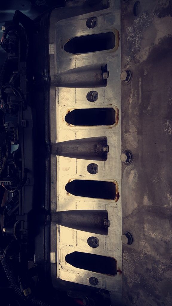

This is where I got after unplugging the plugs, disconnecting the coil packs and unbolting them, and then pulling the valve covers off.
The rockers were unbolted and the rocker guides and pushrods were pulled.
Snapchat-3478609846447273289_zpsjoouifzp

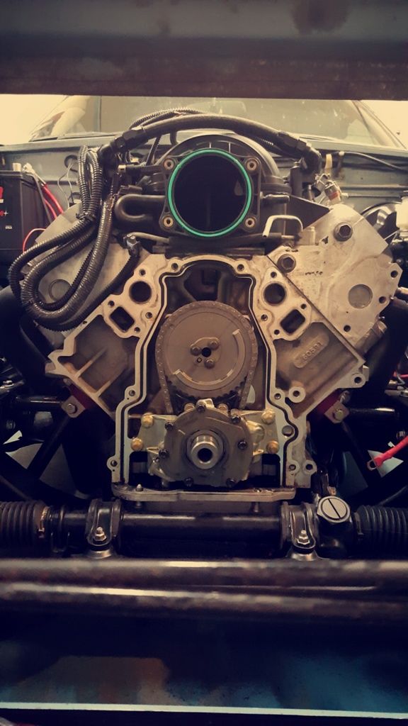

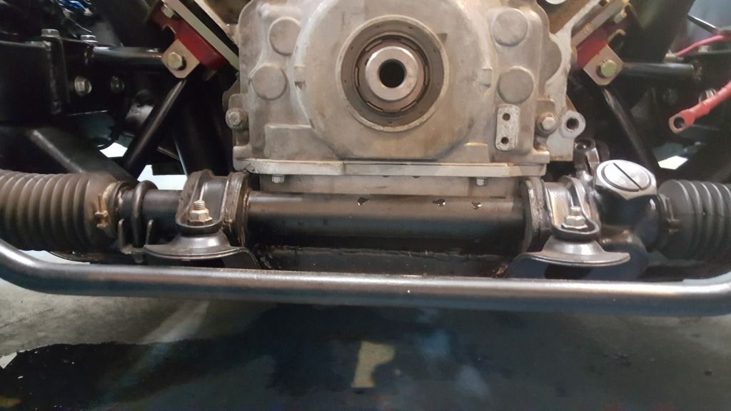

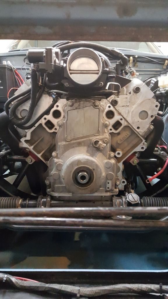

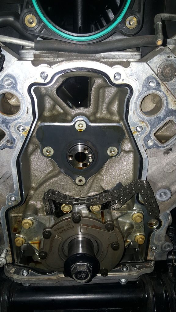

When I got to this point, I knew the bottom two timing chain cover bolts were going to be a BITCH.  I was thinking I was going to have to move the steering rack or drop the suspension...I removed the alternator and bracket as this was easy to remove.
The crank bolt was really hard to break loose.  Having the car in 6th gear and the parking brake on, the car still moved.  I had to put blocks in from of the wheels to get it loose.  The crank pulley can be pulled using a remover and the stock bolt but this is risky.  The bolt is barely long enough to use.  Just go buy the damper removal tool from the LS1TECH!  It is worth the money to do things right...
Here you can see how there is no room at all.

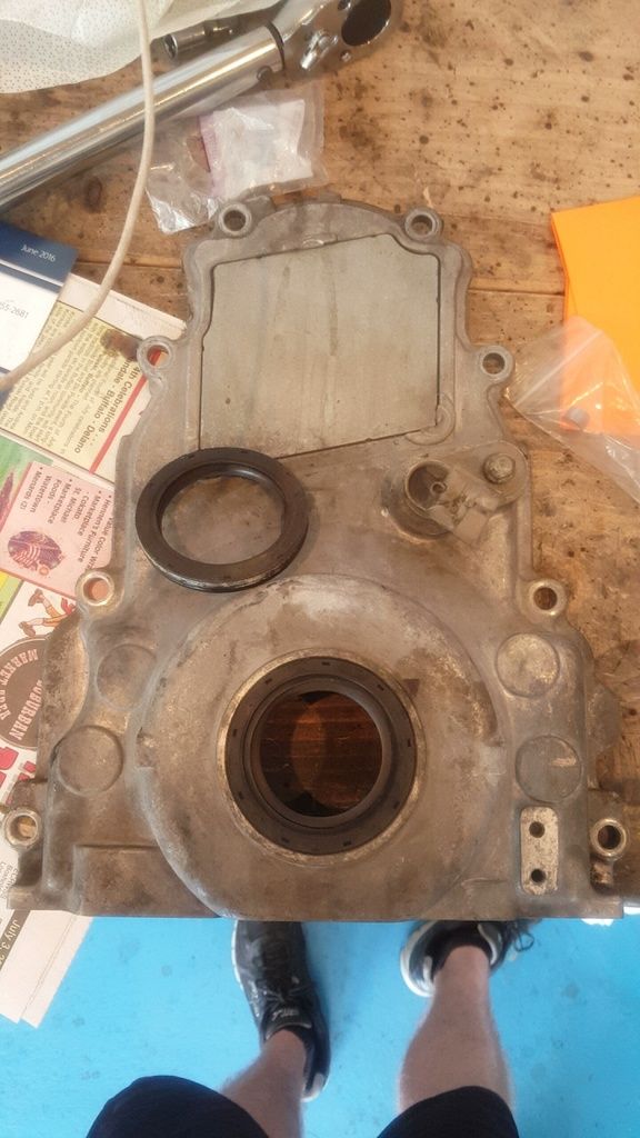

I removed the other 8 bolts from the cover, and then loosened the bottom two and slowly moved the cover up to get them fully unbolted.  I couldn't unthread them with the cover in place.  The steering rack was just that close with the Hawk's kit...
Snapchat-8226948432537019558_zps4kk7yv4j

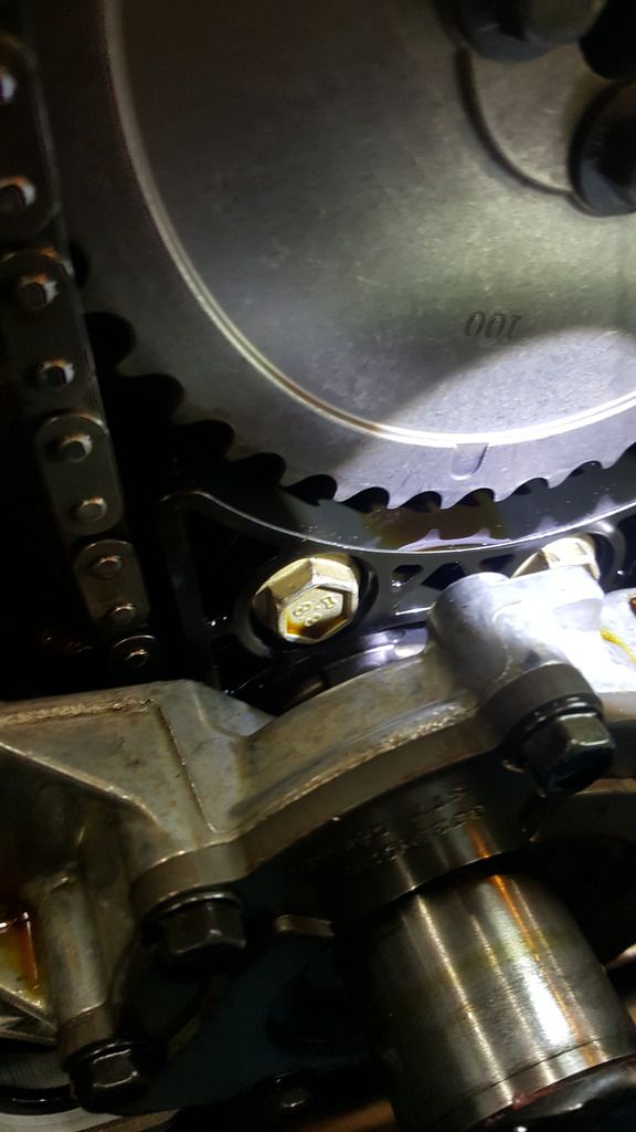

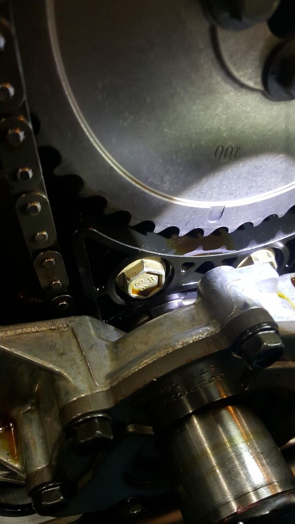

The LS2 has a timing chain guide that makes it a little difficult to see where the timing dots are.  If you shine a light in from the side and look from the top you can spot it.  These NEED to be lined up prior to unbolting the cam gear.  I have a video posted in my photobucket for anyone that is interested.
After the gear is removed there are some star head bolts that need to be removed.  I think LS1's have metric bolts but luckily I had the bit for this.
After that, throw some water pump bolt in and spin/flick the cam a couple rotations to get the lifters to stick up.  For the most place they should hold in place.  BEFORE MOVING THE CAM, make sure to get either the lifter holder tool or go pick up some 5/16" steel rod from Menards.  I took mine and rounded the edges so if there were any finicky lifters it would be able to slide underneath it.  These went in with EASE.  Save yourself the tool money and just spend $4 for rods...
Now is the time that you can slide the cam out.  The first 25% is the toughest because you have to support the weight of the cam as you pull it out.  Just go slow.  In the end the removal and install of the cam is the easiest portion of this whole swap.  I just used fresh motor oil to lube the cam, no assembly lube.
After the cam is slide in, put the retainer plate back on and use Loctite on the bolts.  Then put the cam gear back on with the dots lined up and getting the chain oriented right to bolt to the cam.  This part is kind of tricky as you have to move it tooth by tooth if it doesn't line up, however I got it the first shot :)  Use loctite on these bolts as well.

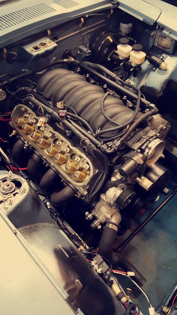

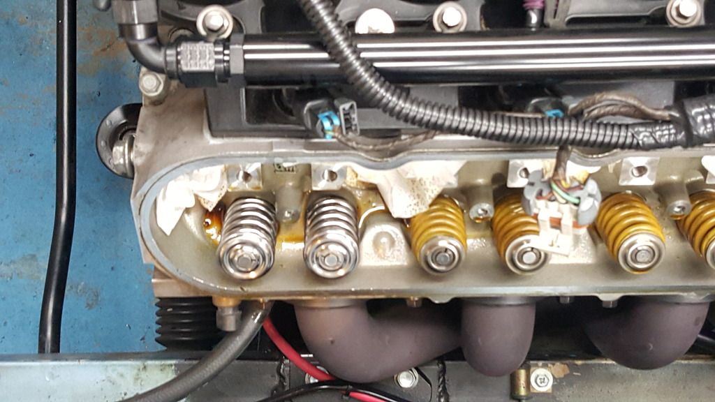

Next up was the spring swap.  I got the Crane cams tool and I personally would recommend it.  I used antiseize on the bolts and this thing never locked up on me.  I replaced the springs, seats, retainres, and the keepers.  I was not going to change a valve dropping in the cylinder so I used the top dead center trick along with a compressed air fitting from a leakdown testing kit.  Thanks to my sister-in-law Sophie for her sweet ass Snap-On tools!
With the cam dots lined up, the motor is at top dead center for #1 and #6.  These exhaust and intake valves can be worked on.  Put the car in gear when you compress the cylinder.  My car would roll forward as soon as I would hook up the air line at 80 psi.

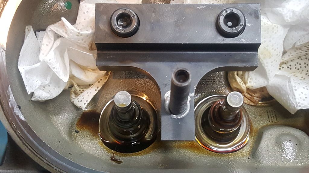

The best method I found to get the keepers out, was to compress the springs until you hear the valves open.  I then cranked the ratchet about 6-8 more times.  My air compressor is small so it turns on to try to keep up at this point.  I then took a rubber mallet and tapped on the valves until they popped up and freed up the keepers.  I used a pen magnet to get all 4 out.  Use rags to plug any holes so they don't fall in the block!!!
After #1 and #6 are done, it is rinse and repeat.  Turn the crank 90 deg. clockwise and work on #5 and #8.  Turn the crank another 90 deg. and work on #4 and #7.  Turn it another 90 deg. and work on #2 and #3.  After this, the motor is pretty much ready to go back together in the reverse order.

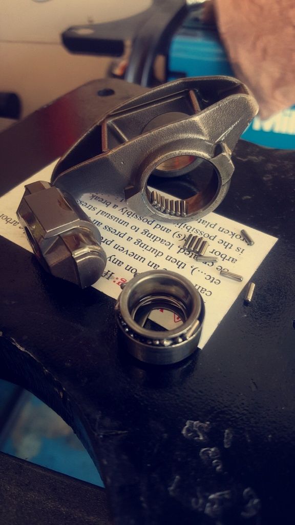

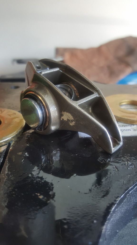

I decided to rebuild my rockers with a trunion upgrade.  I went with the new bushing trunion kit after reading about comp cam trunion kits have some nasty premature wear on the trunion.  Those kits are really noisy to begin with as well.
After seeing the needle bearings, I am glad I am getting rid of these...
Snapchat-9099363757639668494_zpsfjlzrlaa
Snapchat-3751739308453709422_zpskljijbxx

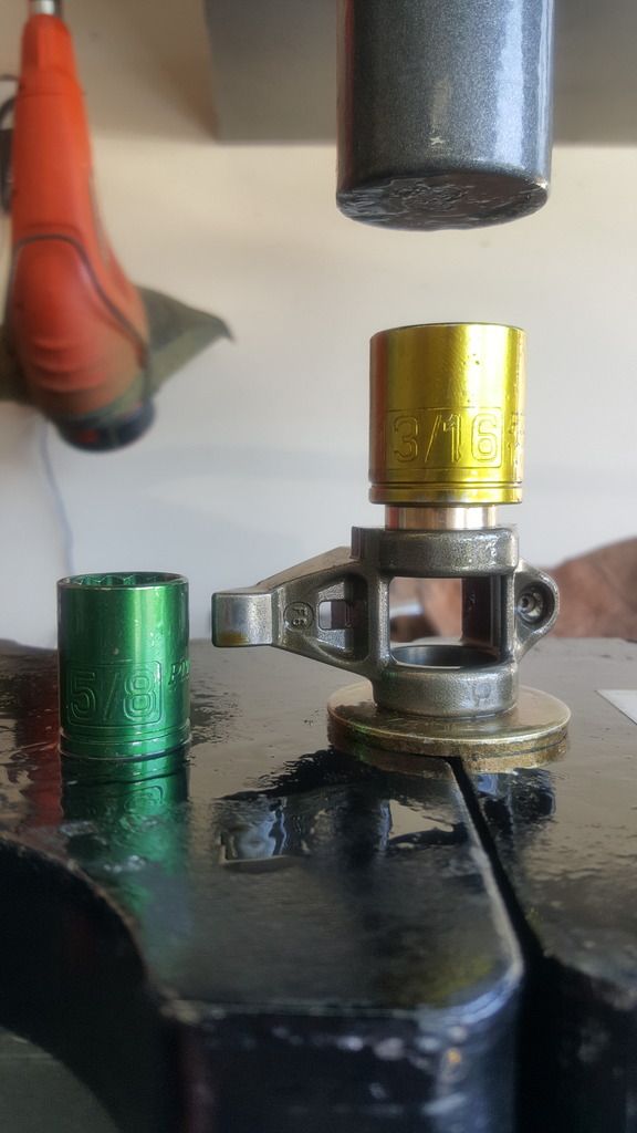

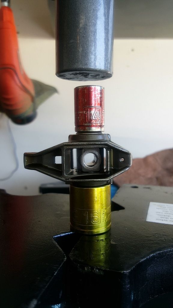

I used a 14mm and 13-16" sockets to press the center sections out.  They do make a bench vice tool which I didn't know until someone on the LS1Tech site told me about it.  I do have a press so I didn't need it.
Snapchat-7681295503917074487_zpslrnrpwfq
I used a 5/8" and 13/16" sockets for the install.  I did grab 2 thick hardened washers (5/8" Grade 8) from Menards as well.  These worked great at giving the trunion room so you can press the brass insert in flush.
All of these parts were sitting in motor oil prior to pressing in.  Now after my first rocker, I noticed that there was still some side to side play even with the fittings pressed in flush.  I took the 5/8" socket and pressed each side in a little more to get then almost to the point of snug.  I made sure each rocker spun absolutely free with no resistance.
After that, the 32 snap rings were thrown on to retain the piece together.  I like the way this kit looks!  Let's hope these have a good lifespan.
I pounded out the old crank seal with a punch and hammer.  The new one was seated in with a block of wood.

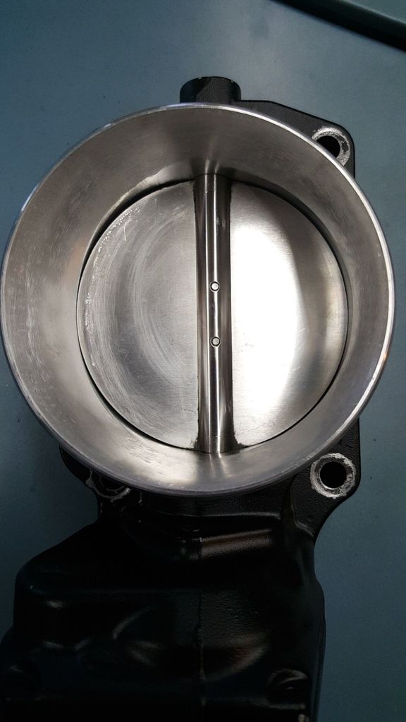

I did take the throttle body off yesterday after the show and shave down the two lips in front of the blades.  I have yet to polish this.

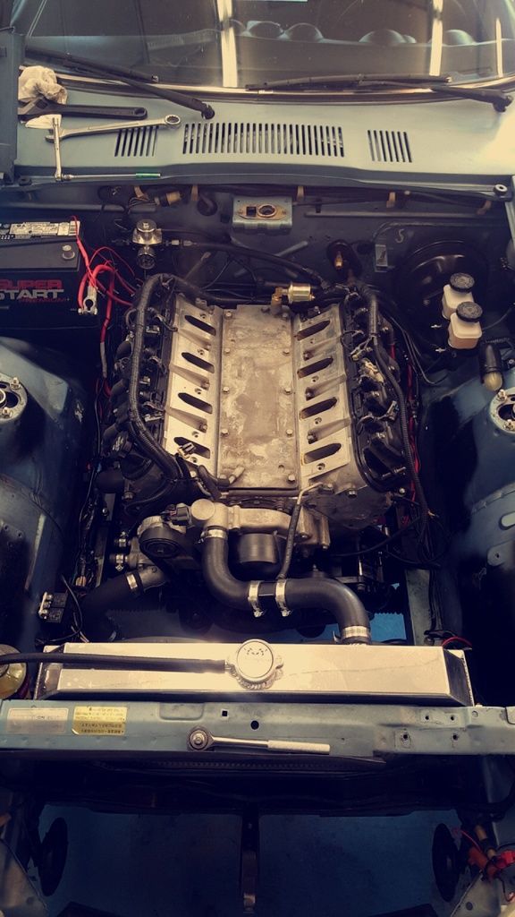

Well the weekend, bachelor party fun, and the dyno are really sneaking up on me fast and I am shaking like a leaf to get this all done before Monday.
I did end up pulling off the intake a couple nights ago.
Snapchat-7910016674188644544_zpshh8okmev
I was shocked at how much oil was blown up through the intake just after 2,000 miles.  I had cleaned everything up really well when I installed the new fuel rails.
Snapchat-1576625818956057947_zpsv7hikq1z
This is probably due to me refusing to allow any crankcase ventilation.  The Mightymouse catch can will be going on tonight to eliminate this.
I will have to say the LS2 intake is a POS.  The porting is really jagged and not uniform from port to port.  Also that sonic welding they use doesn't "weld" very well as I could tell on some edges.  What I did was take out the ports to about 1.050" from 0.950" I believe.  The majority of the work was done to level out the ports for better flow and do my best job to port match each cylinder.
There was a rough lip on the inside of the TB side that was cleaned up as well.  Then there is a large bump on the intake runner #1 that restricts the flow past that opening lip.  All of this was shaved down as well.  I used 60 grit for the rough cuts.  Then followed with 220 sandpaper and 360 grit red scotch brite.
On top of all of this, I finished my port and polishing of the throttle body.  I was only able to get everything bolted up last night before it got too late.
Snapchat-1233971748736610241_zpsa1bvxeju
The shipment from silicone intakes made it yesterday too so I should be able to reroute my air intake and filter.
Friday night I was able to finish the intake routing and installing the catch can.  My IAT's are down from 120-140 deg. to now around 80-90 deg. depending on the temperature for the day.  I'll take this as a win.
