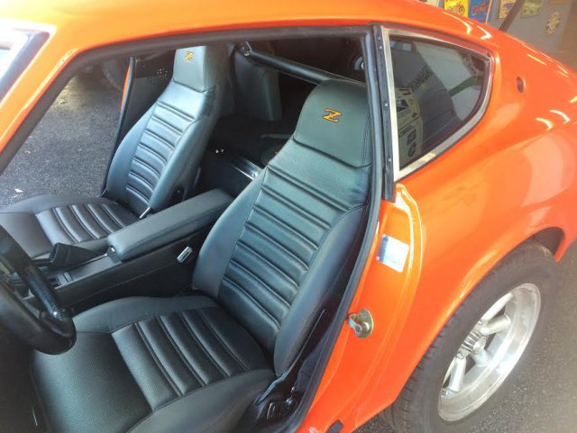

I think it all depends on what kind of driving you'll be doing in your Z and how much you want to stick to an OEM look. For true ergos and support your stock seats are definitely not the ticket but for cruising they are fine with new foam inserts. I bought the new foam from MSA and had my upholsterer manufacture new covers that were similar to the original 280Z seats. I'm very happy with the results. They almost look stock and are much more ergonomic and comfortable than the originals. Definitely not cheap though.

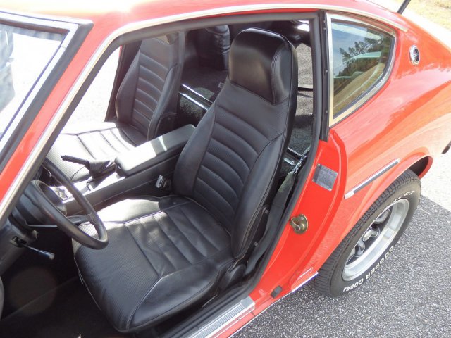

Original seats:
New custom seat covers with MSA foam:

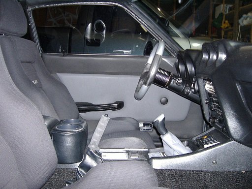

Aftermarket seats for the 260/280 are a pain in the ass. Make sure when you get suggestions from other Z owners, that they've gone through it in a later year car with the trans tunnel hump. The passenger side is easy enough, but drivers side requires work. At minimum you'll need to bash in (ugly and cheap) the tunnel in order to center the driver seat properly. To do it nicely would require cutting and welding, and all the associated prep and finishing work!
From there, you also have to make sure the seat is narrow enough to fit properly, and forget about wide shoulder bolsters. Just a warning.
