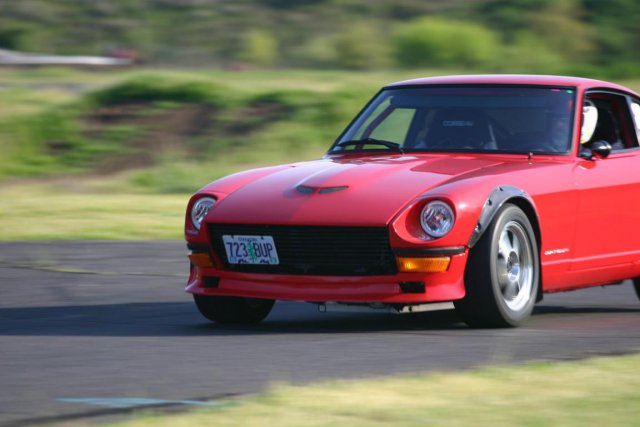

A friend of mine had and LS with the JCI kit and we built a brace that turned the standard crossmember into a k-member.  This was made from 1 inch 0.095 square tube and had 14 gauge sheet metal welded
to it forming a skid plate for the pan.  On more than one occasion it took a hit big enough that would have probably cracked or damaged the pan enough to ruin a weekend of racing.  If you look closely on the attached picture you can see it.
