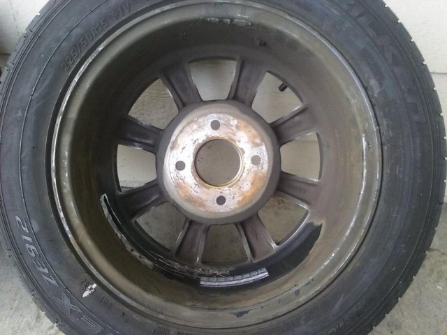

Wheel A has 19x7gram weights on the inside and 2x1.25(oz?) weights on the outside

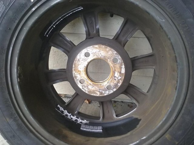

Wheel B has 8x7gram weights on the inside and 1x1.50(oz?) weight on the outside
This seems to have a large disparity, any comments welcome....
Wheel A
Wheel B
That is a ton of weight. The only time I've ever seen that many weights is when I lost a wheel and it scrapped a chunk out of my wheel. They had to balance that out. I'm also surprised they are using both sticky weights and rim weights.

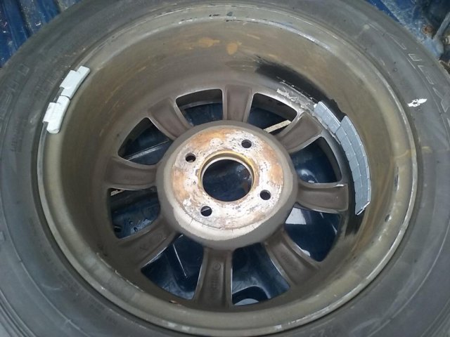

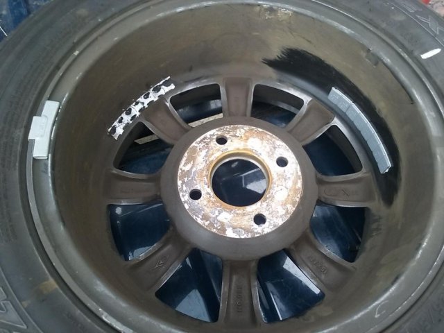

Update: I took the 2 front wheels to a shop and had the weights removed along with the tires for inspection and re-balance. NO problems were found....wheels were re-balanced. I did some research on Nissan spec lug nut torque. The information I found said from 58 to 72 ft lbs +/- 5 ft lbs. I re-torqued all 4 wheels to 72 ft lbs. I still have a slight shimmy in the steering wheel at all speeds over 30 mph..... My next step is to remove the front hubs and dis-assemble the rotors and have them inspected for warpage/run out. I might just tear the front suspension apart and check everything, just to be safe......
wheel A now re-balanced
Wheel B now re-balanced
