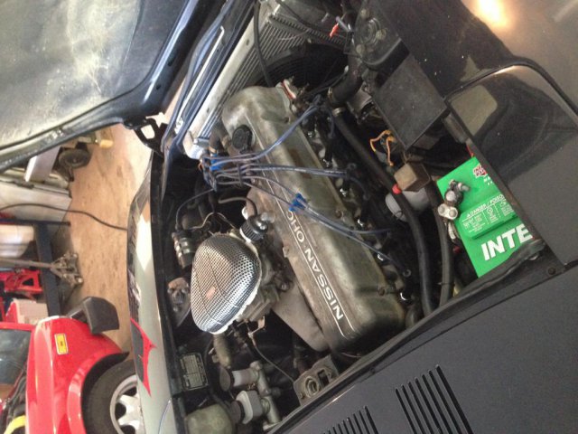

This is what it looked like under the hood the day i got her

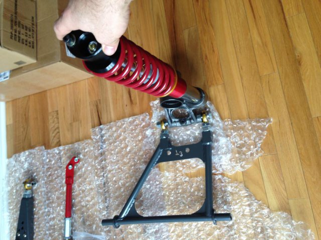

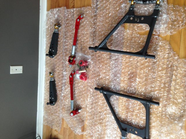

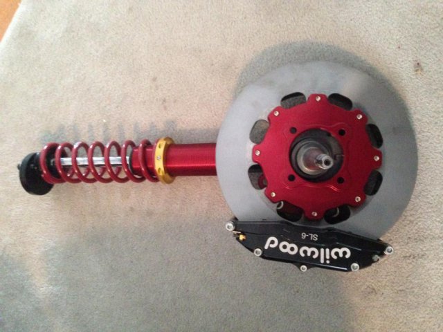

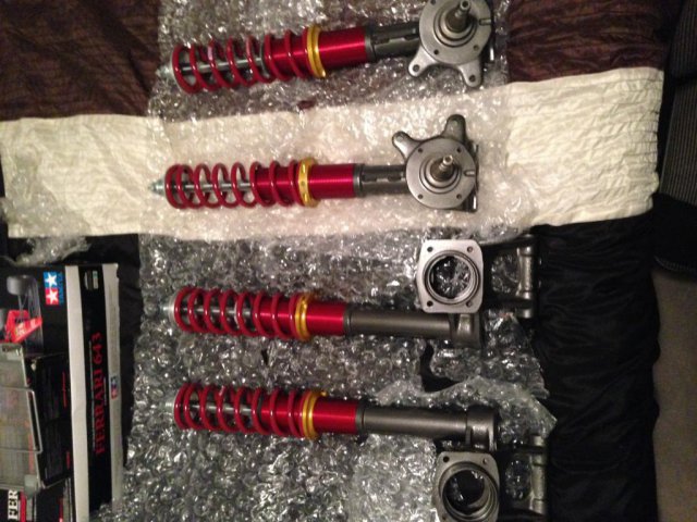

Ok now these are the parts i collected over that winter 2013/2014
I wanted to get started on the suspension, brakes, wheels and tires first.

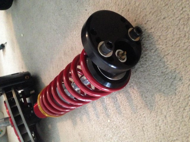

So i callled techno toy tuning up and bought his ready to bolt in coilovers, LCAs front and rear, RCAs, and tension control.
I then bought some outer tie rods from zccjdm, and some bolt in camber plates from DP racing.

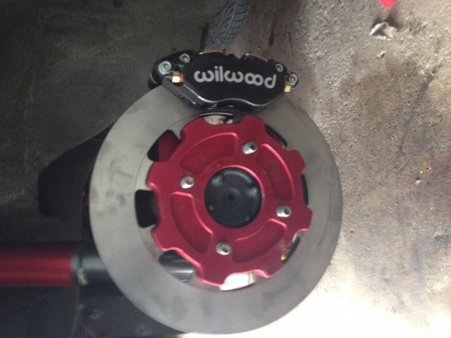

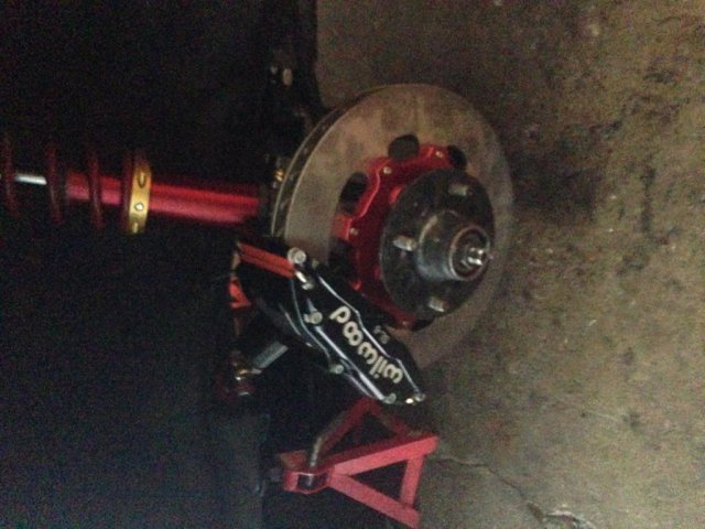

Then i called Dave at arizona Z car and bought his wilwood brake kit .....i went with 6 piston fronts and 4 piston rears.

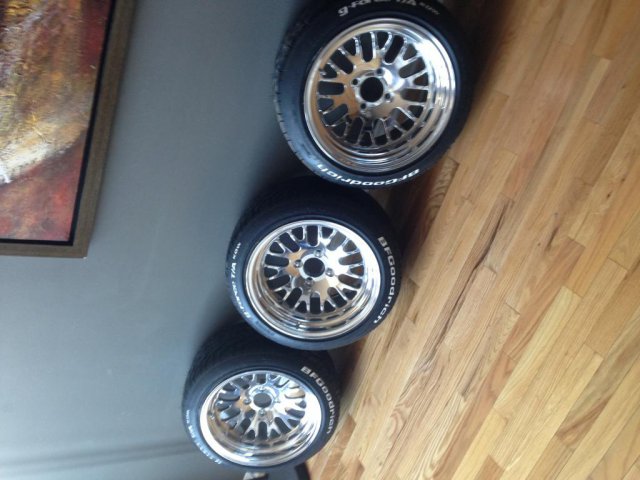

After that callled CCW and ordered some classics.

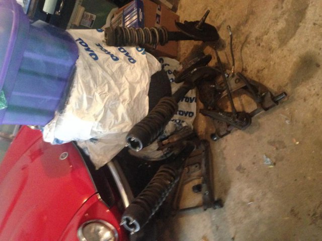

After all that suspension work it was time to throw the new rims on but before i did i had to make some room for the new rubber
so out came the handy fender roller
the fronts rolled like butter ...the rears took some manipulating and some heat lol ...but not long after and i got everything on there and was ready to start cruising .

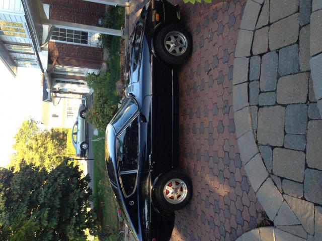

This is how she looked after all that work

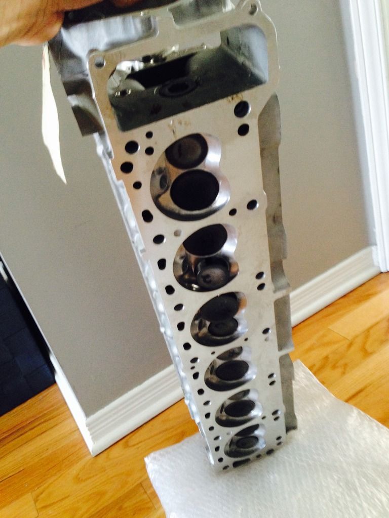

Over the winter of 14/15 i decided that it was time to put some thought into the interior and i kinda got side tracked and ordered a bunch of motor parts as i eventually would like to add an L28et to her and i started by buying a beautiful head from a member heer who bought it off another member here who got this head done at the masters shop himself Paul "BRAAP" Ruschman from rusch motorsports ...not sure if hes still around i was able to chat with him a bit on another bmw forum.
So heres the beauty
but still a longtime to go before that gets installed...

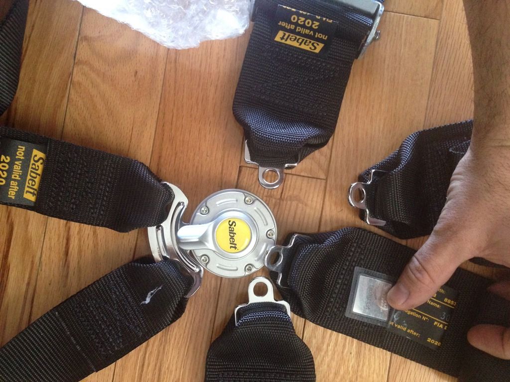

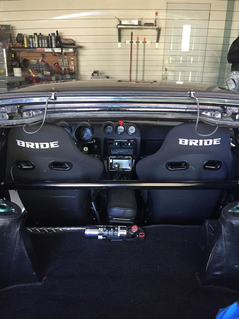

I ordered some bride vios 3 buckets with bride rails that fit right in and i also went with an autopower rollbar and some sabelt harnesses....this car will be mostly street driven so i have left the original seat belts in ...but have the harnesses for the odd day i take it to the track....and there easily removable so it worked out.

Heres the seats installed ....i also went ahead and added a Nardi wheel ...with a works bells quick release ...and some diamond plate floor plates.
Im really happy with these seats ...with the suspension upgrade and these seats holding me in place i feel like nobody can touch me in the corners now lol the seats holding you in perfectly almost make it feel like the car can take the turn at even a faster speed lol ...

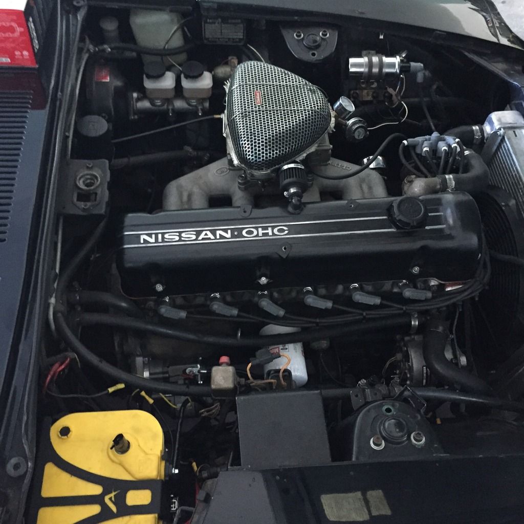

So 2015 was a fun summer for this car but there were a few problems ....the fusible links caused me a bit of headache but now i know to check them when you have an electrical problem ...im betting 50% of electrical issues on this car stem from those links burning out...but better then having a fire.
Cleaned up the engine bay a bit if you remeber the photo of when i first got the car and to this its a huge improvement aesthetically
and some more pics of the seats and roll bar
not keeping the dvd just was trying it out but rather fill that spot with gauges.

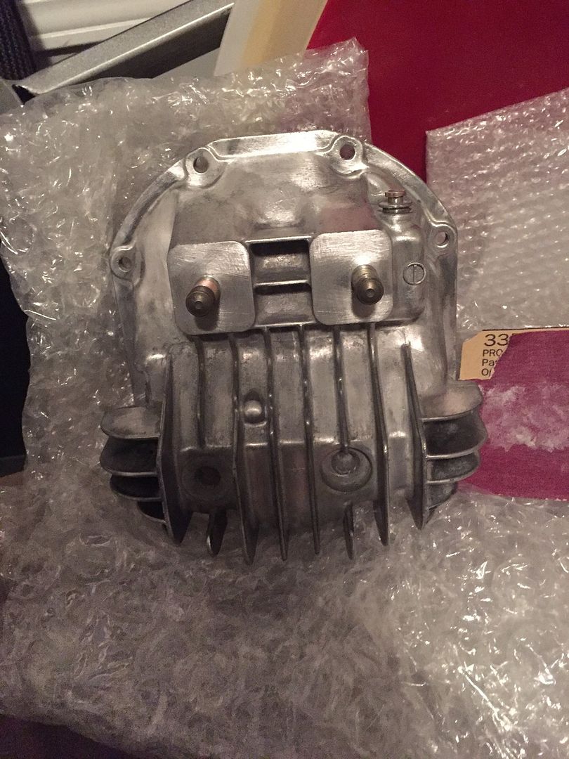

Ok so winter 15/16 is coming so i already ordered some parts because in spring 2016 i want to completly replace all the rear end drivetrain components and i started buy ordering a r200 longnose differetial
So thats the diff i am going to install for this summer ...eventually im gonna put in a os giken super loc but first gonna get this serviced and try her out.

Just got this in the mail the other day ...should finish off the diff nicely .

Yes i have harnesses ...6 pt Sabelts

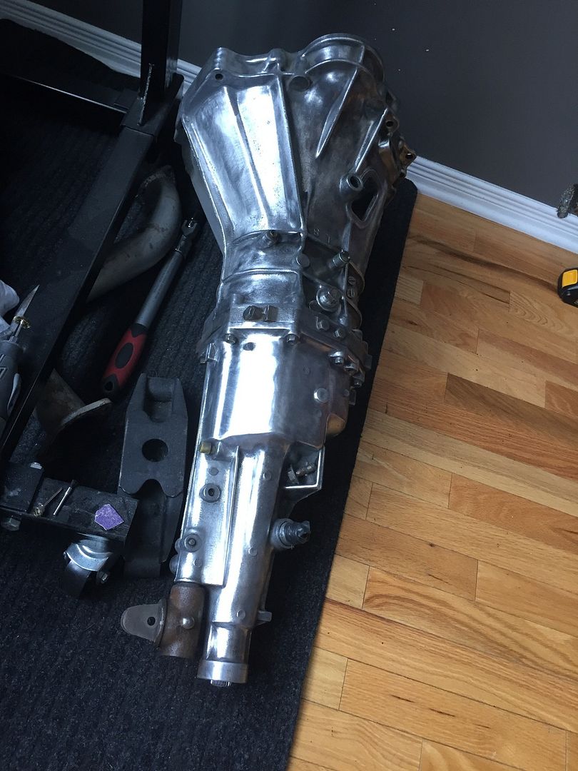

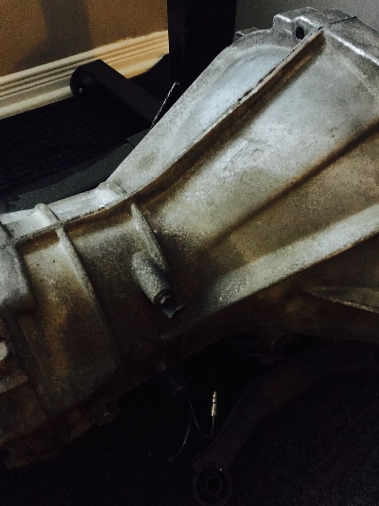

This weekend was a boring one ...so i decided to clean the case of the 5spd im gonna install come spring
Before:
And after a couple of hours ...its not finished yet ..but its coming along. Once its done im just going to leave it raw ...rather then paint it just so it can get dirty again.

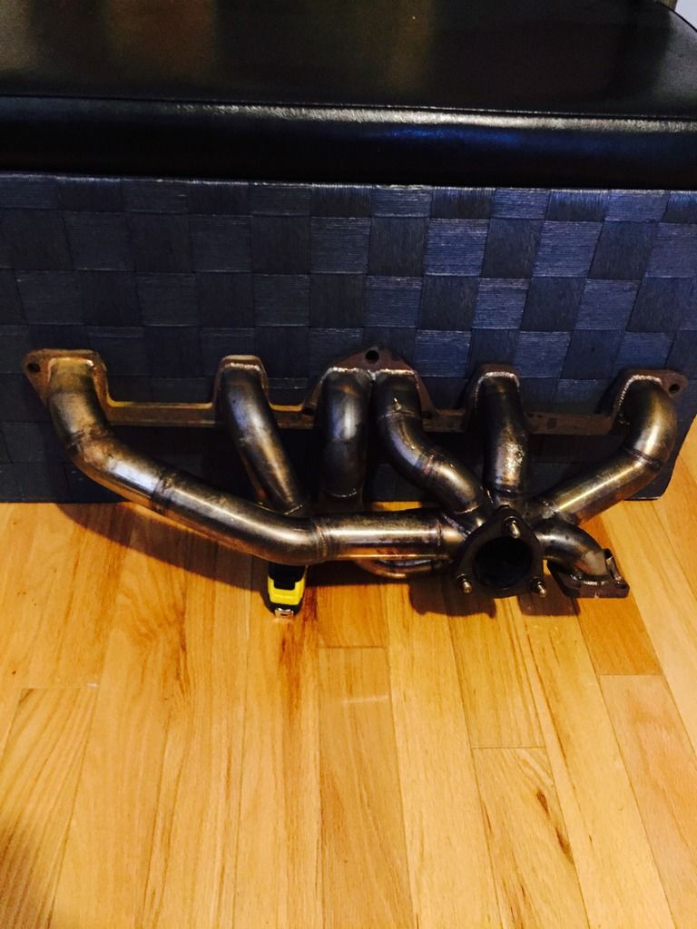

@softopz - I still haven't decided on what exact compression ratio I want to run with this turbo build yet ....the head I have is ready to go and just need to figure out what's the best combo for a 350-400hp street turbo L6 ...from what I read I can get it done pretty cheap but might want the nice forged goodies ...
As for the manifold ..I bought it with a turbo , down pipe , and a greddy wastegate for dirt cheap ...so even if it did hit the rack I could easily turn around and sell it for profit .
